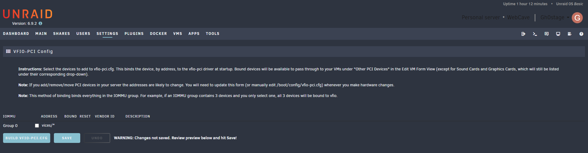

I've just found out that the problem seems to be my VFIO-PCI plugin, which doesn't show my devices at all anymore :/
Also, if it can be of any help, I have PCIe ACS override enabled, both multifunction and downstream, without it, I can't passthrough even half the devices I need. This has never been an issue before tho so I doubt this has to be changed.
Edited by Gh0stage
Edit: added screenshot of VFIO-PCI config plugin
Check bios settings especially vtx/vtd settings, maybe they resetted for whatever reason.
Edited by ghost82
Sorry, I had some things come up and had to table this issue. So what is very strange: I went into the BIOS, checked IOMMU and it was enabled.  When I finally got around to checking Unraid again, the information panel said it was disabled.  This was after several restarts and troubleshooting attempts.  I went back into the BIOS and sure enough, it was disabled.  I re-enabled it, and all was good.  I can't explain it... When I noticed the problem, one of the first things I came across was to check IOMMU, so I did.  The BIOS showed it was enabled.  Clearly there was some glitch/error as it turned itself off and as far as I can tell it did this while still running.  I leave the server and VM running 24/7.  I went to access the VM one day and found it not up.  I accessed Unraid and it showed the VM off and I was not able to start it, but Unraid showed uptime of 43 days.  I had accessed the VM in that time.  I really have no clue what happened.  All is good at the moment, but I will continue to monitor.  As @Gh0stage asked.  If there is a log file to check or post, I can certainly do so.  I couldn't seem to find anything relevant.
