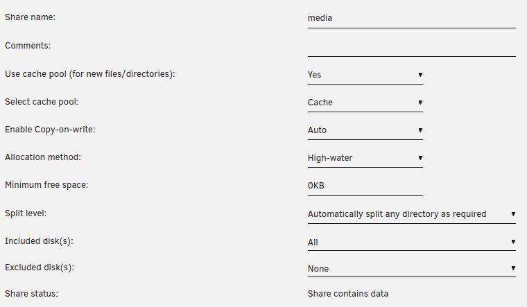

I have set up a share that uses an SSD as cache. However, something seems to be very wrong. My writing speed to /mnt/user/share are around 25-30 Megabyte/s, even though I'm having an SSD cache and the "Use Cache Pool" setting at "Yes".

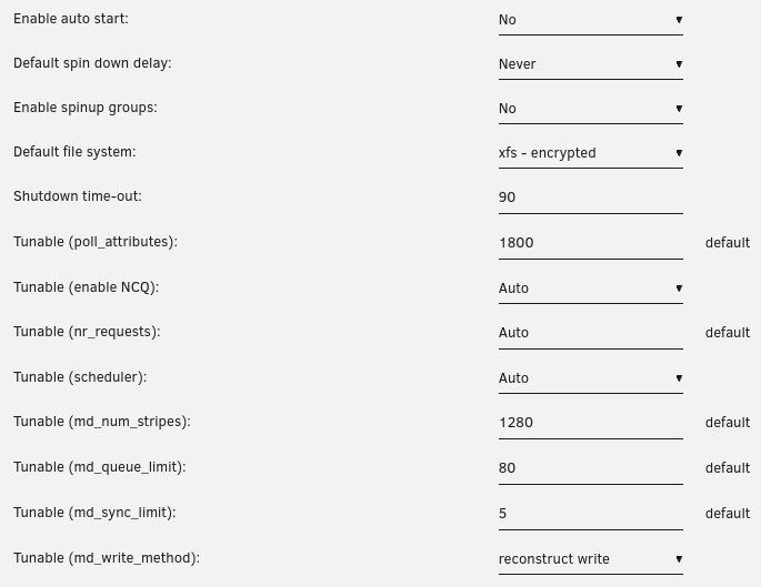

I tried to search and found out more people who seem to have had the same problem, but I couldn't find any solution. I've tried setting Tunable (md_write_method) to reconstruct write, but that doesn't affect speed. (I guess it shouldn't either, as the data is written to cache and the parity is not involved.)

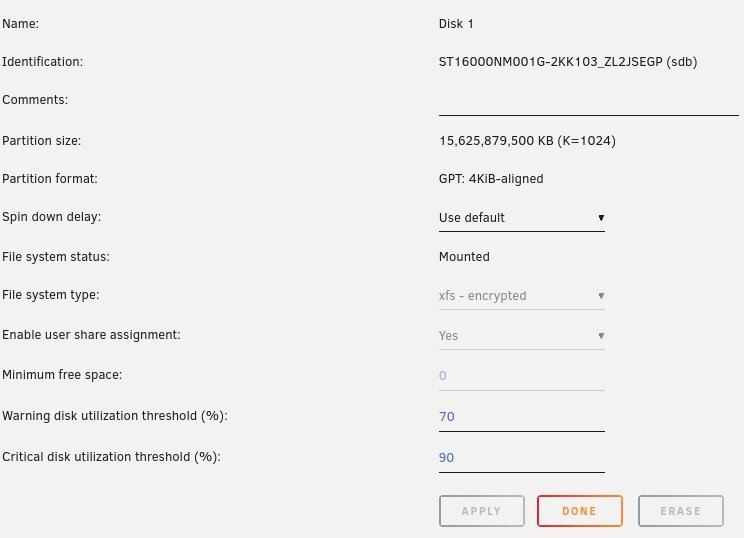

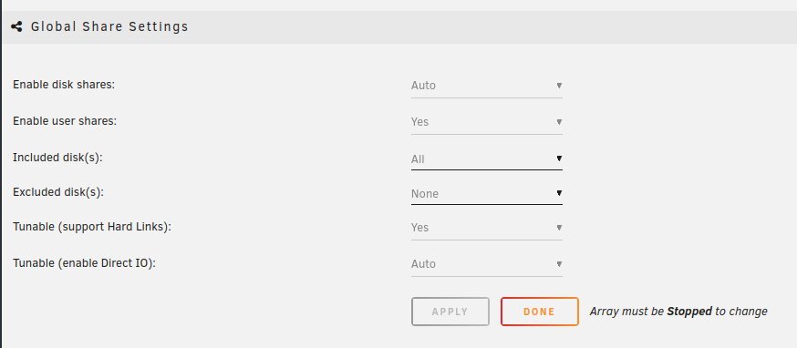

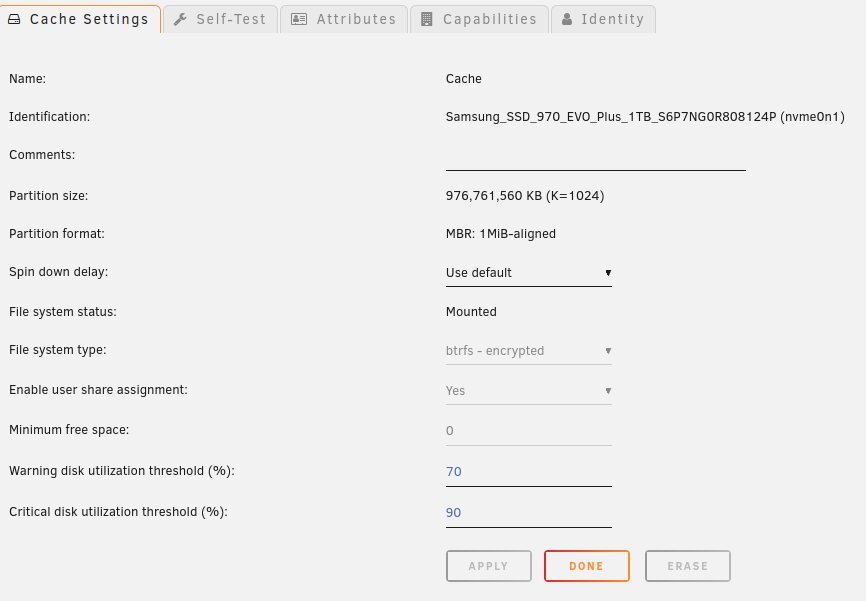

I've attached the diagnostics, collected after I ran the dd tests. No reboot. Below are some images of my settings.
Disk Settings:
Disk 1:
Cache:
Share settings:
Global Share Settings:

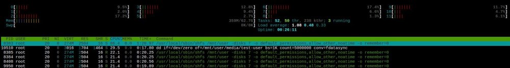

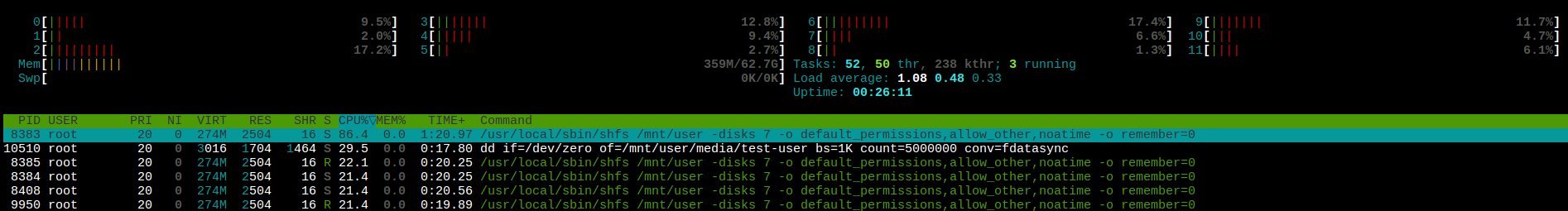

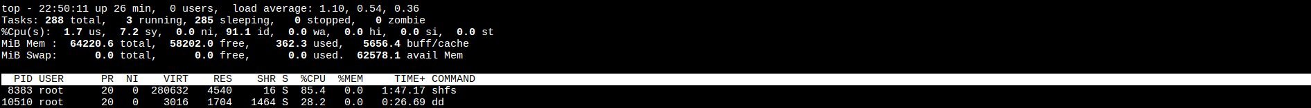

Some more information, it seems that the shfs process is taking some CPU when doing the dd tests, if that's of any interest.
Both these screenshots from when running dd to /mnt/user/.
