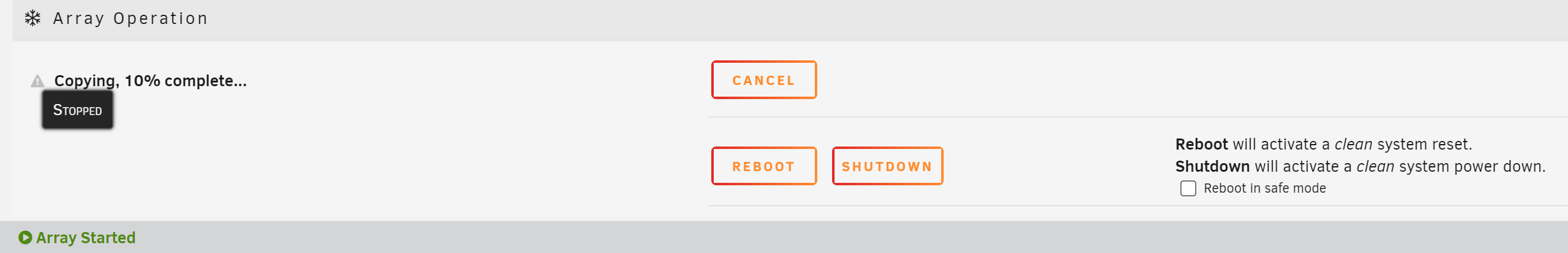

Hi folks! Based on what I've been reading, to only be 10% complete 24h in doesn't seem right. Any indication as to what might be awry based on the attached diagnostics?
Also, is it normal for the copying process to be stopped? I think it's going back and forth from being stopped to copying because the percentage is still progressing, albeit slowly.

During the parity swap procedure, does the array start and stop? In the picture above, the grey triangle is "STOPPED" but at the bottom, it says "Array Started."
Array is stopped during the copy, can you post new diags just to check the array stats? The ones from before are weird, though I never checked before during that, they might no work correctly.
