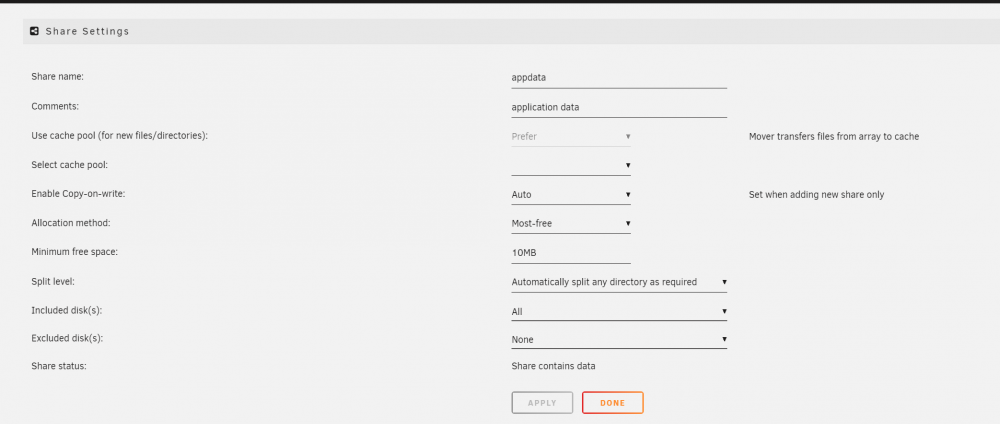

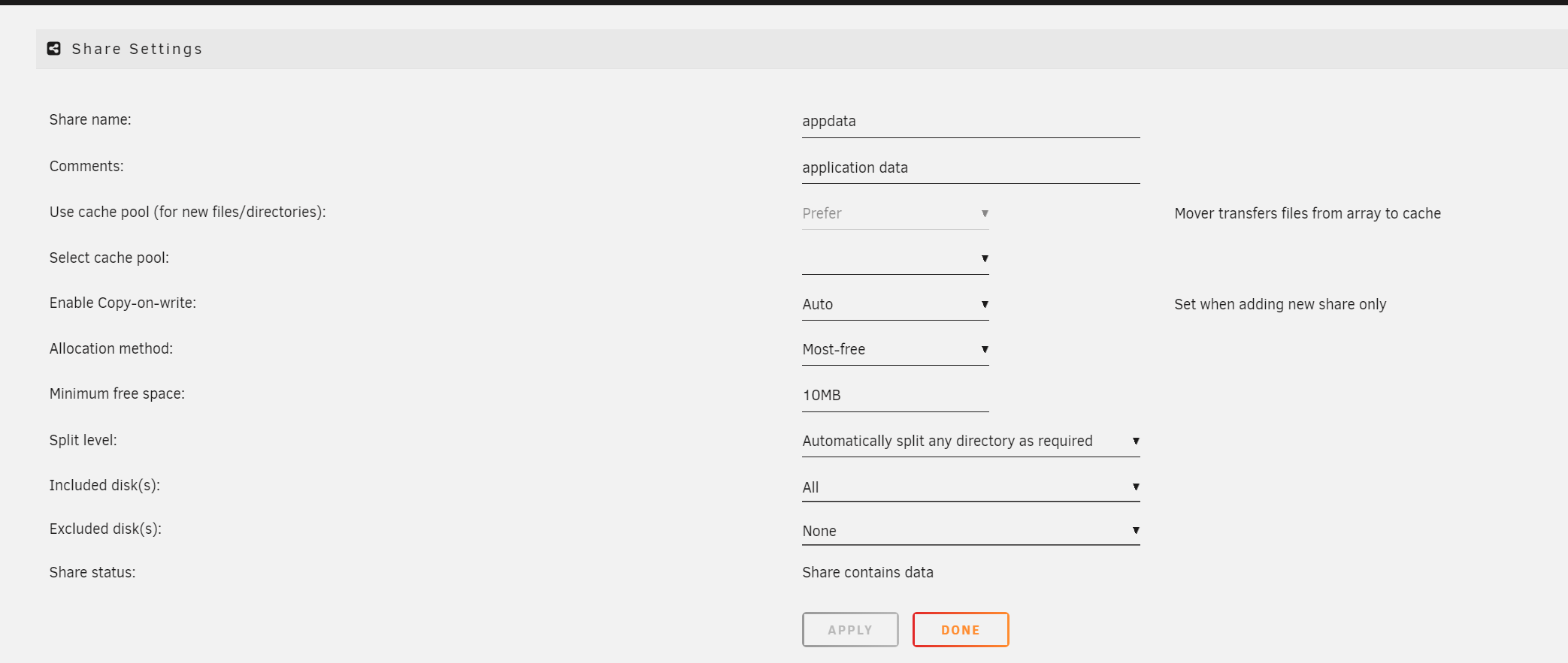

I suspect this is a simple mistake on my end. my docker containers have filled up disk 1 i guess... but the appdata folder is set to "most-free" on allocation and none of the other disks will pick up. what did I screw up?

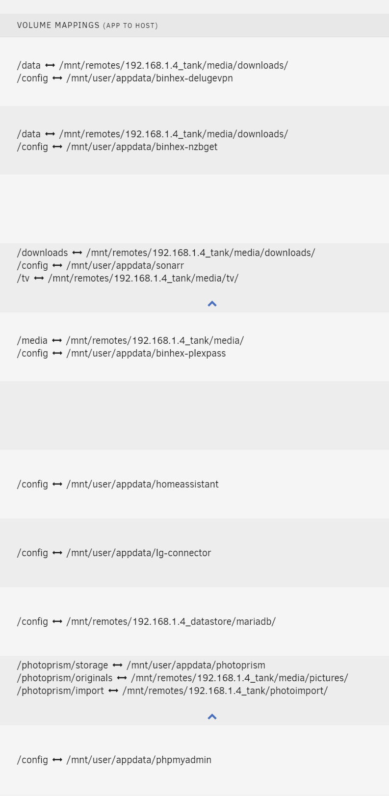

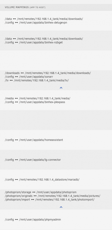

Do any of your docker containers refer to disk1 explicitly in their mappings?   It should always be to /mnt/user/appdata/
will double check, but I believe they do not explicitly connect to disk1
Verify your split level  for the share that won’t spill over.
ok, I think I found it. the afffected folder is in system:

and system's split level is "automatically split top level as required". I have changed it, is there a way to either:
