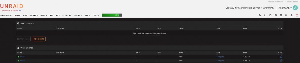

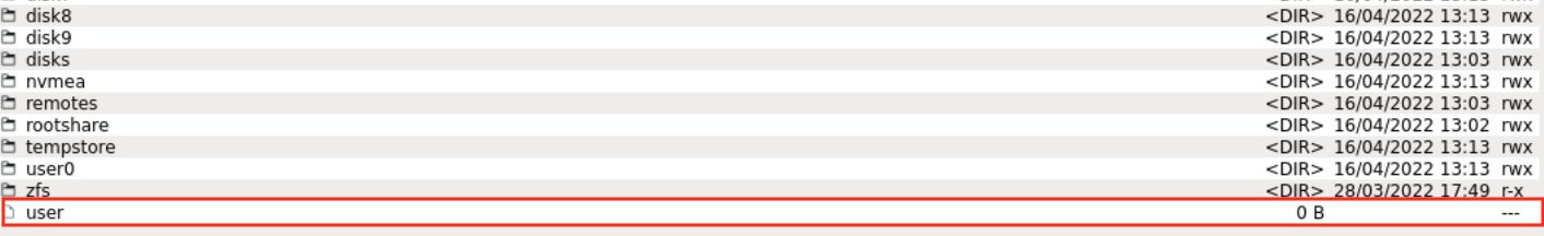

I was fooling around on my media share in a krusader container. I attempted a rename and the my shares were gone. Looks like something specific to "binhex-krusader". Any help fom those logs to confirm this?
mediaserver-diagnostics-20220405-1442.zip
I do see errors in the syslog. but I can't make heads or tails of it.

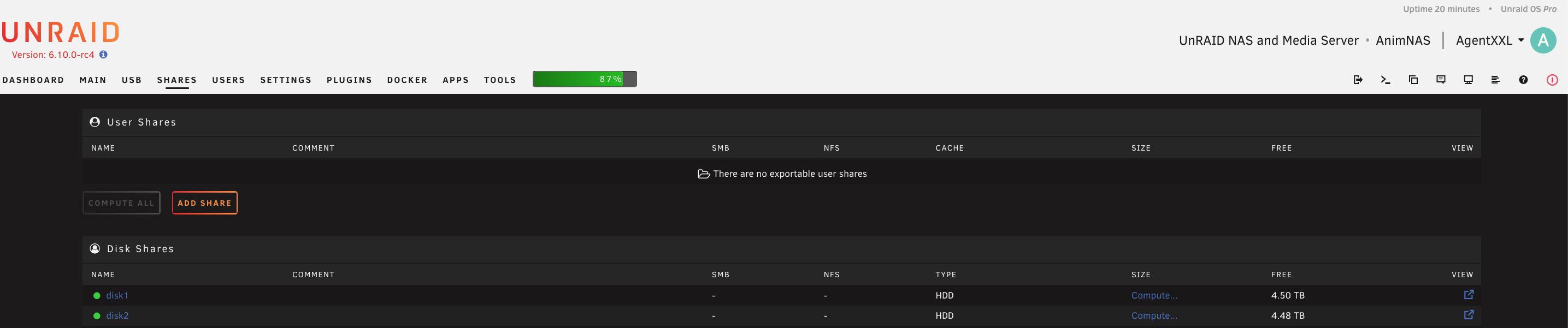

FYI - I have been seeing this issue (the disappearing user shares) since upgrading to 6.10 RC4. I am using NFS for my shares as the majority of my systems are Linux or Mac. Mac's in particular have speed issues with SMB shares, but NFS works great.
The gotcha is that I don't use tdarr... in fact I don't use any of the *arr apps. I've grabbed diagnostics just now as it just happened again. I will send them via PM if anyone else wants to look at them, but I prefer not posting them here. Although I use anonymize, going through the diagnostics reveal they still contain information that I consider private.
I'll be taking my own stab at the diagnostics shortly, but I've disabled hard links as suggested and will see if that helps.

added pics from Krusader and webgui
