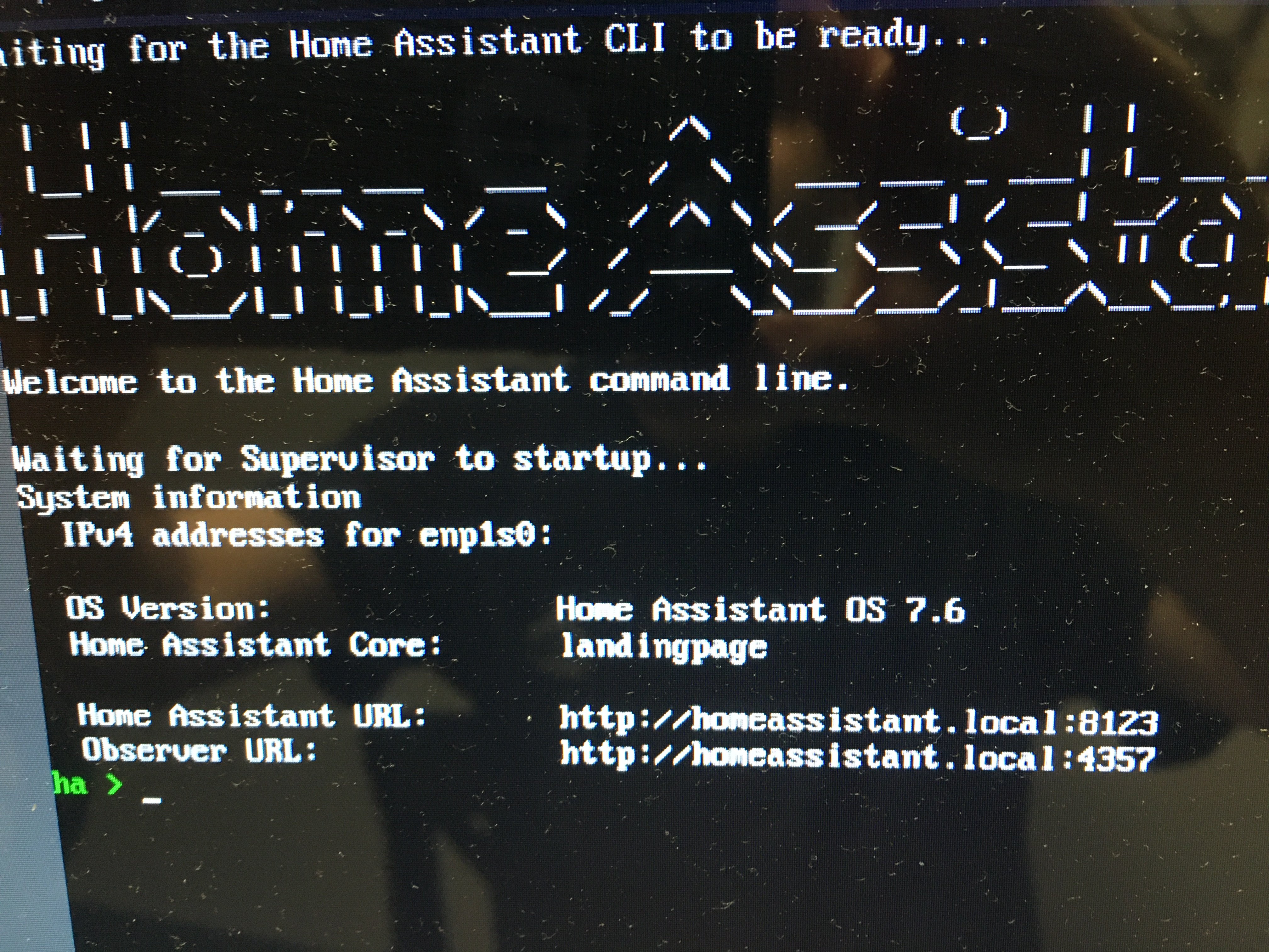

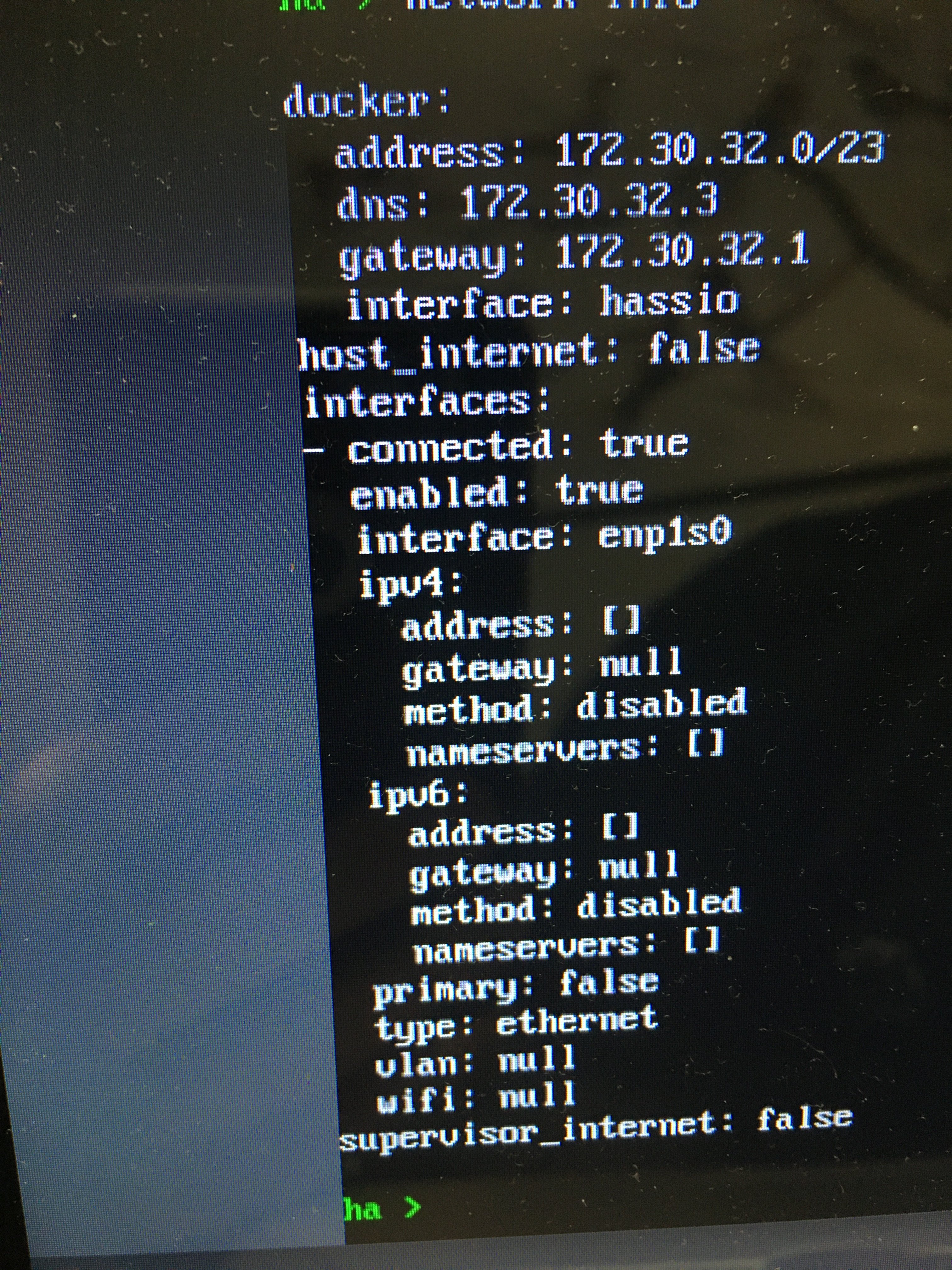

Setting use br0 then click VNC Remote and confirm IP allocate or not
image.thumb.jpg.dce9bb61954e193fbe7def3283a26ff7.jpgI do not get an IP at all. It’s just blank.

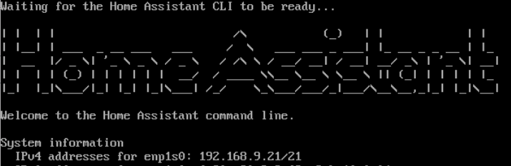

that’s my issue. I do not get one assigned when I select br0 but I get a 192.x.x.x if I select virtbr0

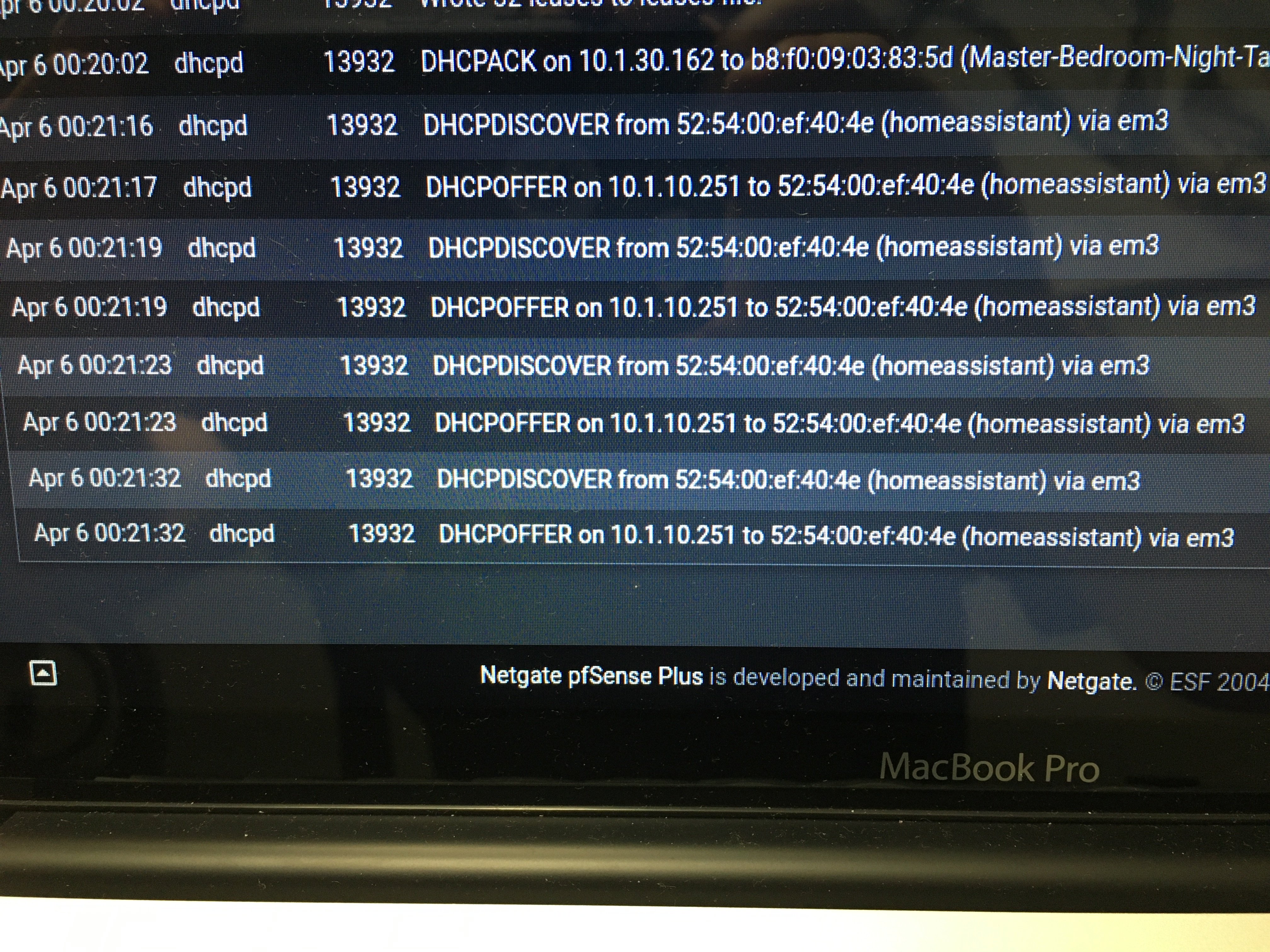

I can also confirm that with br0 the vm is being offered a dhcp address in pfsense.
You means pfsense assign 10.1.10.251  ( br0 ) to HA, but no IP show on HA VNC ?
Let me clarify. pfsense is trying to offer that option address. So it’s going though. It doesn’t show up as a leased IP address.
The VM hasn’t accepted it.

No much idea, but HA not ack the DHCP OFFER from to Pfsense, for example, 10.1.30.162 have ACK Pfsense.
BTW, it look like Pfsense can't transmit data to HA, but can receive HA's request, because Pfsense have receive 4 request from HA in short-time. It looklike Pfsense have one-way communication between HA.
