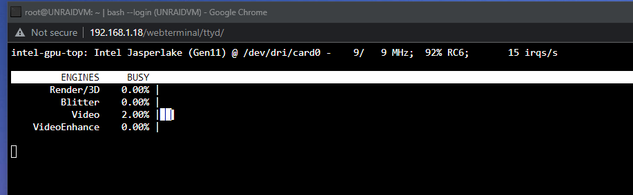

From what I know HW transcoding is working fine in my Jellyfin container with 11th Gen. Intel CPUs (just be sure to also try VAAPI if QuickSync isn't working for you).
On 4/8/2022 at 1:49 AM, ich777 said:
Keep in mind that GVT-g is only supported up to 10th Gen Intel CPUs, please see this post: Click

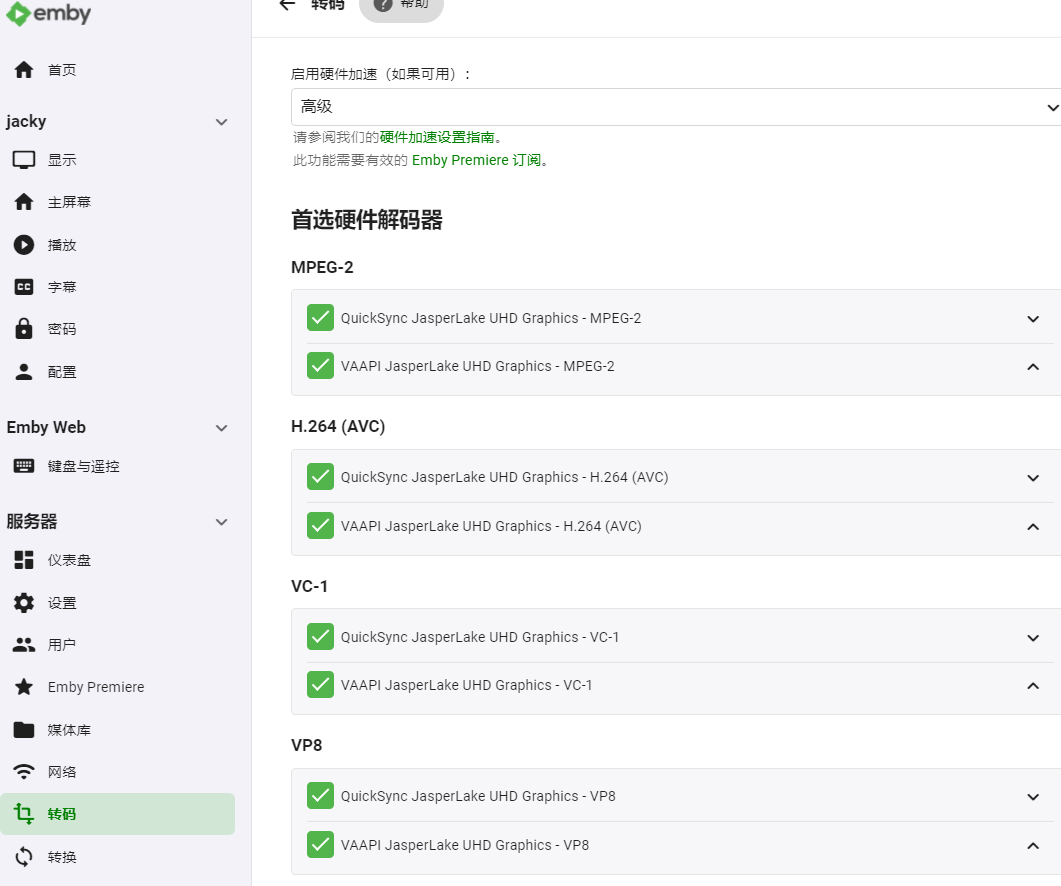

Hi @ich777 what is your unraid version? on 6.9.2 my N6005 HW transcoding well with both Plex and emby,when I upgrade to 6.10 (rc2,3,4),it just broken.I have tried many method,incloud ‘echo "blacklist i915" > /boot/config/modprobe.d/i915.conf’,'install Intel_gpu_top', 'options i915 force_probe=4e71 options i915 enable_guc=2',I can see /dev/dri shows card0 and renderD128,but all of these did not work. someone uses 11gen core cpu like 1135G7, 11500 can use HW transcoding without any code,but my 11gen Pentium CPU cant. is there any other steps for Jasper Laker ? sorry about my poor English.

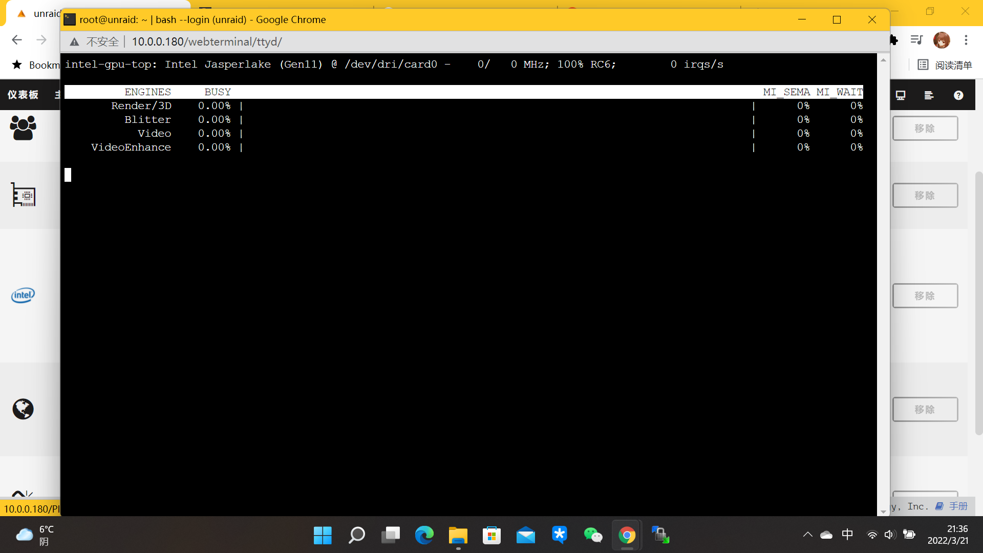

here is my Diagnostics
unraid-diagnostics-with blacklist i915 and intel_gpu_top.zip unraid-diagnostics-with force_probe=4e71 enable_guc=2 in boot config modprobe.di915.conf.zip unraid-diagnostics-without any config.zip
Please remove any option or better speaking force_probe, blacklist the i915 module, install only the Intel GPU TOP plugin, the plugin will handle everything for you including the force_probe and reboot.
Do you have a monitor connected to the iGPU? If not temporarily connect a monitor to it and try it again.

thanks for your help, now I have only Intel GPU TOP installed,but still not work. I will try connect my monitor later.

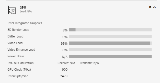

FYI: I have HW transcoding working on 6.9.2 by
vi /boot/config/modprobe.d/i915.conf
modprobe i915
if I only use intel_gpu_top,it wont have HW Transcoding.
