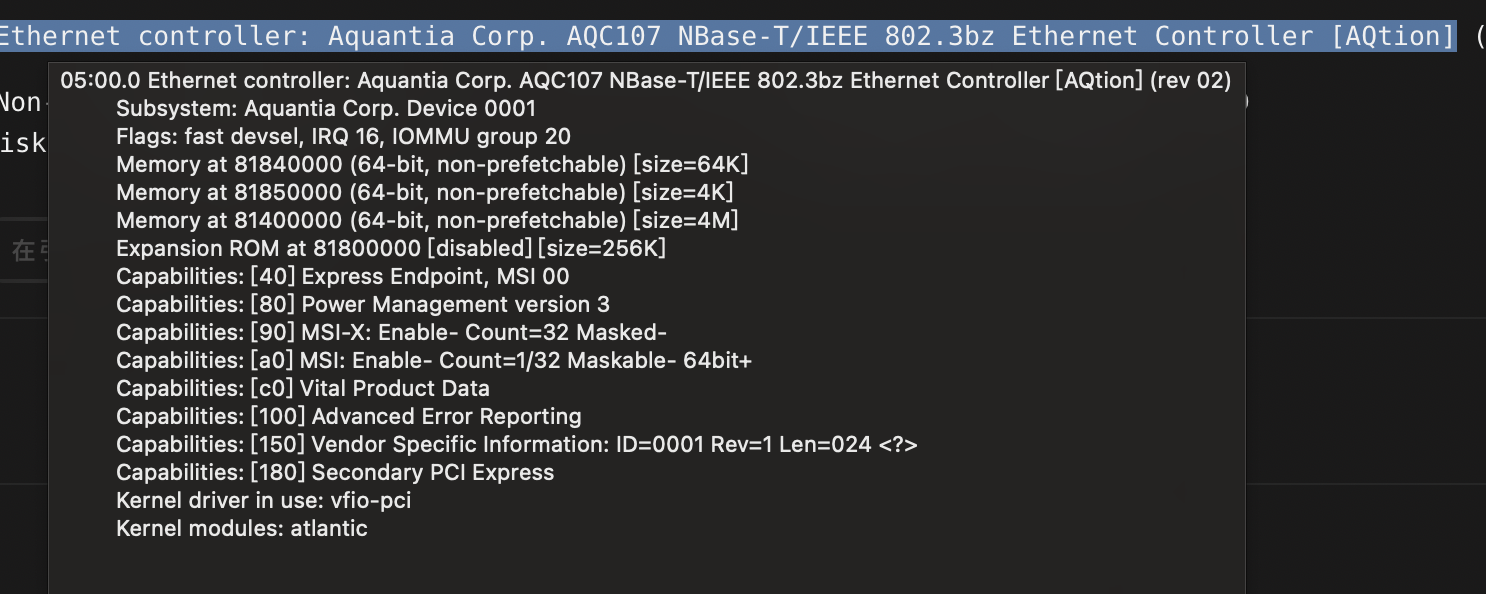

Here is the device information about this NIC.
NIC is supported, currently is being passed through to vfio-pci, so it can only be used by a VM.
Yes, I just want to be able to use this NIC in a VM, but no matter what I can't use it, as I mentioned above, truenas VM has no way to get the ip address, windows VM can see this NIC and I have installed the NIC drivers through a third party driver, but the network still says not connected, I'm pretty sure the network is connected. The lights on both the switch and the card are on, and I have replaced serval network cables to use them, all without success. And this NIC, which was previously used as a NIC for the unraid system (not doing pass-through), is perfectly fine.
Edited by dskblh
When a device is passed trough like that any issue with it should be related to the VM using it, Unraid isn't loading any driver or doing anything to it, hence passed trough, even if the device wasn't supported by Unraid it can still be passed through and used by a VM (that supports it).
OK, I see. So that maybe the device cannot be supported. I will change some another device to try it. Thanks for your help.
