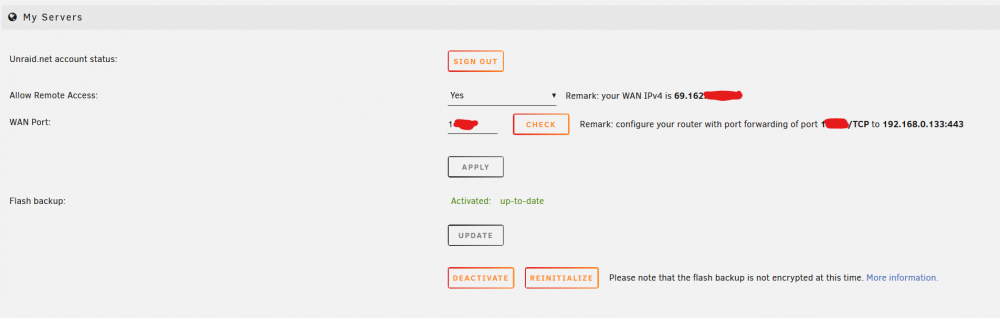

c. setup port forwarding on my router to allow unraid.net remote server access as instructed

a. remote access from unraid.net myServers section is not working

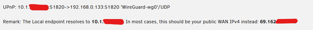

c. Wireguard has a 'remark' shown below:
Remark: The Local endpoint resolves to 10.1.***.***. In most cases, this should be your public WAN IPv4 instead: 69.162.***.***
The 10.1.***.*** is what is shown by duckdns and when I ping myservername.duckdns.org the IP address comes up as 10.1.***.***. I have no idea what this IP address starting in 69.162 is from and it also shows like below:image.thumb.png.3196ca01912f089975012611190cdb76.png

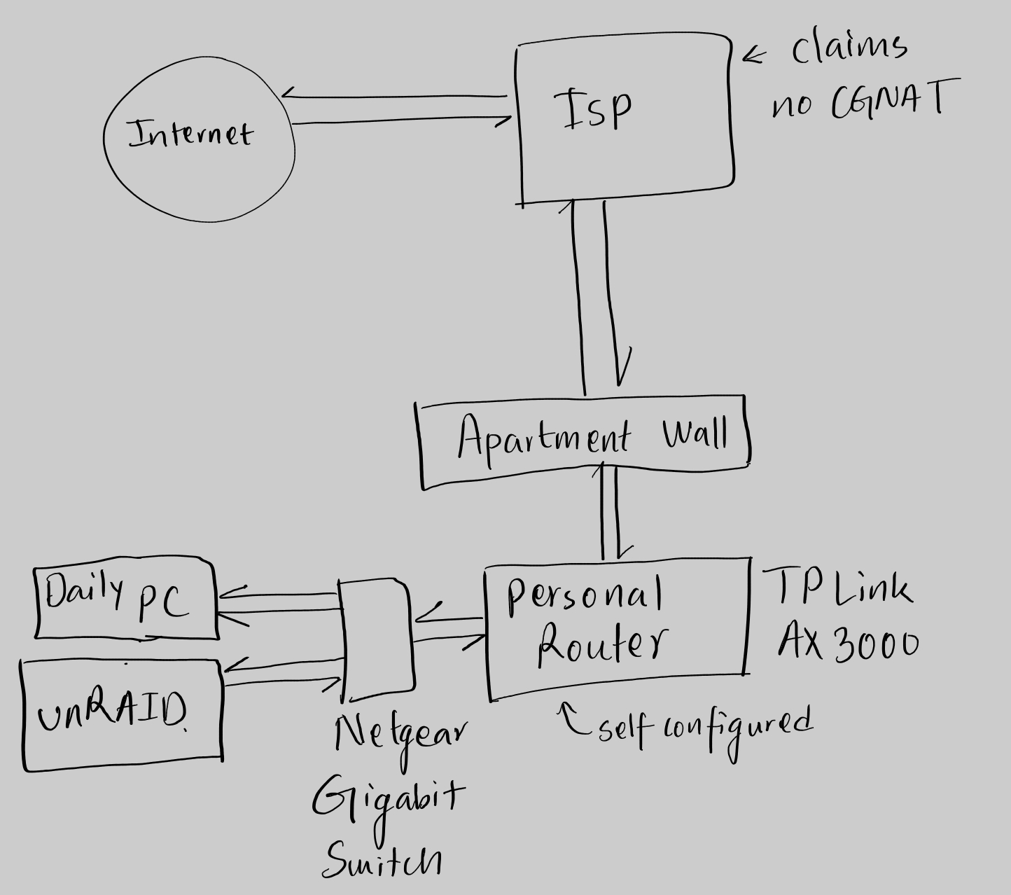

Please describe your network.
Here's a sketch of the network setup.
Network Layout

1 hour ago, ljm42 said:
Are you double-NAT'd?  (i.e. do you have more than one router?)
I am not double NAT'd. I only have one router (not a modem/router combo) and one gigabit 5 port switch.

Unraid's IP is 192.168.0.133 so your Router's LAN IP subnet is probably 192.168.0.0/255
whatismyip.com shows your WAN IP as 69.16.x.x. Duck DNS needs to resolve to this address. Or you can skip Duck DNS and just put the 69.16.x.x address into the WireGuard config.
Can you login to your router and find out what it thinks its external IP is? If it is the 69.16.x.x address then you are golden.  If it is 10.1.x.x then you are you are in a double NAT/CGNAT situation and probably aren't doing to be able to get external traffic to hit your box.

It is 10.1.xx as shown by my router's 'Default Gateway'. Would updating on duckdns with this 10.1.xxx IP do the trick?

Incoming traffic needs to come in at the 69.16.x.x address. Whatever router is at that address needs to have a port forward that forwards the traffic to your router at 10.1.x.x.  Your router then needs a port forward to forward it to Unraid. It is doable, but you need to control both routers (although in most cases, if you control both routers your best bet is to get rid of one of them)
