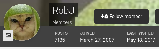

Unfortunately I don't think you will get any response. It's been almost 5 years since he signed in.

Which probably was a good reason for pulling the WIKI...   (I also realized that after I make the post and hovered over the ping in the posted message...)
