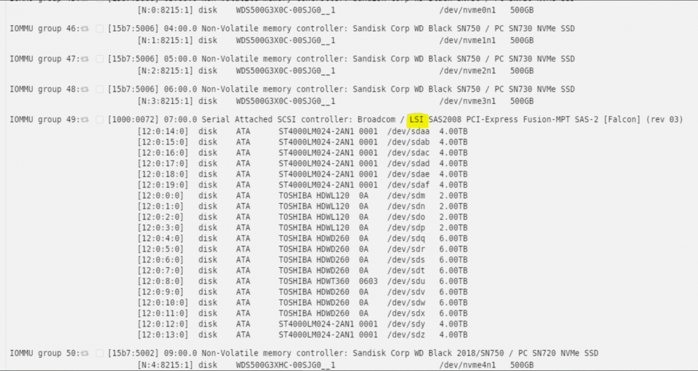

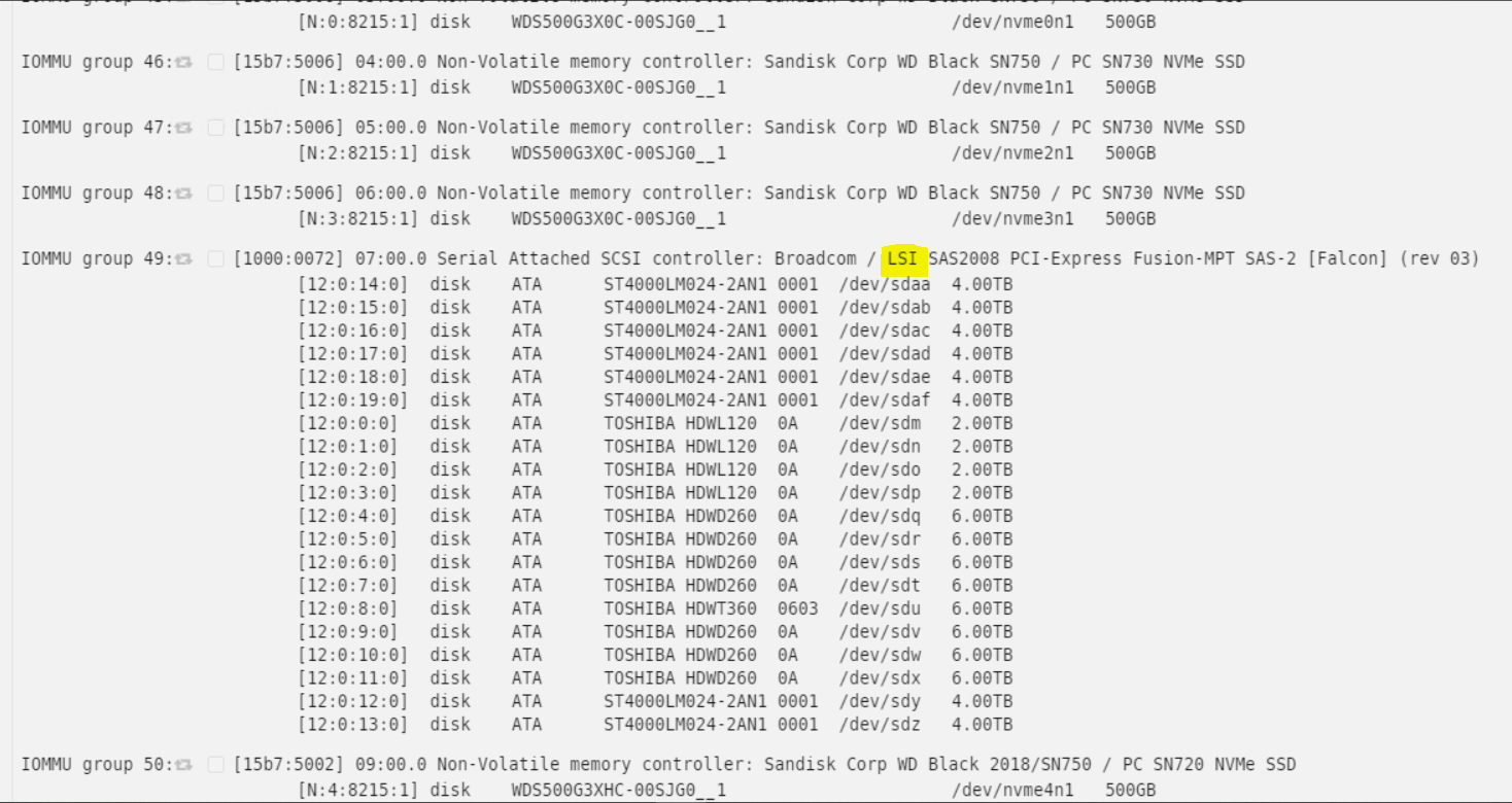

You can just go to Tools -> System Devices and search for "LSI", e.g.:
