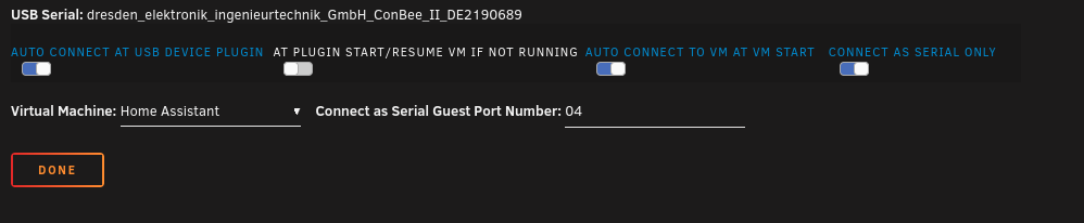

    I followed instructions given by SimonF. I use USB manager but did not know that new feature has been added to pass device to VM in serial mode. So instead of modifying XML file, all you need to do is
  • If anyone come here to get Home assistant working in a VM running UNraid 6.10,RC4  and you don't want to start over configuring your ZIGBEE HA then do this:   https://community.home-assistan

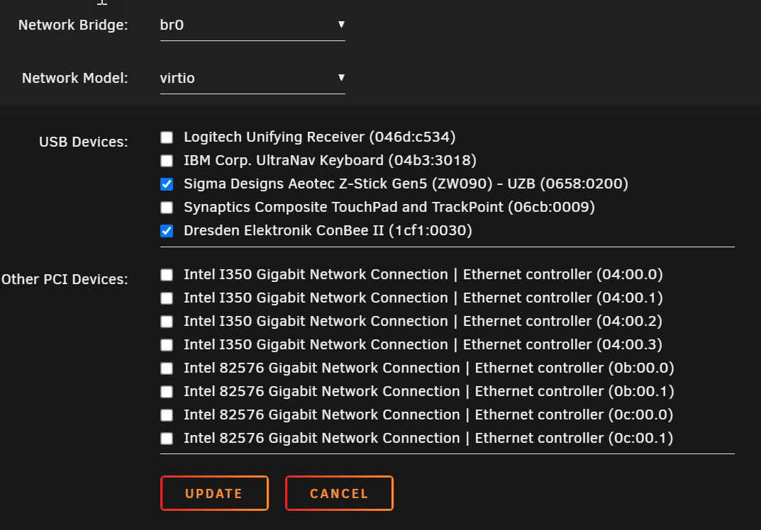

I did the insert this in the XML for Home assistant if using the Conbee2 stick!
    </memballoon> placed under this line:
    <serial type='dev'>
      <source path='/dev/serial/by-id/usb-0000_0000-if00'/>
      <target type='usb-serial' port='1'>
        <model name='usb-serial'/>
      </target>
      <alias name='serial1'/>
      <address type='usb' bus='0' port='4'/>
    </serial>
Get USB ID by console:
ls /dev/serial/by-id/
But even if I got the VM started then Home assistant cant access the Conbee stick?

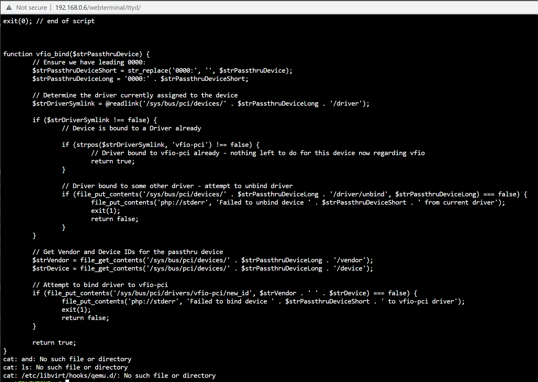

Are you running on RC4 now? can provide output of cat /etc/libvirt/hooks/qemu and ls /etc/libvirt/hooks/qemu.d/
I think I am missing removal of the 6.9.2 vers updates during upgrade to 6.10 vers
Just checked should be removing.
Yes of course, anything to help
#!/usr/bin/env php
<?php
#begin USB_MANAGER
if ($argv[2] == 'prepare' || $argv[2] == 'stopped'){
  shell_exec("/usr/local/emhttp/plugins/usb_manager/scripts/rc.usb_manager vm_action '{$argv[1]}' {$argv[2]} {$argv[3]} {$argv[4]}  >/dev/null 2>&1 & disown") ;
#end USB_MANAGER
if (!isset($argv[2]) || $argv[2] != 'start') {
        exit(0);
$strXML = file_get_contents('php://stdin');
$doc = new DOMDocument();
$doc->loadXML($strXML);
$xpath = new DOMXpath($doc);
$args = $xpath->evaluate("//domain/*[name()='qemu:commandline']/*[name()='qemu:arg']/@value");
for ($i = 0; $i < $args->length; $i++){
        $arg_list = explode(',', $args->item($i)->nodeValue);
        if ($arg_list[0] !== 'vfio-pci') {
                continue;
        foreach ($arg_list as $arg) {
                $keypair = explode('=', $arg);
                if ($keypair[0] == 'host' && !empty($keypair[1])) {
                        vfio_bind($keypair[1]);
                        break;
exit(0); // end of script
function vfio_bind($strPassthruDevice) {
        // Ensure we have leading 0000:
        $strPassthruDeviceShort = str_replace('0000:', '', $strPassthruDevice);
        $strPassthruDeviceLong = '0000:' . $strPassthruDeviceShort;
        // Determine the driver currently assigned to the device
        $strDriverSymlink = @readlink('/sys/bus/pci/devices/' . $strPassthruDeviceLong . '/driver');
        if ($strDriverSymlink !== false) {
                // Device is bound to a Driver already
                if (strpos($strDriverSymlink, 'vfio-pci') !== false) {
                        // Driver bound to vfio-pci already - nothing left to do for this device now regarding vfio
                        return true;
                // Driver bound to some other driver - attempt to unbind driver
                if (file_put_contents('/sys/bus/pci/devices/' . $strPassthruDeviceLong . '/driver/unbind', $strPassthruDeviceLong) === false) {
                        file_put_contents('php://stderr', 'Failed to unbind device ' . $strPassthruDeviceShort . ' from current driver');
                        exit(1);
                        return false;
        // Get Vendor and Device IDs for the passthru device
        $strVendor = file_get_contents('/sys/bus/pci/devices/' . $strPassthruDeviceLong . '/vendor');
        $strDevice = file_get_contents('/sys/bus/pci/devices/' . $strPassthruDeviceLong . '/device');
        // Attempt to bind driver to vfio-pci
        if (file_put_contents('/sys/bus/pci/drivers/vfio-pci/new_id', $strVendor . ' ' . $strDevice) === false) {
                file_put_contents('php://stderr', 'Failed to bind device ' . $strPassthruDeviceShort . ' to vfio-pci driver');
                exit(1);
                return false;
        return true;
could do the list
/bin/ls: cannot access '/etc/libvirt/hooks/qemu.d/': No such file or directory?
This is fine as you are not on 6.10rc.
When you upgrade the entries should be removed from the qemu file and a new file created in qemu.d
I  was on RC4 I am now on RC5
Do you need anymore info or additional running commands from me? :--)
I dont think so. Are you seeing any issues?
There should be no entries in the qemu file and a file in qemu.d dir called usb_manager.
Yes I get this no - no further problems 🙂

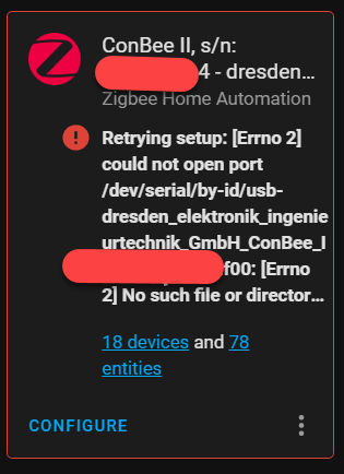

Thanks for this fix, the issue still seems to be in 6.10 final, and after making the XML adjustments and the naming changes in my HA file my Zigbee is back up and running.
This is definitely still an issue -- currently reading through past threads after upgrading to 6.10.2 and being flooded with the following messages and an unusable ConBee II:
May 29 10:32:30 Unraid kernel: usb 2-1.4: usbfs: process 32050 (qemu-system-x86) did not claim interface 1 before use
Solution as posted in this thread (and others) was to obtain the proper device path for the ConBee II and manually add this in to the virtual machine XML as per https://community.home-assistant.io/t/unraid-vm-conbee-ii-stick-dev-path-change-configuration-problem/411424.
Edited by nmethod
Even after the solution in the link from the previous post I still receive a flood of the error that nmethod posted above.
Running Unraid 6.10.2
I just tried upgrading to Unraid 6.10.2 but experiencing the same issue. Also with the USB Manager plugin. IMHO editing the XML for device mapping is quite a poor solution. I hope the Unraid developers can provide a real bug fix.
Luckily downgrading Unraid is a breeze, so thanks for that.
A backward step for me. Conbee II working reliably (GUI or XML edit) with Unraid 6.9.2. Can't get either option working under 6.10.2. Hoping for an easy fix in the future. In the meantime I've downgraded.
Unfortunately I have had to downgrade as well, the XML, config edits just didn't work for me (strangely nothing relevant in core.config_entries to edit). I will hopefully look to upgrade once a reliable solution is found.
Looks like this is still an issue with 6.10.3
Is there anything else that can be tried to pass the conbee usb through without error?

Do you still pass thru the usb device or just the serial entry.
This solution has so far worked for me as well, with just the serial entry.  I feel like going from 10.1 to 10.2 broke it again and I had to redo it and I was nervous going to 10.3, but it went smoothly.  I do wish just adding the usb device would work as expected (or as I expect it to), but I guess if the serial way works for now, I'll go with it.
