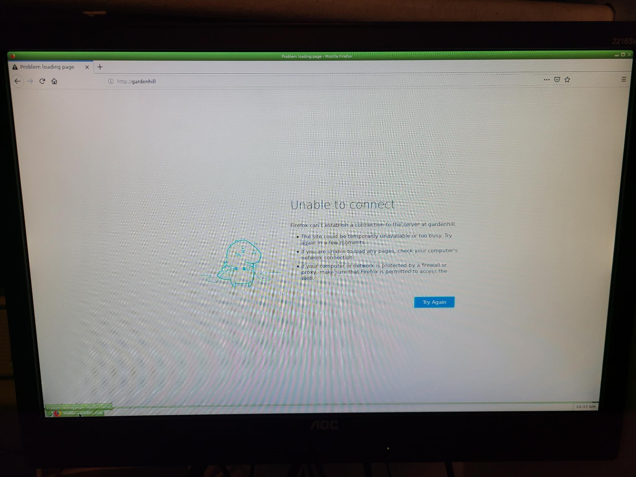

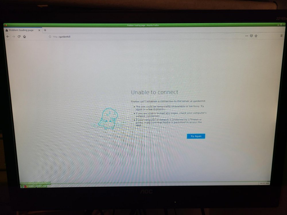

So I haven't turned on my server for a few weeks to save some energy, but needed to use server for some backups.  When turning on, system boots up fine and I can login on system itself, however, I cannot access the web interface from server, or via IP address or server name from system or other computers on same network.  It just gives me an "unable to connect" or refused to connect error page.  Telnet/SSH still works, but idk how else to access the web interface to start the array so I can access the files on my server.
BTW - I have booted normally, and in safe mode with no plugins, and both cannot access web interface while using the gui on system itself.  please help, need to access some files today!

Yes, I've tried IP, and name, 127.0.0.1, and localhost all which are not able to connect/refuse to connect.  Since firefox is loaded, I am able to browse other regular websites like yahoo.com and such.

This is in your syslog (which is presumably current ;) )
Apr 13 10:30:08 Gardenhill root: nginx: [emerg] PEM_read_bio_X509("/etc/ssl/certs/unraid_bundle.pem") failed (SSL: error:0908F070:PEM routines:get_header_and_data:short header)
Try deleting the contents of /config/ssl and /config/ssh on the flash drive and reboot.  Any change

Apr 13 11:48:03 Gardenhill root: nginx: [emerg] cannot load certificate "/etc/ssl/certs/unraid_bundle.pem": PEM_read_bio_X509() failed (SSL: error:0908F066:PEM routines:get_header_and_data:bad end line)
Try deleting /config/ssl and /config/ssh reboot if still no go, then post a new set

whoa! that did the trick! I can see the web interface now!  BUT I have another issue, the array seems to be looking for older hard drives, which I have since replaced.  Is there any way I can see the array config from only a couple of weeks ago?  Which file would that be under.  I just want to makes sure I am using the correct drives for slots that I was using before when it was working so I don't lose any files.
