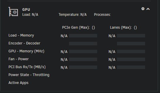

All seemed fine, so I setup the VM, and passed through the GPU, and started it. Once I setup Plex, all is working fine. I can transcode using the GPU just fine, but then I noticed that I no longer can see the stats of the GPU in GPU Statistics. This is what I see

If you pass the GPU through to a VM then it is no longer visible to Unraid.

@itimpi I currently have the same "Issue", so I understand that, when a VM is started, I can't monitor the GPU usage right ?
That weird, it's kind of the whole point of this, but ok, anyway, on the other hand, when I shutdown the VM, the issue persist, I can't see the stats anymore, my GPU is not recognized and I have ~5% CPU usage because of log flood:

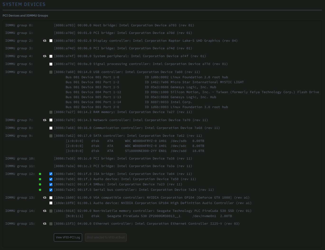

Can you provide screen print of system devices in tools? GPU check boxes must not be checked if using nvidia driver.
It's not checked.
Right now I have stats showing, but of course my GPU is in idle, when a VM is started with the GPU passthrough it just doesn't monitor anything anymore. It's not even able to display the GPU name or temperature...
And when I stop the VM, it doesn't work again, instead I have the message mentioned previously flooded in the Logs and ~5% CPU usage. (But also my entire Unraid seems to be slow, it takes almost 1 minute to change the current page.) The only way to fix the log flood, cpu usage and slowness it to reboot the entire system...

That is expected as the gpu is exclusivily allocated to the vm. it is no longer visible to the host.
Why do you have iommu group 12 bound to vfio? post diagnostics,
IOMMU group 12 is because I wasn't able to get sound from a VM using only the iGPU, this was the only way, I don't even know why.
