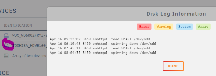

You can click disk icon to check individual disk log
