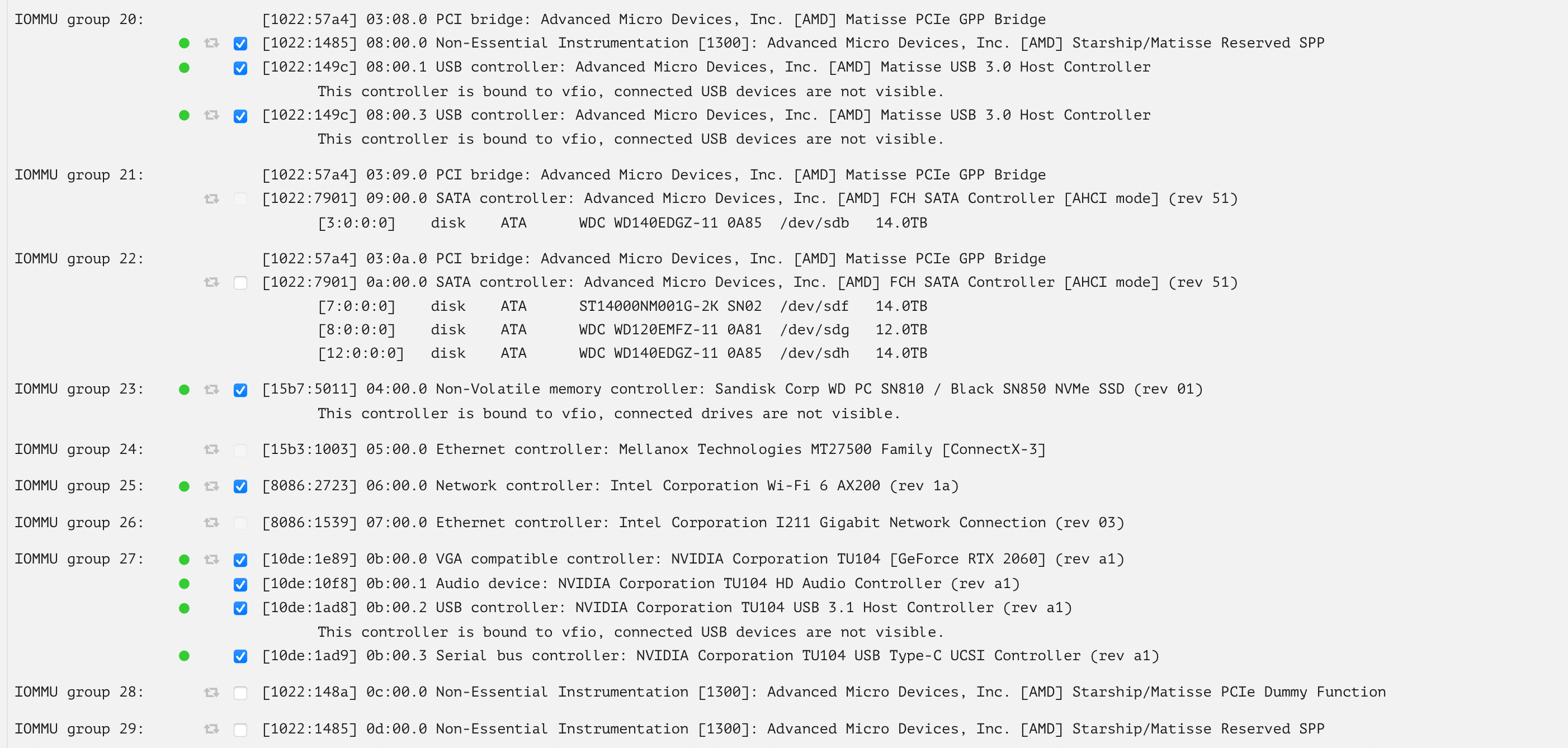

No need, I think I see your problem, you are passing through this device to a Windows 10 VM:
-device '{"driver":"vfio-pci","host":"0000:0a:00.0","id":"hostdev0","bus":"pci.3","addr":"0x0"}' \
-device '{"driver":"vfio-pci","host":"0000:0a:00.1","id":"hostdev1","bus":"pci.4","addr":"0x0"}' \
-device '{"driver":"vfio-pci","host":"0000:0a:00.2","id":"hostdev6","bus":"pci.9","addr":"0x0"}' \
-device '{"driver":"vfio-pci","host":"0000:0a:00.3","id":"hostdev7","bus":"pci.10","addr":"0x0"}' \
I assume this was a GPU before, but you need to keep in mind that when you add or remove hardware the devices ID can change, device 0a:00.0 is now the SATA controller:
0a:00.0 SATA controller [0106]: Advanced Micro Devices, Inc. [AMD] FCH SATA Controller [AHCI mode] [1022:7901] (rev 51)
    Subsystem: Advanced Micro Devices, Inc. [AMD] FCH SATA Controller [AHCI mode] [1022:7901]
So when you start the VM the controller is no longer available to Unraid and all disks connected there will be gone.

That makes a ton of sense.
I did make one hardware change after moving before firing up Unraid which would explain the issues. I added a 10g SFP card. The card worked fine and it seemed like Unraid was fine and only the usb failed so I didn’t think anything of it. I probably should have known better.
I had a trip planned last week and as a last ditch effort I pulled the card, restarted the server and it has been working fine ever since.
Now that I’m back and read your response, I want to see if I can get this all sorted out. Ideally I would still love to get the 10g card to play nicely.
As far as I can tell, under system devices, all I am currently passing through is a GPU, an NVME drive, and a couple USB ports.
How should I proceed if I want to add the 10g card back into the system?

The issue is that adding a card can change the id’s.  You should be able to undo the current passed-through devices, add the 10g card, and then redo the pass-throughs with the id’s that they now have.
I did it and right away got the same issue.
Here is a screenshot of the devices I have passed-through. The Sata Controllers are left untouched.
I uploaded logs of before starting the Array and after.
after server-diagnostics-20220426-2120.zip before server-diagnostics-20220426-2118.zip
At this point I am thinking it has to be a hardware compatibility issue. Even though the ConnectX-3 works fine, maybe it has some sort of issues with my motherboard that causes the Sata ports or controller to stop working. Although it wouldn't explain why it only happens after the array is started.

Disable VMs auto starting and post new diags after array start with the 10GbE NIC installed.
