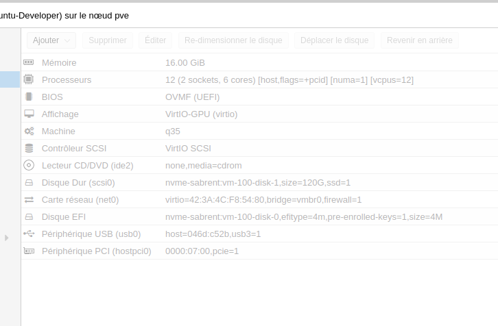

Little update
I have released some tests to check if Unraid is the "problem".
I temporally install Proxmox on the same host machine.
Under Proxmox, I have created a VM with following settings:
And all is great !
Proxmox expose a more recent version of pc-Q35.
Maybe it can come from there ?
(Please, I don't wanna run Unraid inside Proxmox :P )
Edited by dekadmin

You are using Seabios on your Unraid VM, but OVMF on Proxmox.
Try reinstalling the VM under Unraid using OVMF for an apples to apples comparison.
Also note that while Unraid 6.9.2 is on Q35-5.1, Unraid 6.10.0-rc5 is on the much newer Q35-6.2, so you might see better performance there also.
