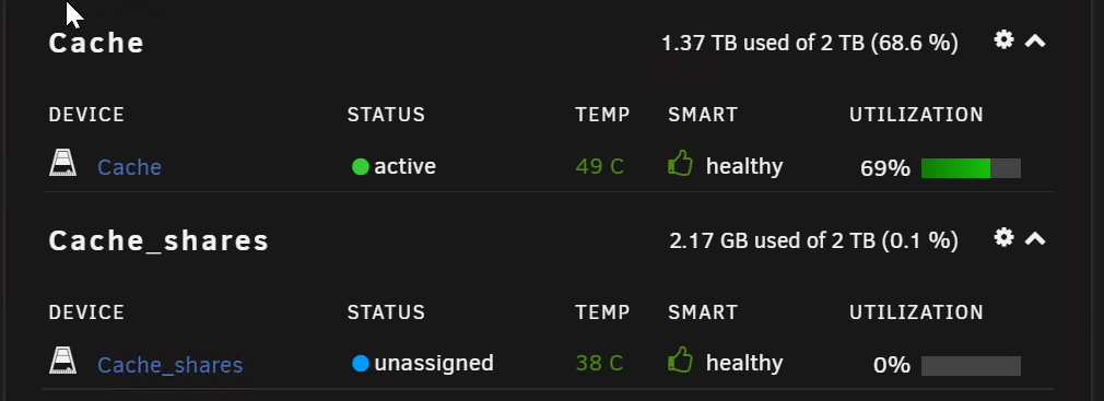

This is very strange after adding the new cache drive
I have it listed as un-assigned? its the Cache_shares

I found a post saying I should reboot again, but that didnt help.
I then removed the new cache drive it was empty anyway, and then I started without the new cache and stopped and added it again and now its active!

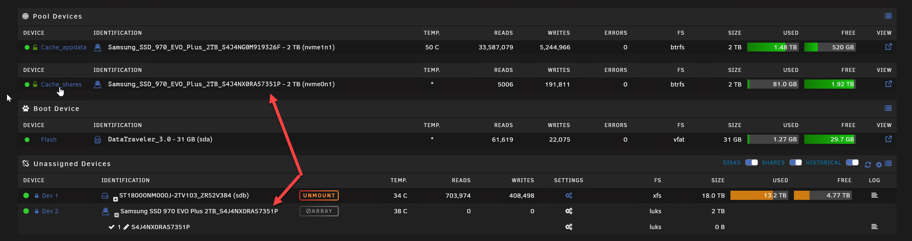

Also updated plugins to do appdata backup etc.... so everything was running just fine and I wanted to check files on my new cache drive
But this time it was EMPTY! and in my main view I had this:
(This was not present when running the new cache drive at start?)
Somehow my new cache drive was in both places?
Afraid that I had now lost all my cache files I did a reboot and everything is back again?
I upgraded to rc5 yesterday, not sure this is an error or something else?
Did you get diagnostics when it had that problem?
So sorry My BAD I got a little freaked out and did a reboot - hoping all my data would reappear again and it did....
I am monitoring my new cache very closely. I promise to send a new Diag if it happens again
