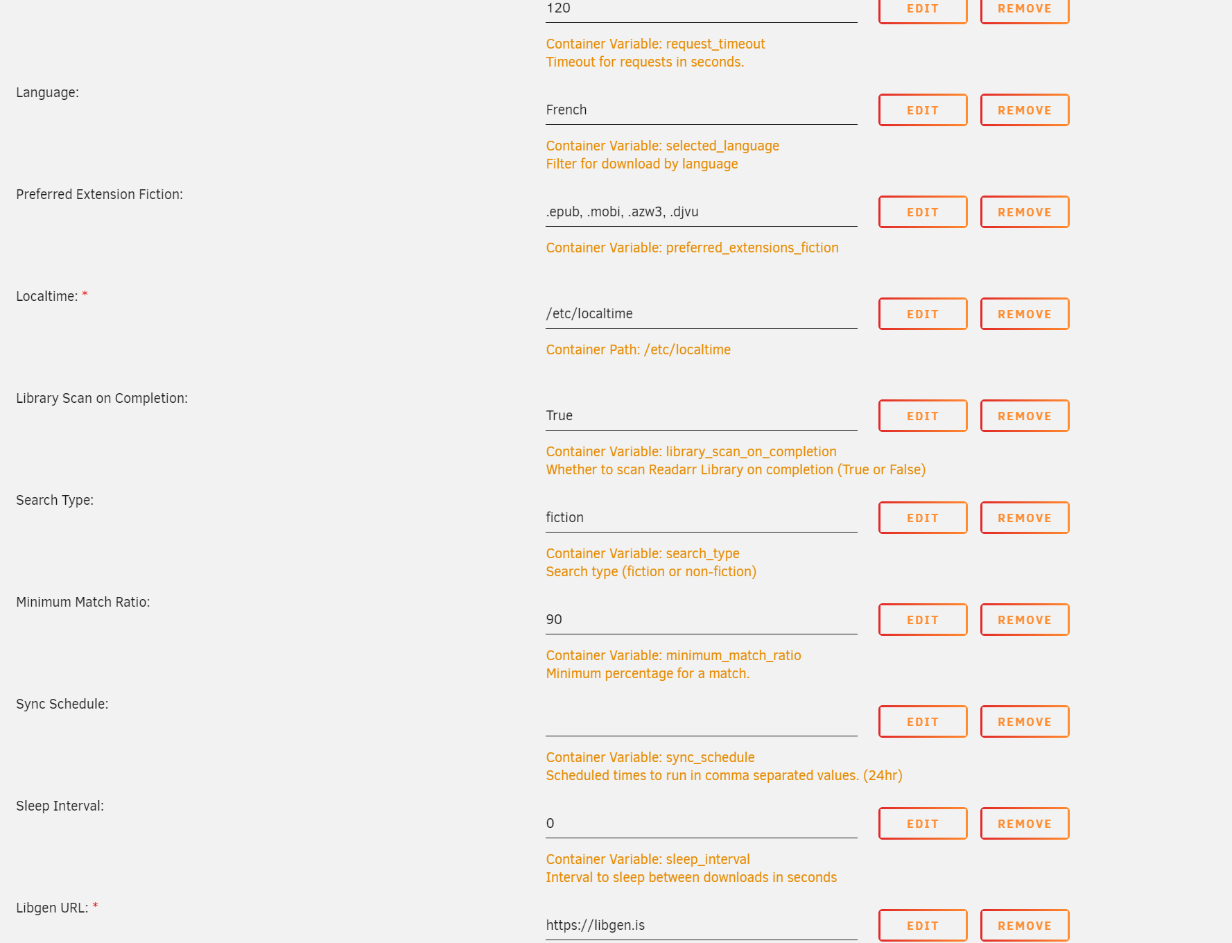

I get this error a lot : "Error Searching libgen: HTTPSConnectionPool(host='libgen.is', port=443): Max retries exceeded with url: /url (Caused by NewConnectionError('<urllib3.connection.HTTPSConnection object at 0x14e2e165e810>: Failed to establish a new connection: [Errno 111] Connection refused'))"
Here is the setup
EDIT: it appears that at least in my country, libgen.is is not reachable. I tried searching for alternatives/mirrors, but then i directly get a Libgen error in the GUI.

       Yea, your config looks alright. Might just need to see if you can find a different libgen mirror that works.            Also, not sure if your Readarr is exposed to the internet, but you may want to take the picture down since your API key is in there.
Thanks for the reminder about the api key, but my Readarr isn’t exposed.
Weirdly, I can now open libgen.is in my browser tonight, but I still get an error 111 in BB. Is it the fact that I’m asking for books in French? Should I set the language download to any?
      It looks more like libgen won't let you connect at all for some reason. Can you ping libgen.is from your unraid console? I'm  not near home, and apparently my vpn isn't working or I'd try mine to see if I'm getting the same error. I know libgen has occasional issues.

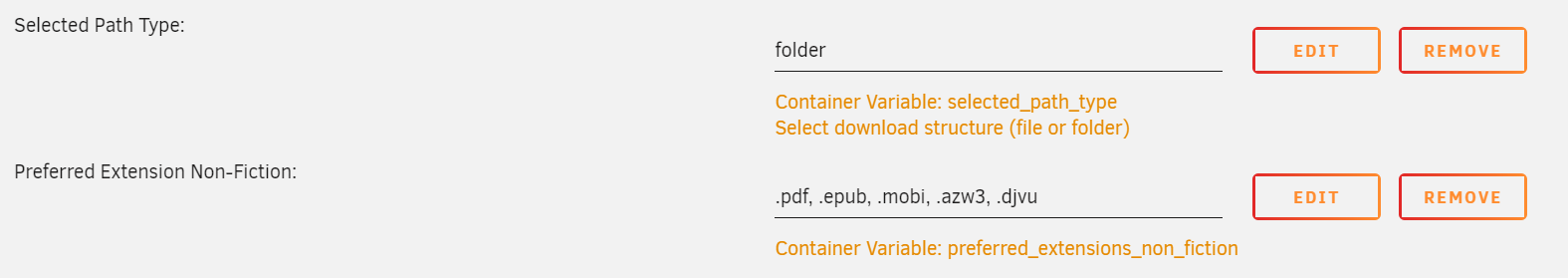

I was able to make this work. For some reason, some of my container don’t work properly without an additional --dns 1.1.1.1 parameter. It seems to now be working correctly.
Thanks for the help!
EDIT: new weird thing. Even tho I can find, by going myself to libgen, the books I look for, some of them return a No Link Found in BB. I tried changing my language from French to any, but it does not work either. Any idea on this?

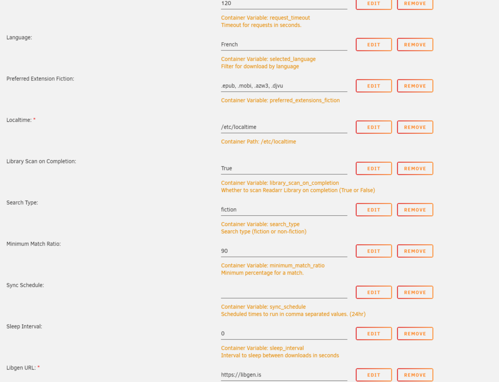

Finaly got everything to work, but BB still can’t download some files, even tho if I go myself to my defined libgen URL, search said book, I can indeed find the book and download it. Very strange…
Do you think it would be possible to add multiple libgen url to use? To multiply chances of a match and download?
 I think that would have to be implemented in the project itself rather than the unraid template. The dev may be able to help out with your issue too.    https://github.com/TheWicklowWolf/BookBounty

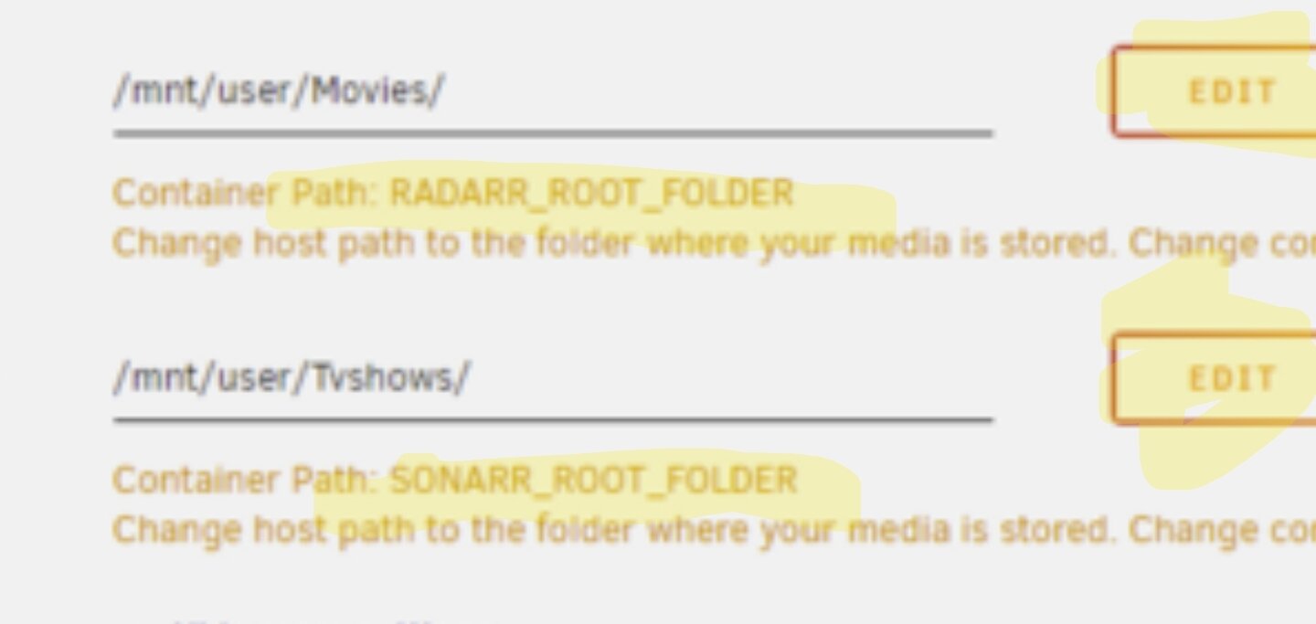

I am having a bit of trouble with the Trailarr container.
my Sonarr and Radarr paths are set to
/mnt/user/Tvshows/
/mnt/user/Movies/
which ive set in the Trailarr Container, I can access the share and have read/write permissions into the share, but Trailarr is giving the following errors on permissions.  (see Image below)

I was working with the trailarr creator to adjust the template a little. First thing I would do is remove trailarr and start fresh with the updated template.
If you don't want to start fresh, you can adjust the template on your own. You'll have to add a PUID variable and PGID variable. Set PUID to 99, and PGID to 100.
It also looks like you need to adjust your root folders. The right side of this line needs to match whatever shows up in your sonarr and radarr instances.
-v '/mnt/user/Movies/':'/data/media/movies':'rw'
Go into radarr/sonarr, go to settings, and media management. Under root folders, these need to match exactly to the trailarr template. So, mine are "/data/media/movies", but your's may just be "/movies".
In the updated template, I removed the default paths so it is hopefully more clear that both sides need to be adjusted.
Unfortunately, without the PUID and PGID set, it may have messed up your permissions too, so once you get it setup again, in the unraid command line, you may need to do "chown -R nobody:users /mnt/user/Movies && chown -R nobody:users /mnt/user/Tvshows".
Adjust that command to match the host paths to your movies and TV shows. I just took the paths you had set in the template you posted.

Your root folders are still wrong. You have to hit Edit. The host path should be your unraid path. Container path needs to match your radarr/sonarr root folders exactly.
Please see the images below of my radar and sonarr config.
image.thumb.png.9452e34e4d52a429fb2cba45086ca4fa.pngimage.thumb.png.0c1a37b3d9b0a20f3856ba2305ca0e74.png
In the trailarr template, you have to hit Edit and change the highlighted part to match your root folders. These two lines should match the lines from your Radarr and Sonarr template.Screenshot_20240810_161131_Mull.thumb.jpg.49c8c3895779f19b62f80149d42d4216.jpg
But, it looks like both of your root folders are "/media" so it might not work right now unless you change those in Radarr and Sonarr or run two instances of trailarr.

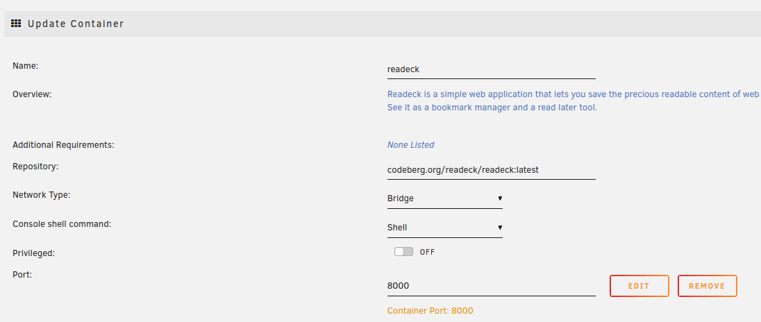

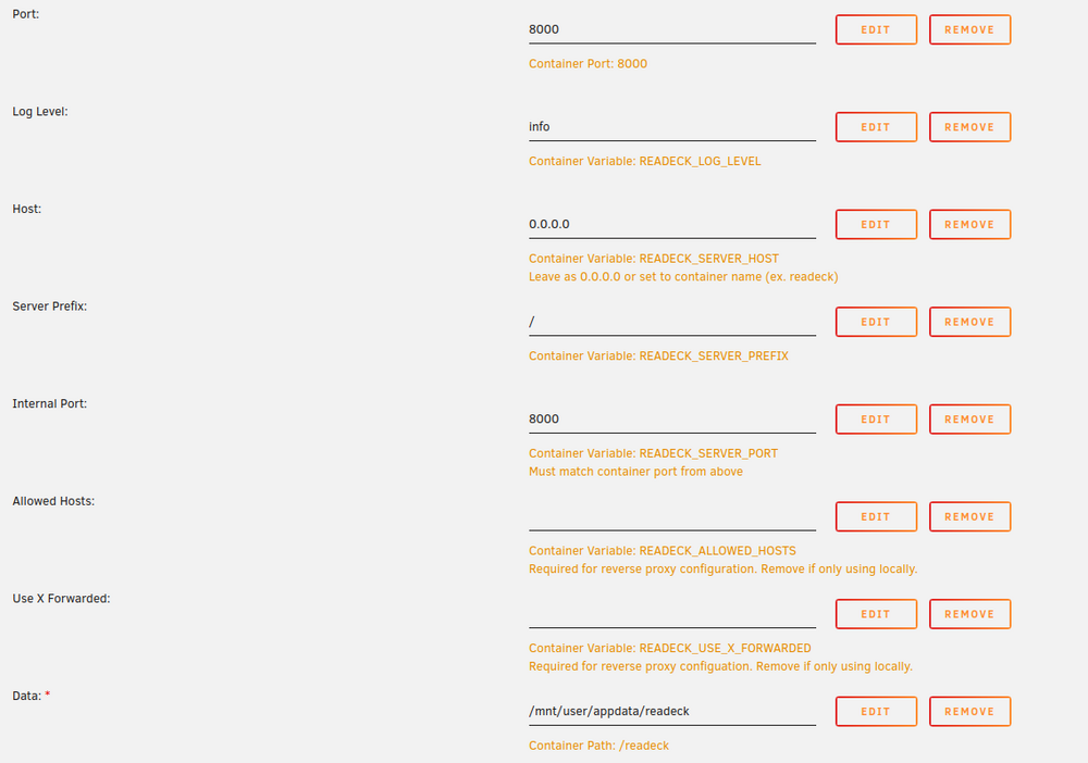

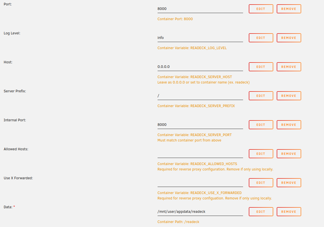

Just to cover your bases. You shouldn't have to change the internal port variable. That should stay at 8000. And host can stay 0.0.0.0. Or, if you don't want it to be all zeros, you should be able to set it to "readeck" without quotes. (Or whatever you named the container, if you named it something else)

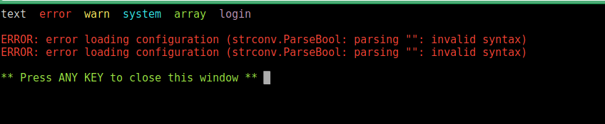

Hi, not the same person but the same problem :P
ERROR: error loading configuration (strconv.ParseBool: parsing "": invalid syntax)
pictures below. any ideas?
I also tried the local ip of my unraid and "readeck" without the quotes as host but that didn't change anything.
Edited by Icarium
@Icarium Looks like a typo in your config.toml. Maybe change the filename to config.bak or something, and let Readeck recreate it. See if that helps.
@JPDVM2014 thanks for the fast answer! renamed it and the file got recreated but no change. also the file seems to be empty (at least its shown in "shares" as 0 B). mmh
@Icarium Yea, it should have something in it. Mine is 243B.
Next thing I would try is removing the READECK ALLOWED HOSTS and USE X FORWARDED if you aren't using them. My guess is they are what is causing the empty "" in the config.
EDIT: It might be obvious, but just in case. Once you remove those entries from the template, delete/renamr the config.toml so it can get recreated again.
Edited by JPDVM2014
@JPDVM2014 thanks! that did it!
also thanks for mentioning the delete/rename - i'm fairly new with this 🙃
@adambeck7 if you are still looking for a solution this worked for me!
