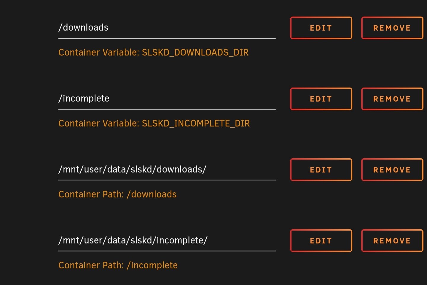

Soularr help needed,
I've installed Soularr, I got it to sync up with Lidarr just fine and download files. But Lidarr doesn't seem to be picking up on the files. I'm not sure what I'm doing wrong here. Let me know what info you need. Running this on Unraid
config file for slskd - directory path
Soularr template
Lidarr template
config for soularr
@Trinistan In your soularr config.ini, change Slskd's download directory to "/downloads" without the quotes.
That should, hopefully, fix it.
@JPDVM2014 didn't seem to fix it. I've let 3 albums complete so far.

Looks like your slskd config might have an error too. If you are using the CA template, you shouldn't need to manually set the download and incomplete directories. Here is my slskd template for example. The only thing in my slskd.yml is the API key for soularr.
@Trinistan I just saw your edit about the error. So, I think it is a couple things. First, you'll need to edit your slskd.yml to either remove or correct the directories like I mentioned in my other post. If you are going to manually set them, they ahould be the volumes inside slskd, not your Unraid directory. So, most likely "/downloads" and "/incomplete".
Then if you are still getting the permission error, you'll have to change a few more things.
@JPDVM2014 I've set up my template just like that, I still don't see albums being added and transferred in Lidarr.
Anything else I need to try?
@Trinistan Last thing I can think of would be to double-check your permissions. If you didn't already, go through the readme I typed up here. Especially the slskd note in step 1.

I tried adding another mount point to Lidarr
adjusted that mount point in the soularr config
download_dir = /slskd/slskd-complete
here is the slskd template in unraid
slskd.yml
 directories:
   incomplete: /incomplete/
   downloads: /downloads/
It doesn't appear Lidarr sees the downloads still. Let me know if you have time to troubleshoot with me.
Thanks again.
