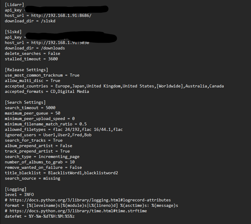

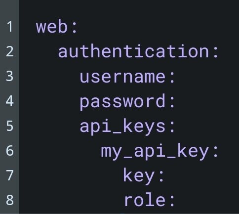

I went and purposely did the wrong API key in my Soularr config, and got the same error. So, I think it's an issue there. Could you post your slskd and Soularr config? Just blur out the API key.
Absolutely. I'm sure I did something wrong somewhere.
You have to indent everything below authentication by 2 spaces.
Yep, that was all it took. I hate yaml lol. Thank you! Looks like soularr and slskd are communicating, missing albums are downloading, but they aren't being imported. This was my original issue.

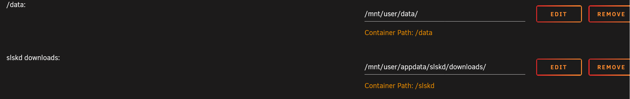

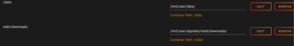

I probably confused myself trying to fix this before, but this is my current lidarr pathing:
Right there with you with yaml. Lol

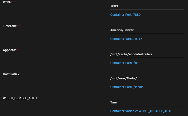

Need help with Trailarr. I have it setup as follows:
No config files are ever saved at the app data location. The app will work, but if it gets shutdown and restarted, it looses all info. and I have to resetup everything. this happens every time. I don't belive it was setup corectly since it will not save the config info.
Please help!

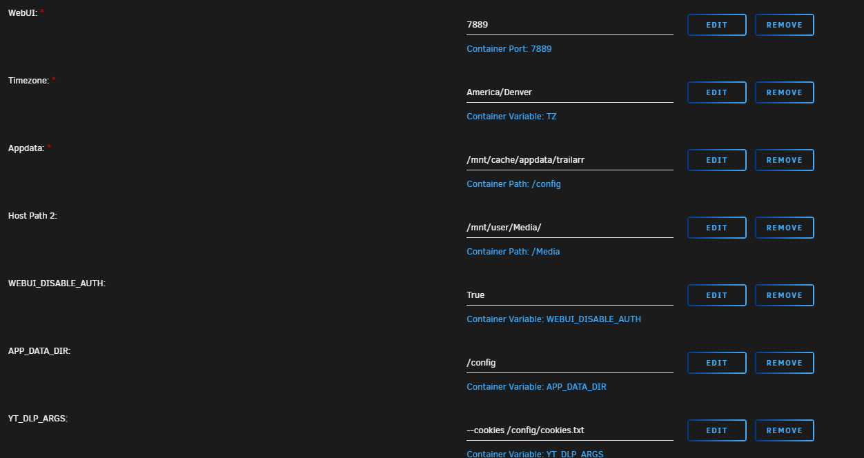

Ok I have it saving the files, but it will not download videos. here is my config: I get this error: Exception: ERROR: [youtube] 8Zv7wd1a-5A: Sign in to confirm you’re not a bot. Use --cookies-from-browser or --cookies for the authentication. See https://github.com/yt-dlp/yt-dlp/wiki/FAQ#how-do-i-pass-cookies-to-yt-dlp for how to manually pass cookies. Also see https://github.com/yt-dlp/yt-dlp/wiki/Extractors#exporting-youtube-cookies for tips on effectively exporting YouTube cookies
I logged into youtube via firefox and exported my cookies and addded them into trailarr, but continue to get the error.
Edited by almulder
@almulder Looks like the default appdata directory changed to /config at some point.
Hit edit next to Appdata and change the container path from /data to /config, and see if that helps.
For some reason, my install works with both mappings, even though I don't have the appdata env var set.
Let me know if that fixes it so I can update the template. Thanks!
yes that does do it. myabe you can help with one more. i am getting
Some trailers will not download, in the log it says "Sign in to confirm your age. " So i looked into how to export my cookies as load then into the docker, but they never seem to take (Exported them from firefox using ym per their github)
see my updated screenshots above.

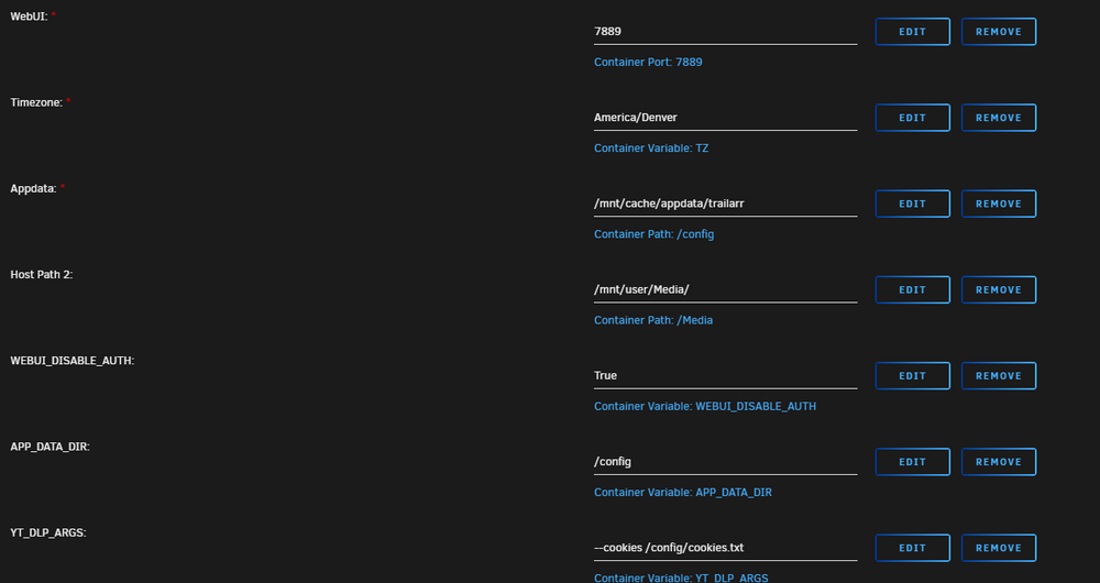

Also the docker defaulted to /mnt/docker_v/appdata/trailarr/, it should be defaulting to /mnt/user/appdata/trailarr
Thanks for the update! I updated the template and fixed that typo. docker_vm is my appdata drive.

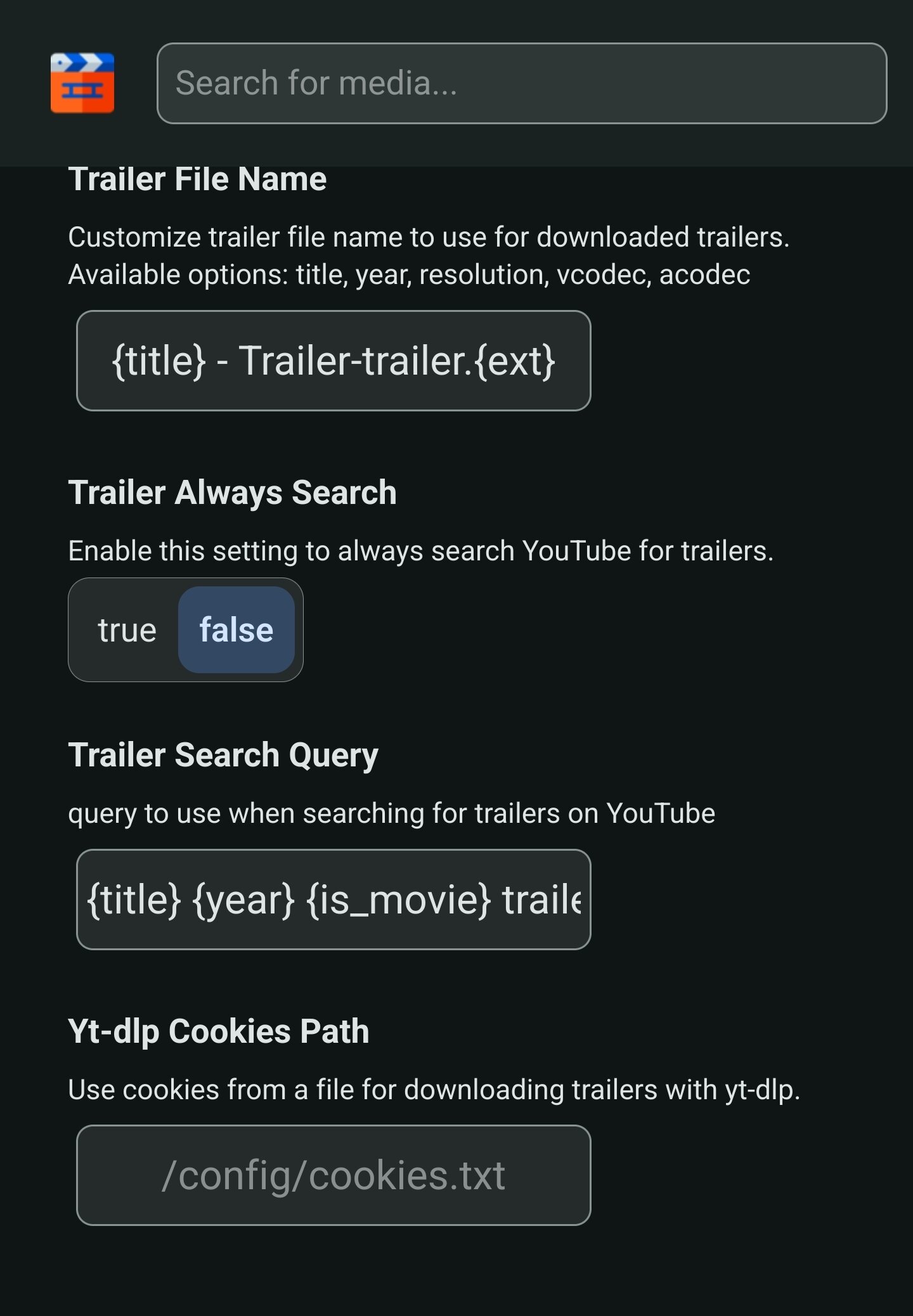

For the cookie file, I don't think you need that extra YT_DLP_ARGS variable. Put your cookies.txt in your appdata folder, and then you can set the path in trailarr's webui under settings.
trying to get he trailarr to work correct. my movies are download and moving over. but tv shows I get [ERROR|trailer|L267]: TrailersDownloader: Failed to download trailer for '[1599]Community': Failed to move trailer to folder: [Errno 13] Permission denied: '/Media'
now I get a new error message today
TrailersDownloader: Failed to download trailer for '[1672]Rick and Morty': ERROR: [youtube] WNhH00OIPP0: Sign in to confirm you’re not a bot. Use --cookies-from-browser or --cookies for the authentication. See https://github.com/yt-dlp/yt-dlp/wiki/FAQ#how-do-i-pass-cookies-to-yt-dlp for how to manually pass cookies. Also see https://github.com/yt-dlp/yt-dlp/wiki/Extractors#exporting-youtube-cookies for tips on effectively exporting YouTube cookies
Could you post your radarr and sonarr templates too?
Two things I noticed, you shouldn't need the APP_DATA_DIR variable. /config is the default.
You also might not need the path mappings. I'd get rid of those and see what happens.
For the cookie error, you need to follow the instructions here (https://nandyalu.github.io/trailarr/help/common/#export-youtube-cookiestxt-file) and put the cookies.txt file you get into your appdata folder. Then there is a setting in the trailarr webui to tell trailarr where it is.
Edited by JPDVM2014
i have moved the cookies.txt file into the trailarr folder and still nothing
