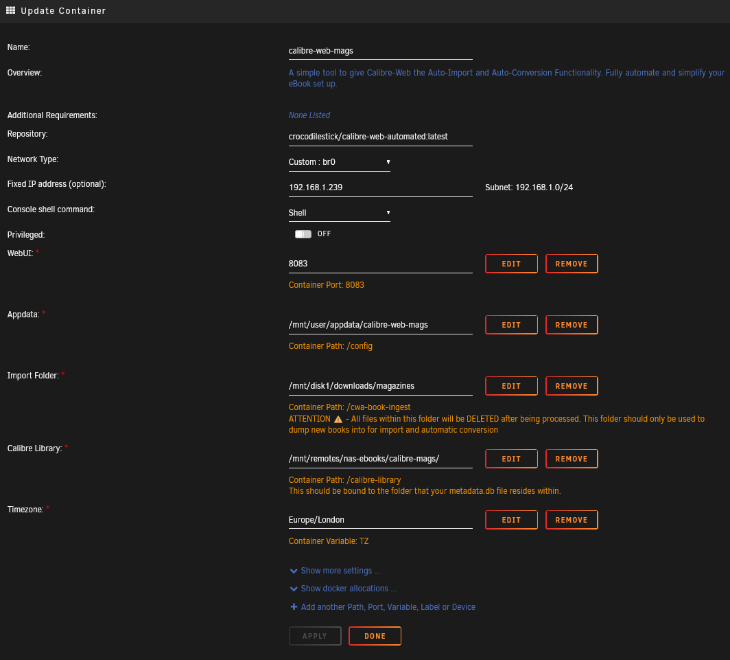

Hello, I am using Calibre-Web-Automated, when I try to download a book I get the following:
Error 404
Not Found
Return to Home
But if I select read, then it open the book fine in the browser, any ideas? thanks
@LondonDragon
Are you accessing it by IP address or through a reverse proxy?
Could you post a screenshot of your template too?
1 hour ago, JPDVM2014 said:
@LondonDragon
Via IP only at present for testing.
Screenshot2025-03-03at18-03-54paulo-unraid_UpdateContainer.thumb.png.c5d01e400ced7f802069ee7e6dfaa8ab.png
many thanks
Template looks ok. Anything showing in the logs when you try to download? If it is letting you read in the browser, then the mapping must be right. I'm wondering if maybe it's a path setting somewhere in the CWA settings.
no entries in the logs when the download fails, that was the first place I looked, because it opens fine and it can read the cover file, it's all a little strange! Hence the questions if I was missing something obvious!
Many thanks for the research, I did try a quick google and did not find anything, many thanks for your help and I will just wait for the next update and see :)
