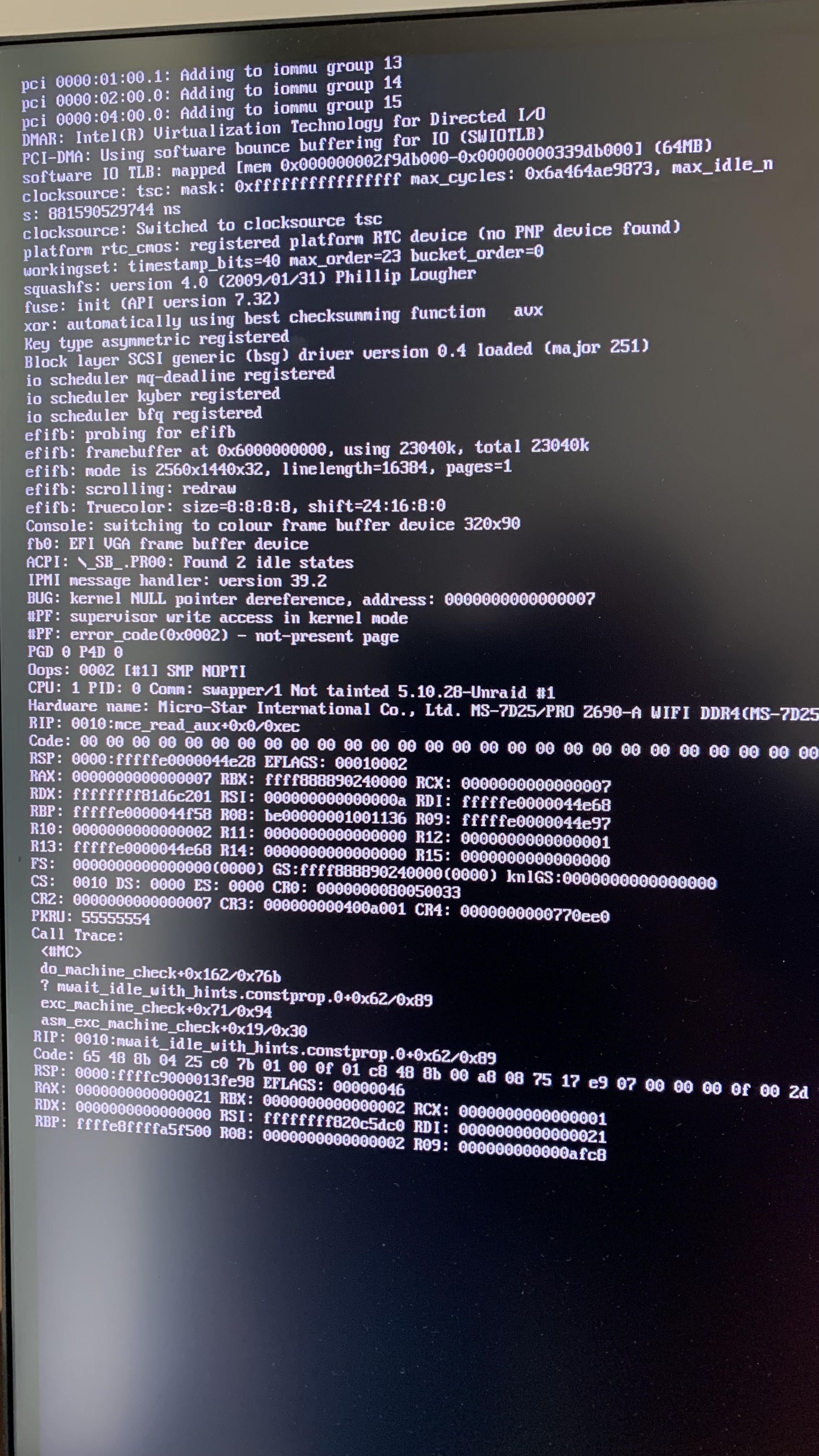

6ED44772-710A-4FDC-AA57-2A3DF1401419.thumb.jpeg.dd8ca05ef062ade4c7b7cf857117d614.jpegI'm getting an initial loading screen after booting from the USB and selecting the GUI mode.
I'm now stuck for about 15 min on a screen that shows a lot of regarding my hardware - I'll try and include a picture.
What should I do next? Is something going wrong?

I tried a different USB stick and now the installation is moving a bit further, the load screen has disappeared but now I get a black screen and it's not doing anything anymore..
I created the USB via the UNRAID creation tool and also ran the .bat file to make it bootable.

Still not a reason why my screen is still black on the server
Might not have the driver for this recent iGPU ?
What version of Unraid are you using ? 6.9.2 or the latest 6.10.0RC4 ?
I am using the 6.9.2 - my DP cable was indeed in the GPU and not the iGPU but after retesting - still no image
