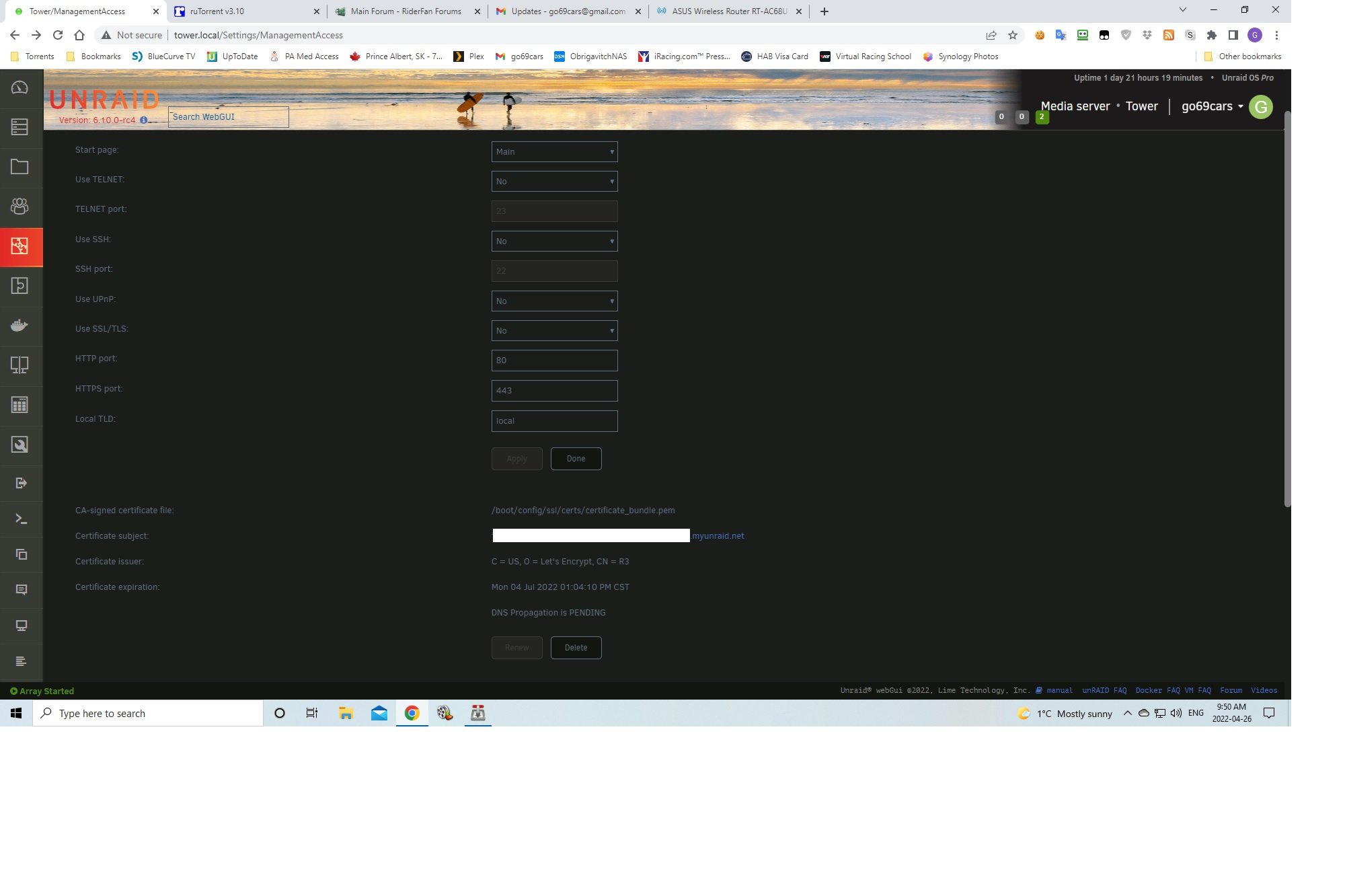

go69cars Posted April 26, 2022 Share Posted April 26, 2022 (edited) Hello I'm trying to connect with My Servers and am getting stuck I have configured it appropriately I think. When I took this screen shot it had DNS propagating, but that isn't showing up any longer. I checked the port and get a green check mark When I try to connect via remote access it won't connect and I get this error on the bottom of the page - DNS_PROBE_FINISHED_NXDOMAIN I checked the link on the My Servers page on DNS checker and got checkmarks all over the globe. I also did a DNS Lookup on that same page and it points to my IP, but it has a message there in small print - IP blocked by dnsbl.spfbl.net I'm not sure what my next steps are to get this Edited April 26, 2022 by go69cars added more information Link to comment

go69cars Posted May 3, 2022 Author Share Posted May 3, 2022 No the DNS propagation is pending is long gone It just won't connect with remote access. If I go onto the my servers page and click on Remote Access it spins for awhile then I get this message This site can’t be reached Check if there is a typo in xxx.xxx.xxx.xxx.hash.myunraid.net. If spelling is correct, try running Windows Network Diagnostics. DNS_PROBE_FINISHED_NXDOMAIN Here is a picture showing that everything seems to be setup correctly. The port checks OK [removed image for privacy - ljm42] I've also attached a new diagnostics file tower-diagnostics-20220503-1236.zip Link to comment
