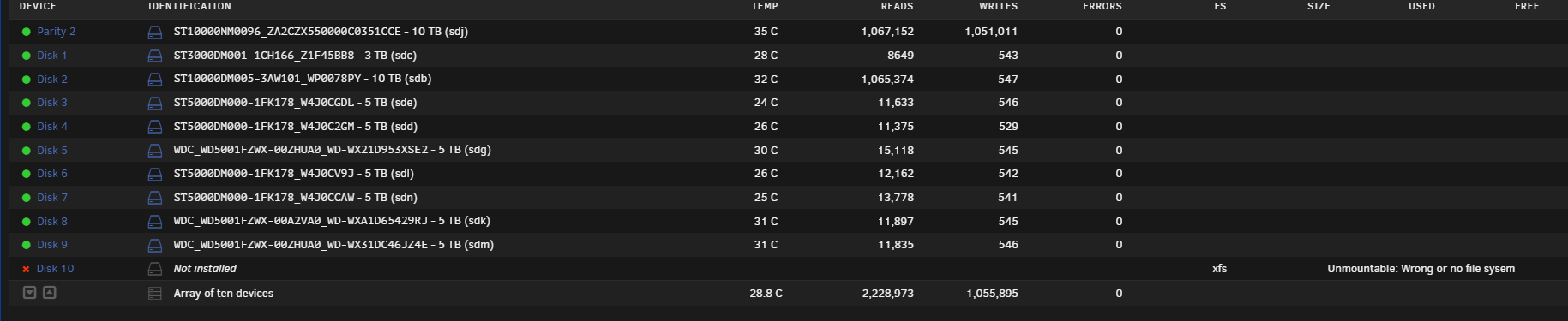

few nights back, opened up unraid and found Parity 1 and Disk 10 disabled,
both are Seagate SAS Exos helium 10 TB drives. less than 2 years old.  Installed 3 of those that day.
the third is parity 2.

took array offline, removed the 2 disks from the config,  was about to clear disk 10 from unassigned drives... but stopped and wanted to verify the data on disk 10 is being emulated on the array..
IT IS NOT.
WTF?
Parity 2 is still alive? where is my emulated disk?

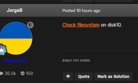

10 hours ago, JorgeB said:
Check filesystem on disk10.

How do you know its  emulating?
If I open my "rootshare" on my windows machine, i cannot find files that were on disk 10.
should I not be able to see those files if it is emulating the missing disk?
if I mount Disk 10 as unassigned drive, i can see the missing files
or..  do i need to rebuild disk 10 for the files to be availble?

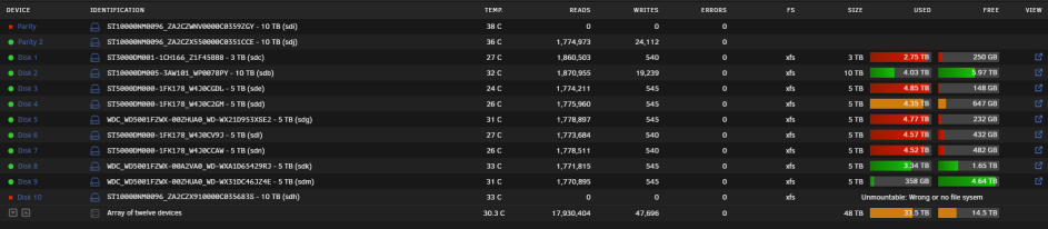

There's filesystem corruption on the emulated disk, once you fix that by running xfs_repair without -n it should mount and you'll see your files, I don't know how to explain that more clearly to you.
corruption on the EMULATED disk?
OH.. i thought you wanted me to correct the DISK, not the EMULATED DISK
that makes more sense.
Edited by TRusselo
Yes, disk10 in the array, currently being emulated because it's disable, is the one with filesystem corruption, that's why it's not mounting and any data there is missing from the user shares.

ok ran repair, stopped array, started array in maintenace mode....
still showing unmountable?
is there any more steps to take?
yes. start array - NO maintenance!
After fixing it you need to start in normal mode.
Thankyou.  emulated files are back!
New drive installed to slot10.
rebuilding now.
Thank you again!
