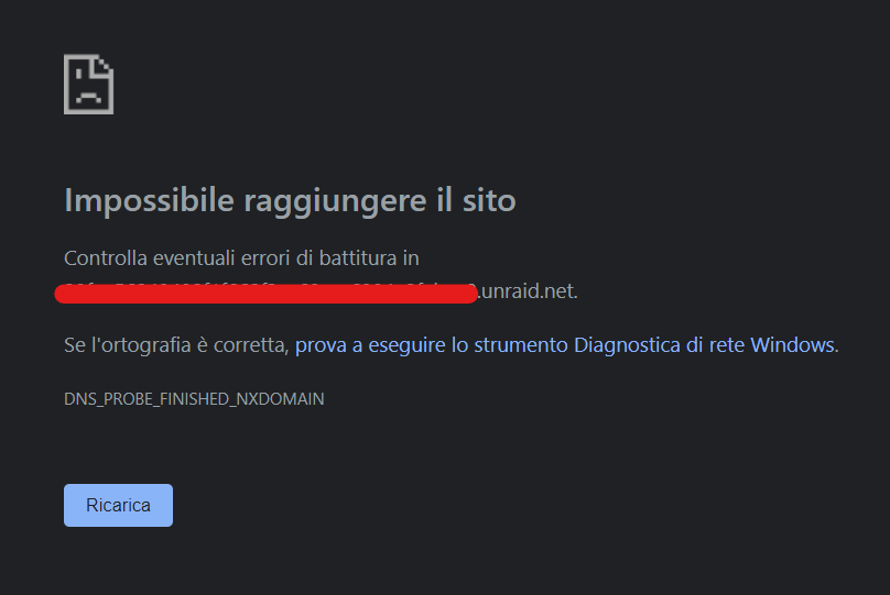

This morning i remotly updated my server to 6.10.0-rc5, before the restart also updated both "My Servers" and "Nvidia drivers" plugins, then remotly restarted but it never became available again.
When I came back home hours later, I plugged in a monitor and saw that it was stuck, tried to shut it down and then forcedly did it by holding down the power button.
Waited a minute, restarted and it completed the booting screen, giving my usual IPs, but I can't reach neither locally nor remotly.

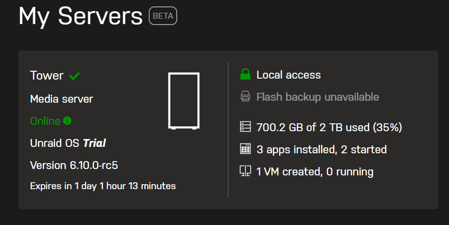

At first also My Servers was unreacheble, but now I can, it shows it as online and working, also I'm able to reach and use both plex and pi-hole that I have in two docker containers. but the server itself keep giving me errors.

By setting pi-hole as DNS, I managed to connect to the server. So, does anyone know why after the update there were DNS problems? In the modem/router setting there wasn't any change
