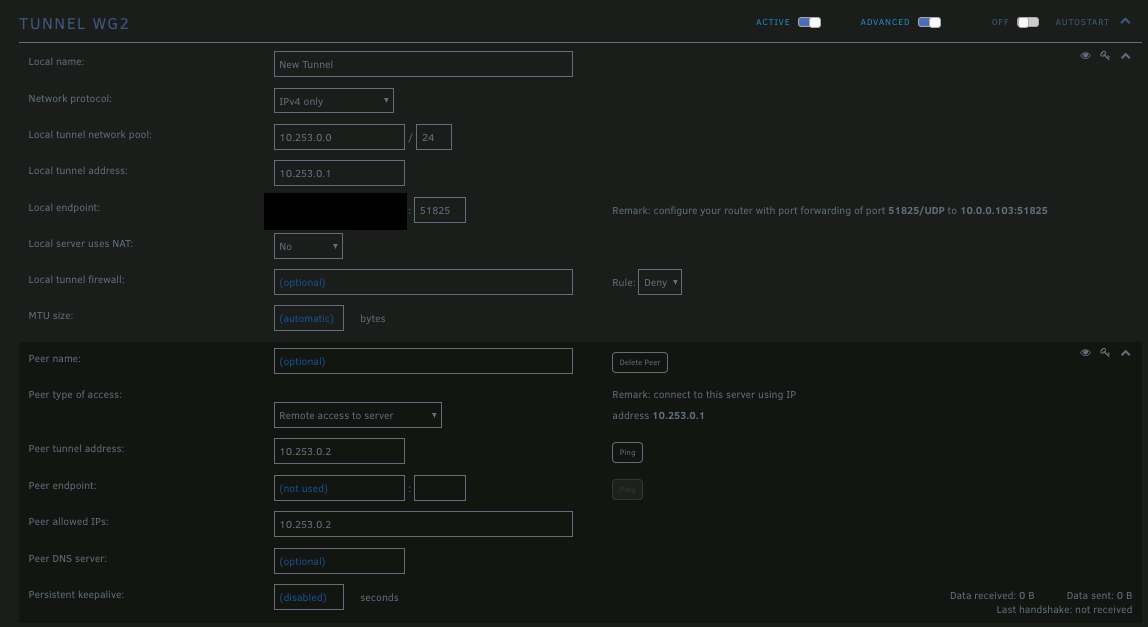

Experiencing the same issue here. I'm facing an issue where my wireguard server (plugin) is not working, and I guess that the "two devices with the same IP" may be the cause. If anyone finds a solution, please share.

Are you using the VPN manager in settings? I thought the wireguard plugin got depreciated a long time ago. I'm running WG without issues. If you are using the sam check your config against mine. Also assuming you've done your port forwarding on your router as well?

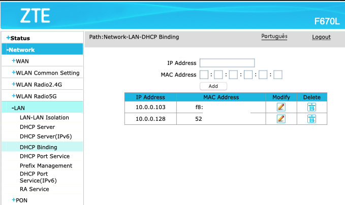

@AceRimmer thank you for your attention already. I've restarted the router and now the shim-br0 mac address is not showing up in the router's topology screen - which seems like a good thing, I guess.
Indeed I am. Sorry for the confusion.
I have docker containers and VMs I want to access remotely. I'm considering using a wg server in a RPi instead - even though I wouldn't like to maintain a second device.

@AceRimmer I contacted the network provider and found out they had migrated me to a CGNAT infrastructure.
He was kind enough to put me back to my old setup - and that was it!
Sorry for the trouble, and again, thank you very much for taking the time. God bless you.
