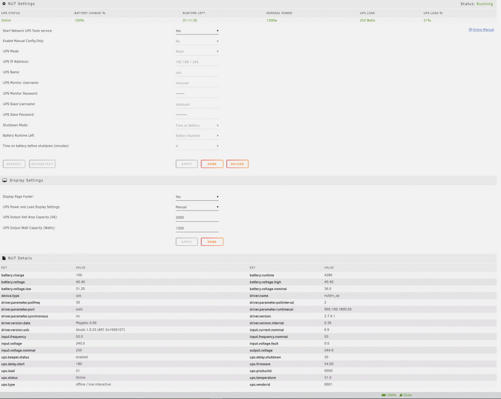

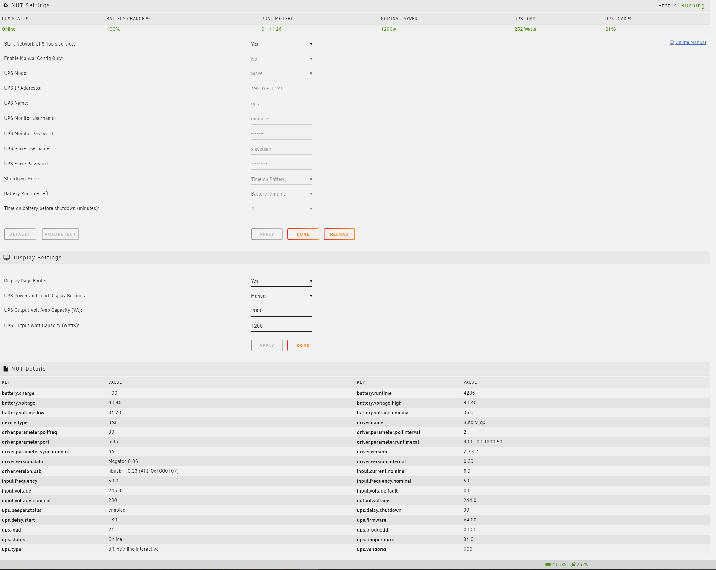

How did you connect this? USB? I plugged it in via USB but my unraid is not seeing it.
Yes USB cable.

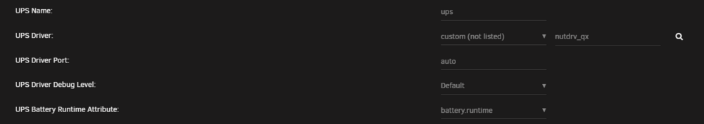

Bus 002 Device 036: ID 0001:0000 Fry's Electronics ATCL FOR UPS
Driver
Also added additions to config file.
