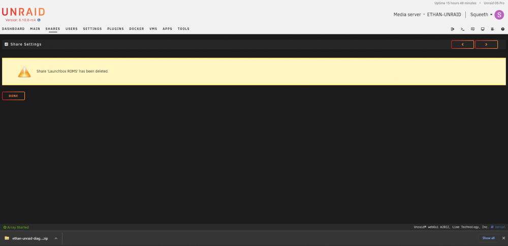

Hey all, had a weird issue occur at some point recently (I can't pin-point the day) where I got this weird message when trying to view a share.
Not quite sure how or why this happened, and it's the only share that I have with this message. I can't seem to find much information regarding this error on the forums, or a solution for that matter. It's still accessible on my computers as a mapped drive, which has me very confused as to what this error is and what it means. I did try to restart the system a few times, but no luck getting rid of that message.
Thanks in advance for any help, and let me know what other information might be needed.

I took a look on my Unraid flash drive to verify the share still exists, and sure enough it still does. I cross checked the .cfg file of this share with my other shares in /boot/config/shares and sure enough everything is the same. Quite boggled by this one.

Thanks for the response trurl! The share .cfg file is named "Launchbox ROMS & ISO's.cfg", and matches the same (I can assume) in the Shares tab by showing "Launchbox... ISO's". The confusion continues with the fact that when I click the link for that share in the Shares tab, it shows the screenshot in my original post with the name "Launchbox ROMS".
If I go to any computer in my home network and type in my Unraid systems IP address, it does show the full share name "Launchbox ROMS & ISO's" (matching the shares .cfg) with all the folders and files present inside of the share.

Thanks to the suggestion made by @JorgeB to rename the folders on the disks, it now works! I used Krusader to browse and rename on the disks, and afterwards confirmed that once adding in the "&" character, the share went back to "deleted" again. Interesting!
