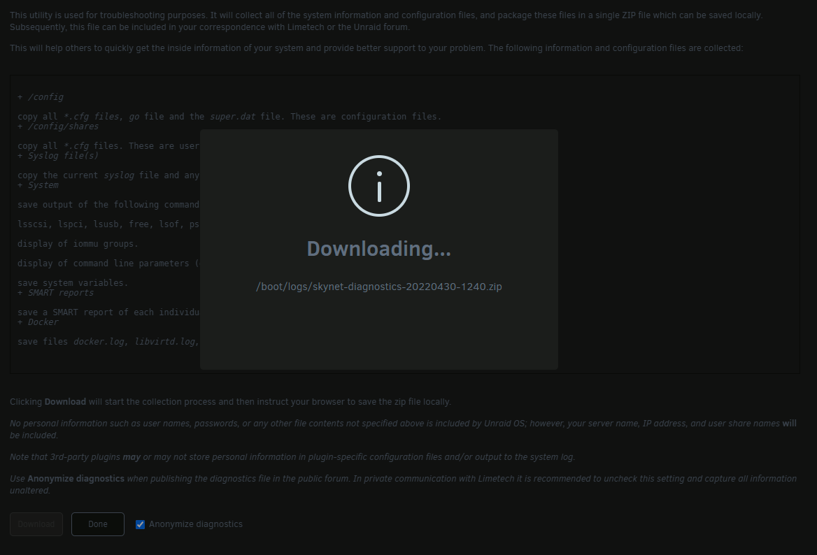

That was the first and smaller issue. The big one is that I can't activate the flash. When I want to go to the page where you can replace the key it's just empty with nothing on it. I also can't download the diagnostic since it is stuck on the following screen.
