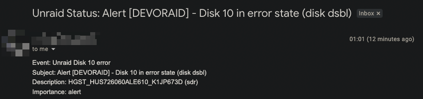

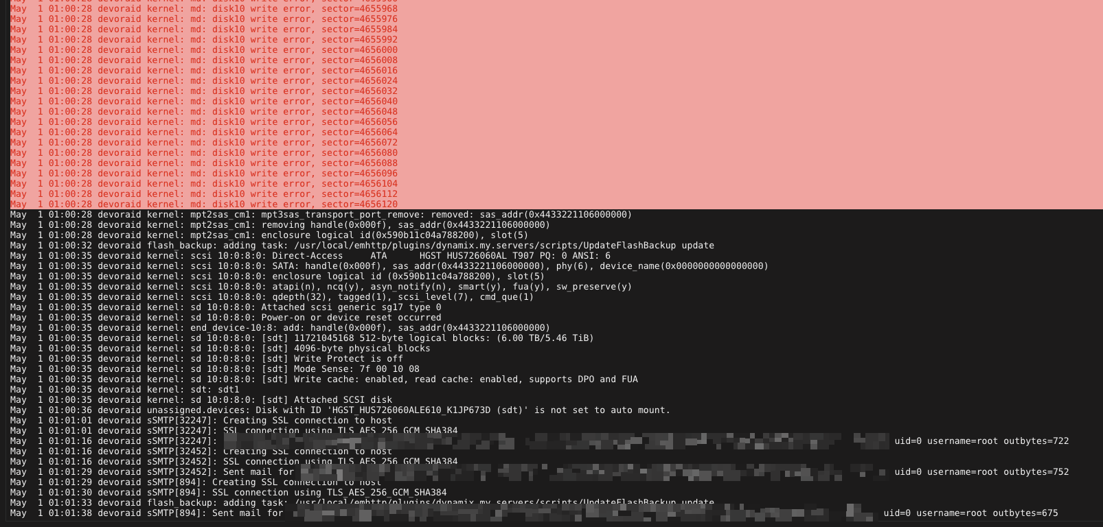

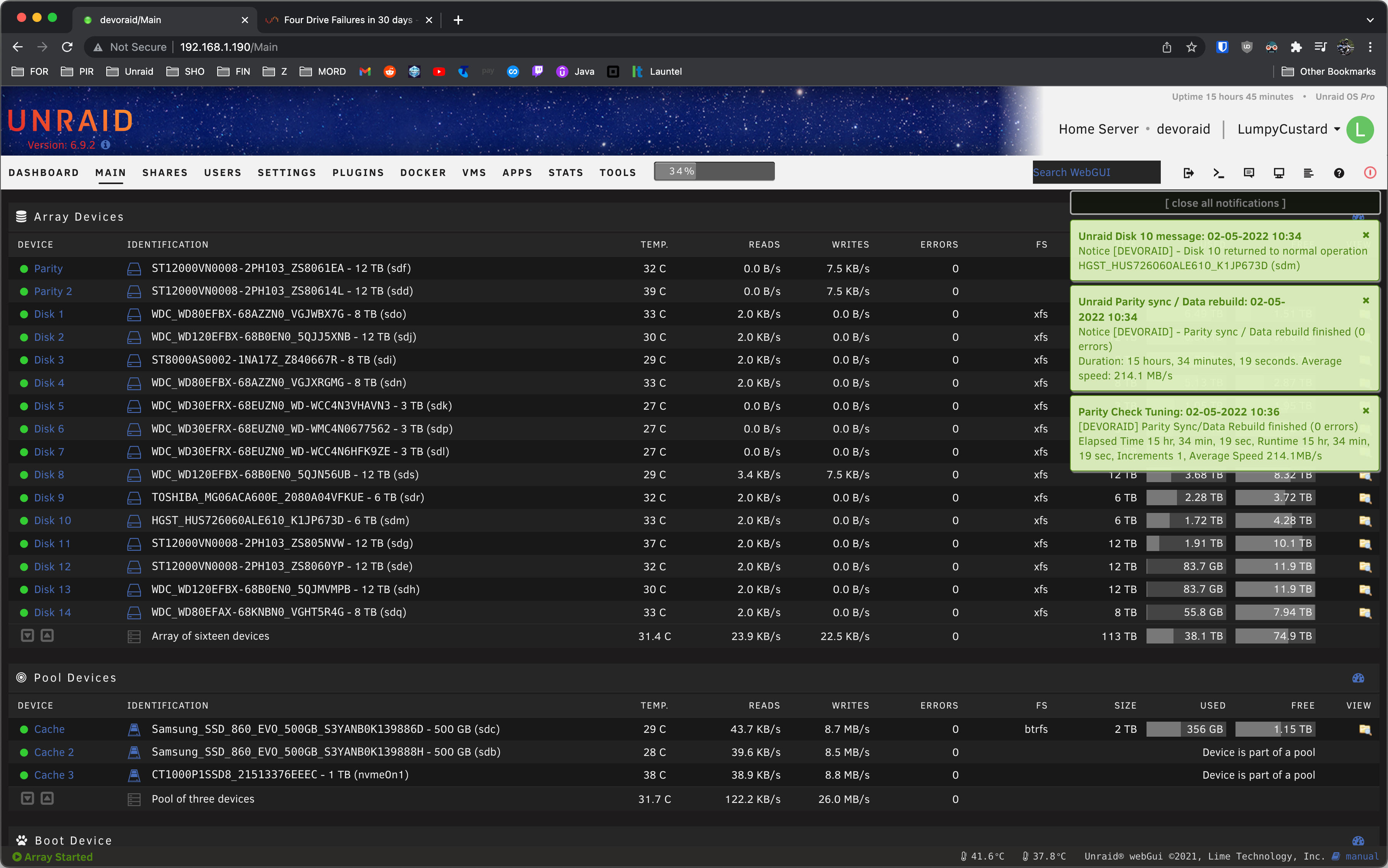

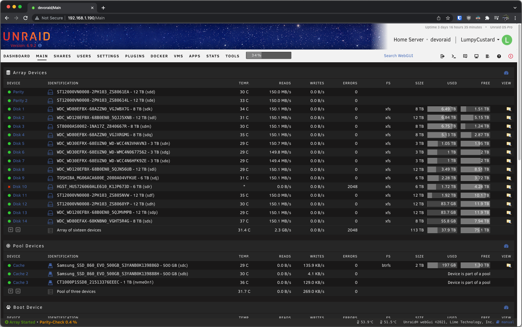

I have used this opportunity to replace each disk with brand new 12TB drives. The array rebuilds fine and everything works as normal then all of a sudden i'm met with another error. Tonight i was browsing community apps, with the server doing nothing strenuous, and an alert popped up.
The last time this happened i turned off my server, reseated all cables, added the drive back in, and it instantly failed.

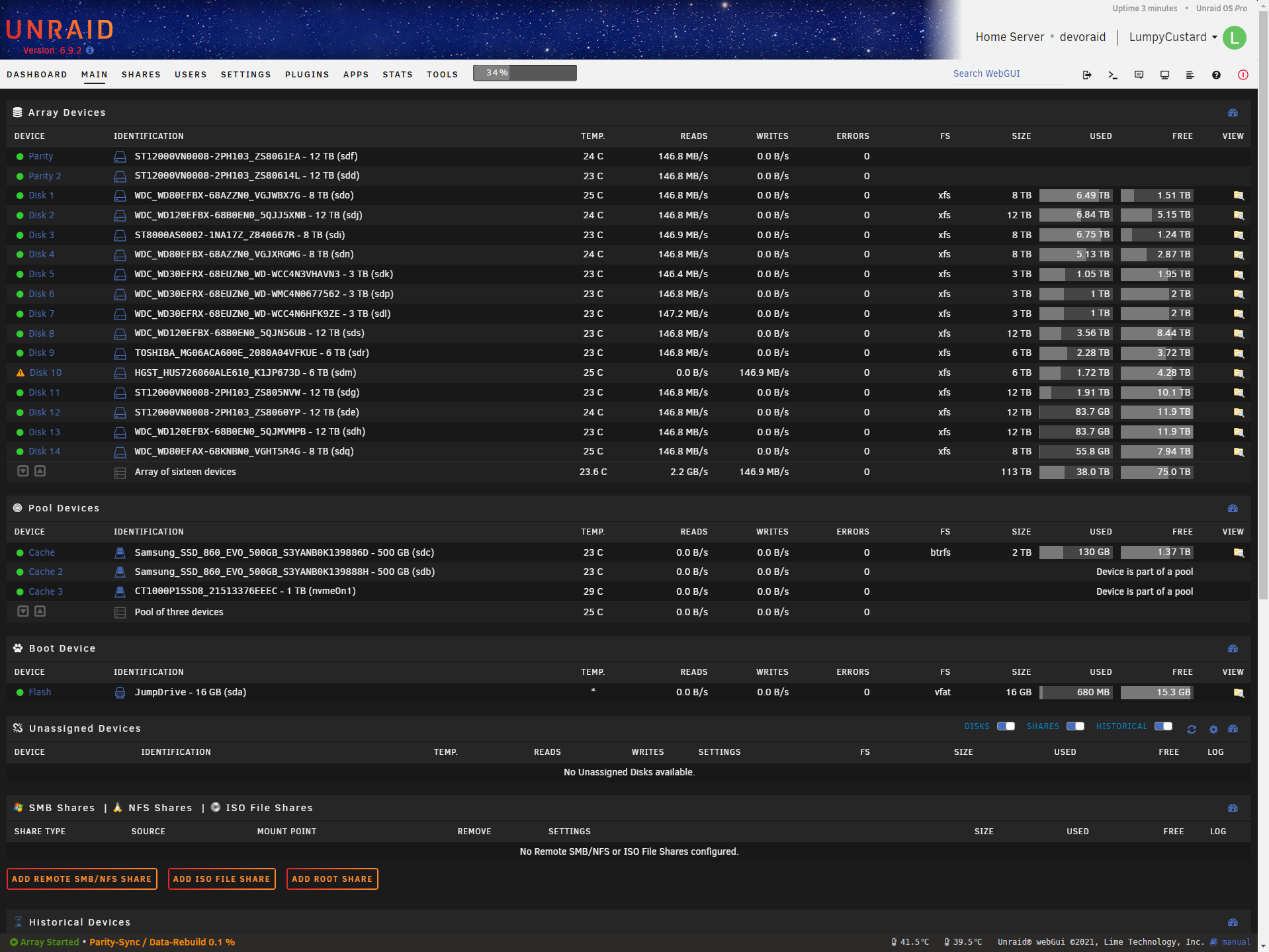

Disks: See attached screenshot for drive list.

You can see in the screenshot in my first post that the server had been up for 3 days 16 hours.

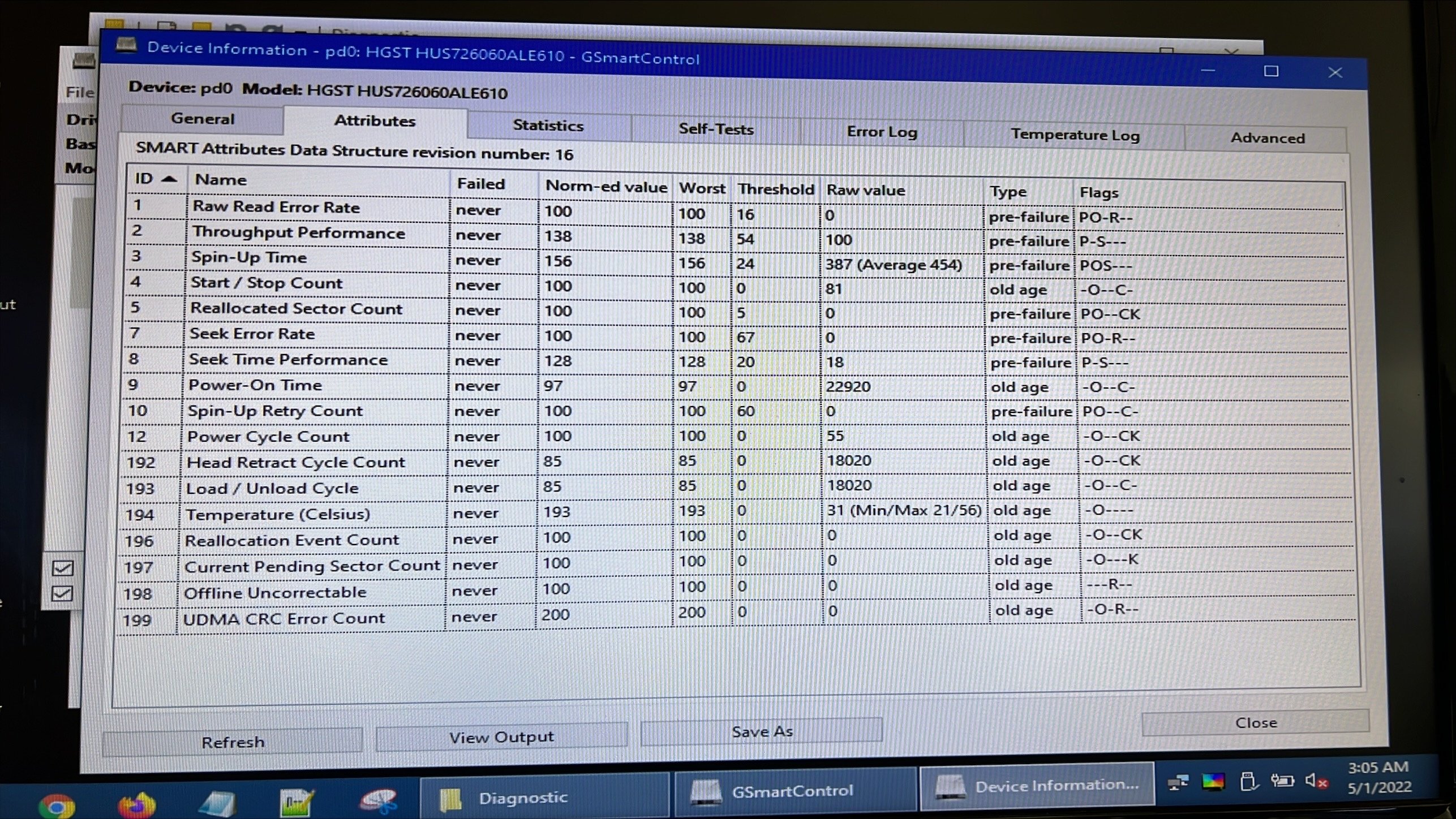

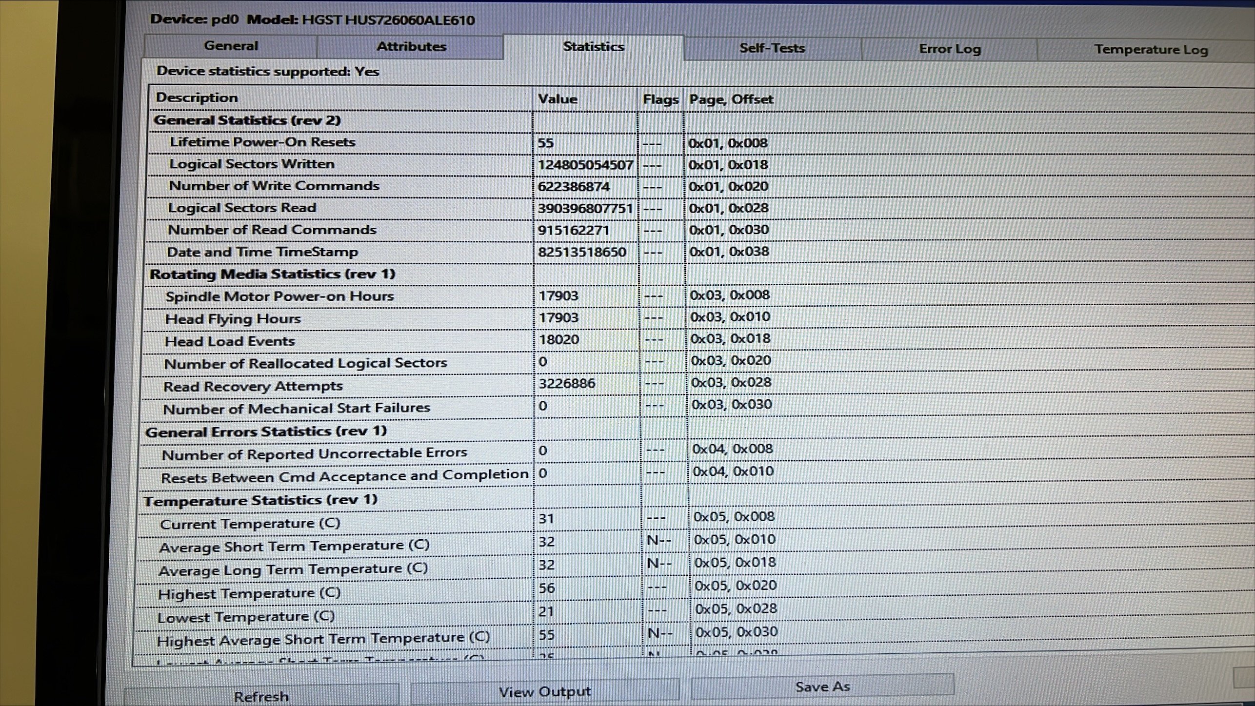

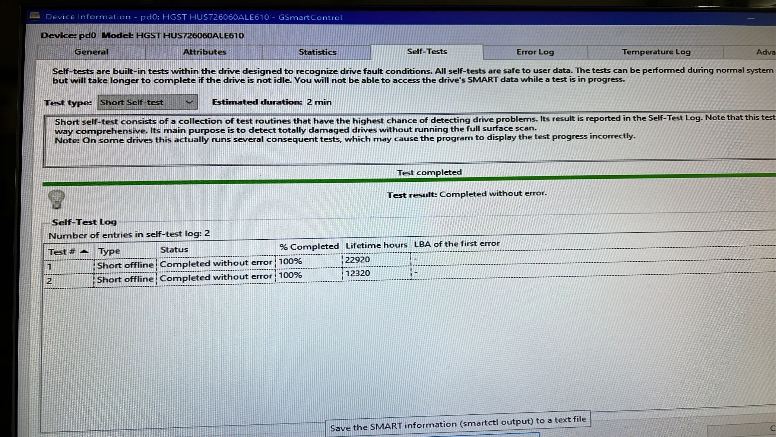

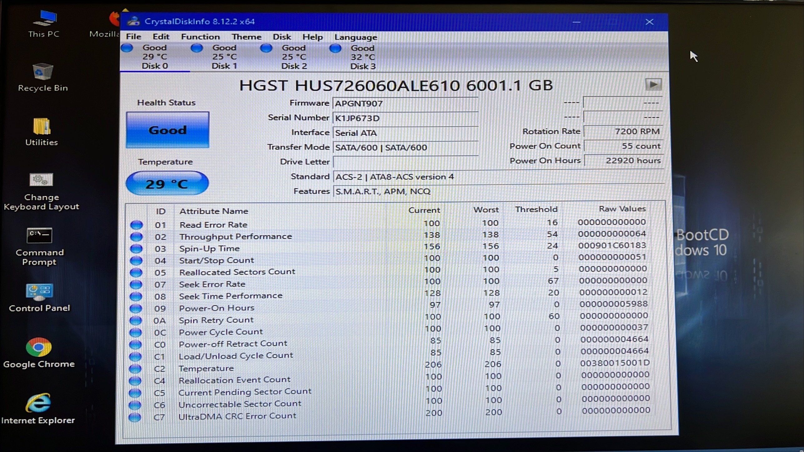

Alright i've disconnected all HDD's, connected the "bad" HDD and booted up into Hirens to check SMART info. Unfortunately i can't upload screenshots since the server is running in a PE environment so please excuse the pictures.
I've run a short self test and it passed, and all SMART info seems to be fine, aside from it just being an old drive with a lot of power on hours.

Alright after testing for a while and the drive passing all tests, as well as testing the exact sectors that unraid flagged, i've decided to replace the PSU in my server.

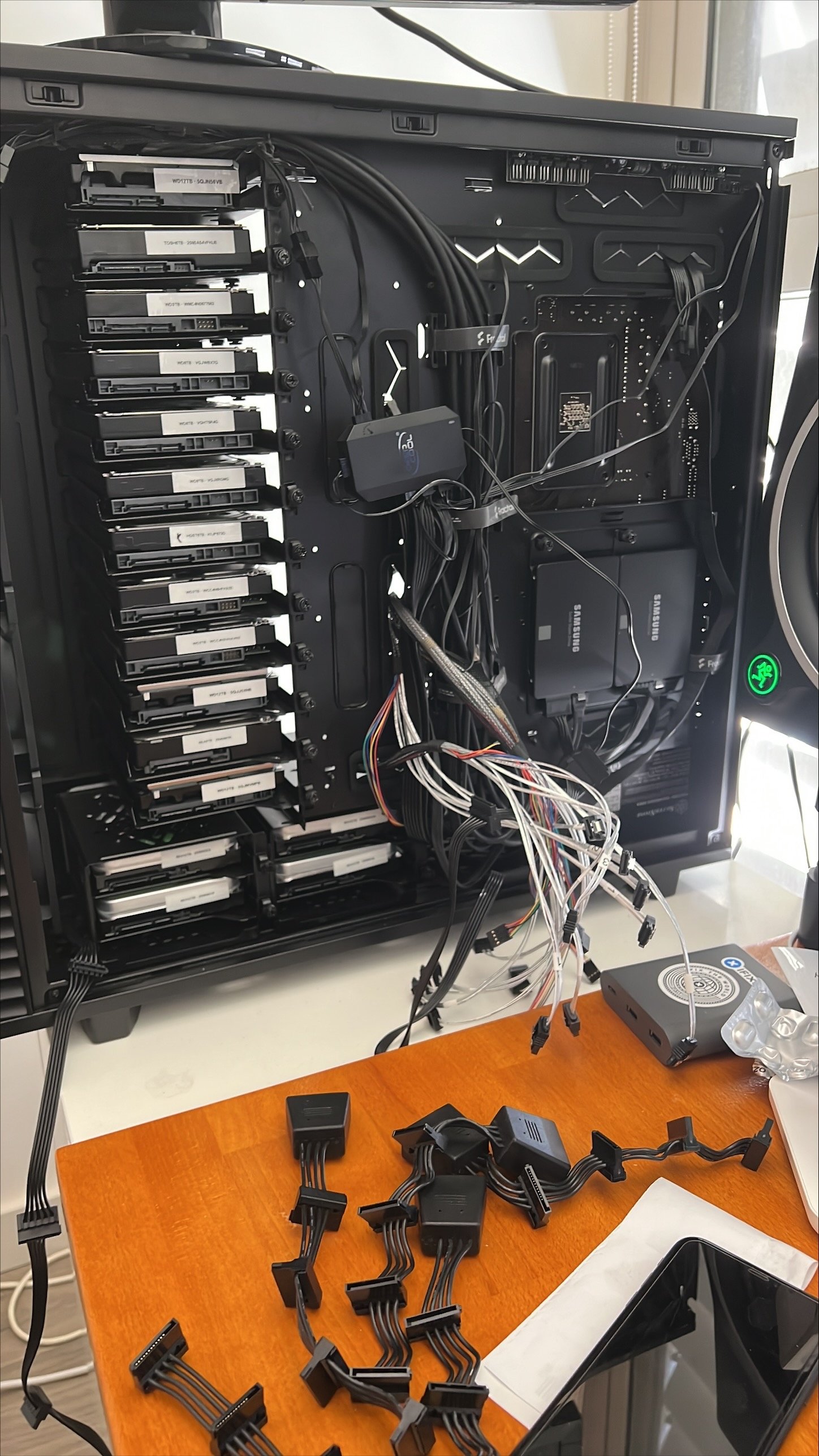

$280, a new PSU and CPU cooler later i've reinstalled everything.

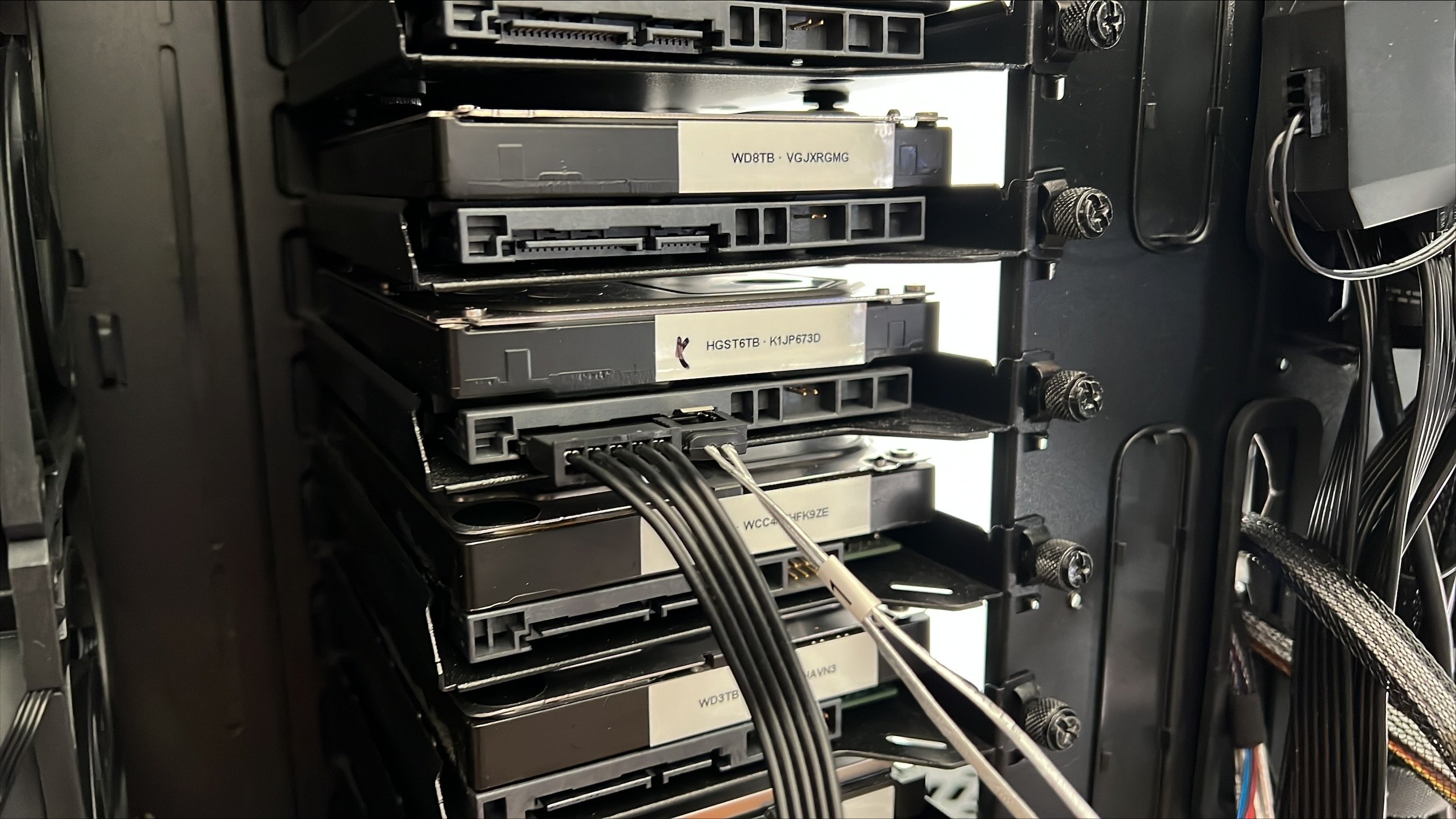

I've connected 4 or 5 HDD's per cable without the need for splitters except for the last 4 HDD's which i've used a splitter to connect 2 SSD's. The power draw of the SSD's should be negligible.
Server is rebuilding using the "failed" disk now, will report back with results.
