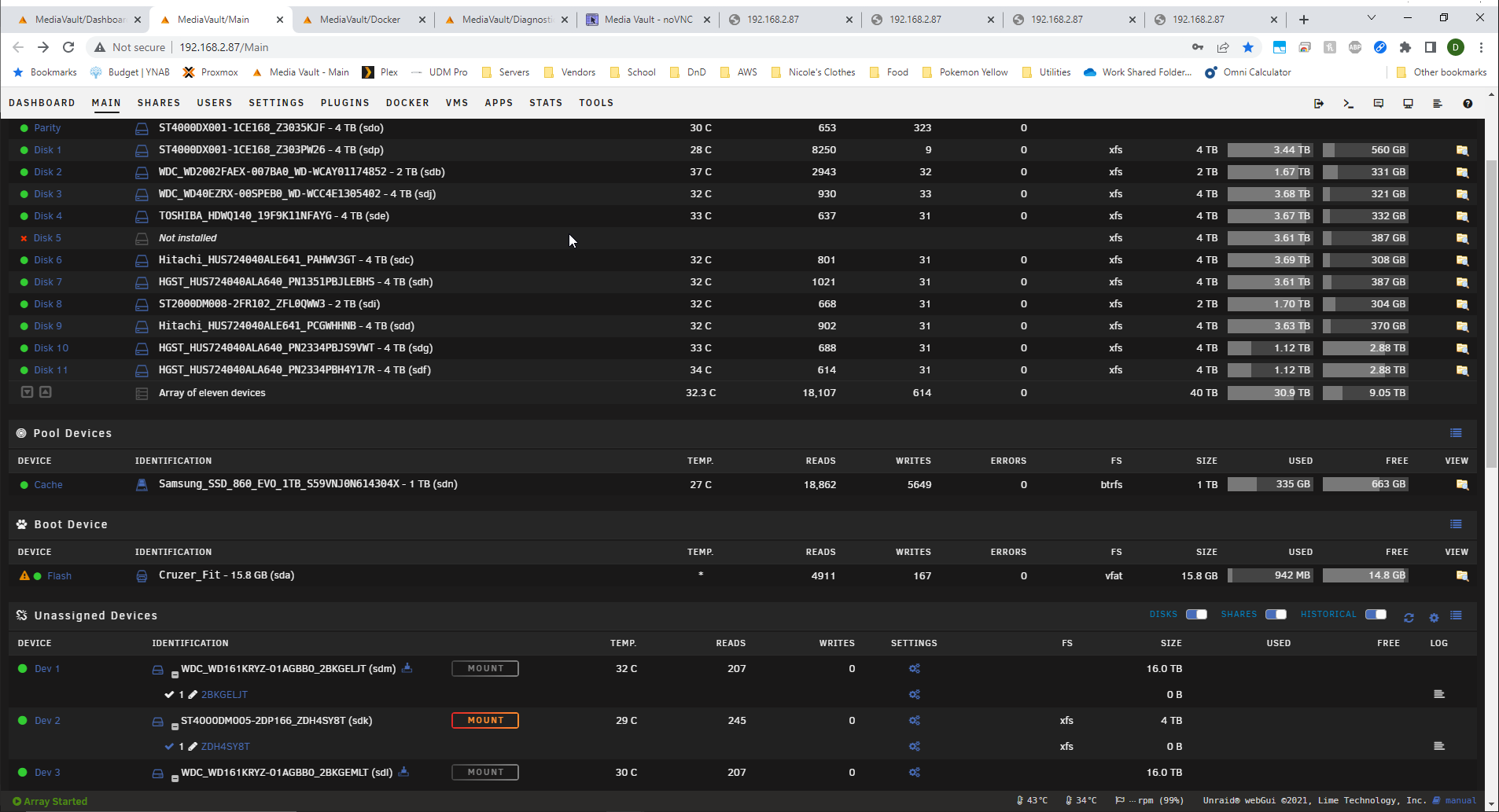

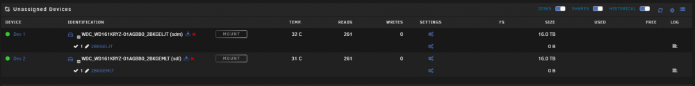

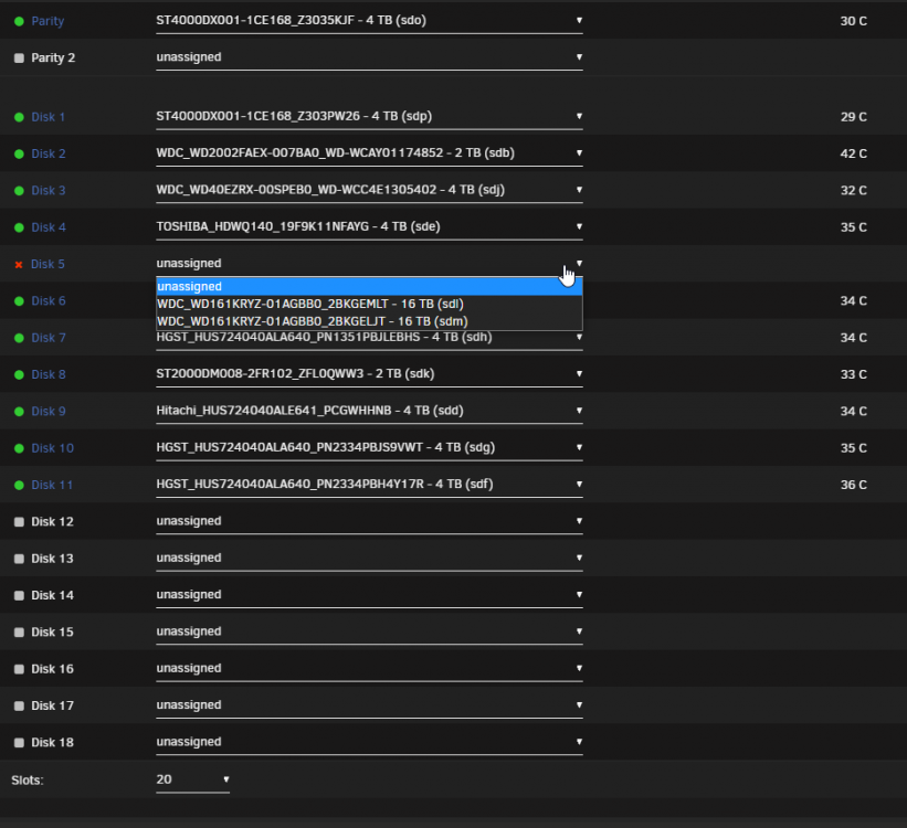

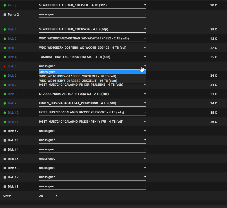

I started the array, and disk 5 is showing that it can't be entered into the aray (see attached). Do I need to let Unraid do a parity sync / data rebuild before bringing that drive back in? I will start the array and see if there are more CRC errors.
Please post current diags, disk5 was enable in the previous ones.
That screenshot is Unassigned Devices saying the disk is an array disk. You have to assign it as disk5 in the array

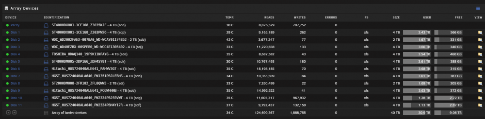

Post a screenshot of Main - Array Devices
New diags attached. Array is currently stopped, does it need to be started?
The disk was previously in the array but Fix common problems was showing "unable to write to disks 4 & 5 - drive mounted read only or completely full". When I stop the array and attempt to select that disk, I can't choose it from the drop down. Main - array devices (screenshot attached).
mediavault-diagnostics-20220504-1106.zip

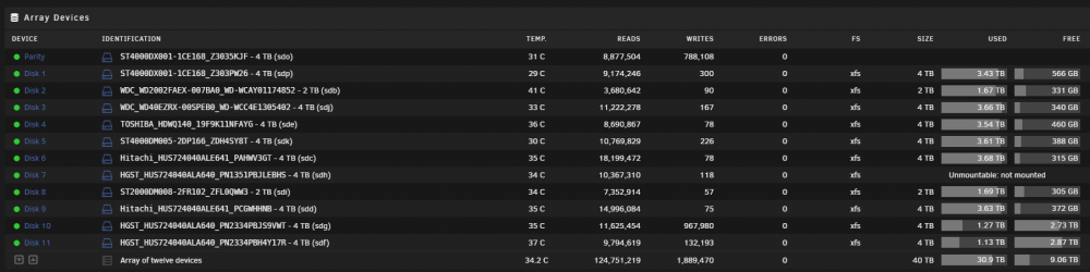

Edited by Arcaeus

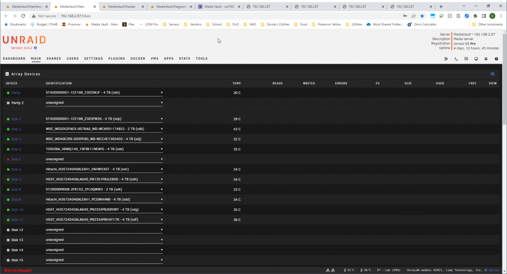

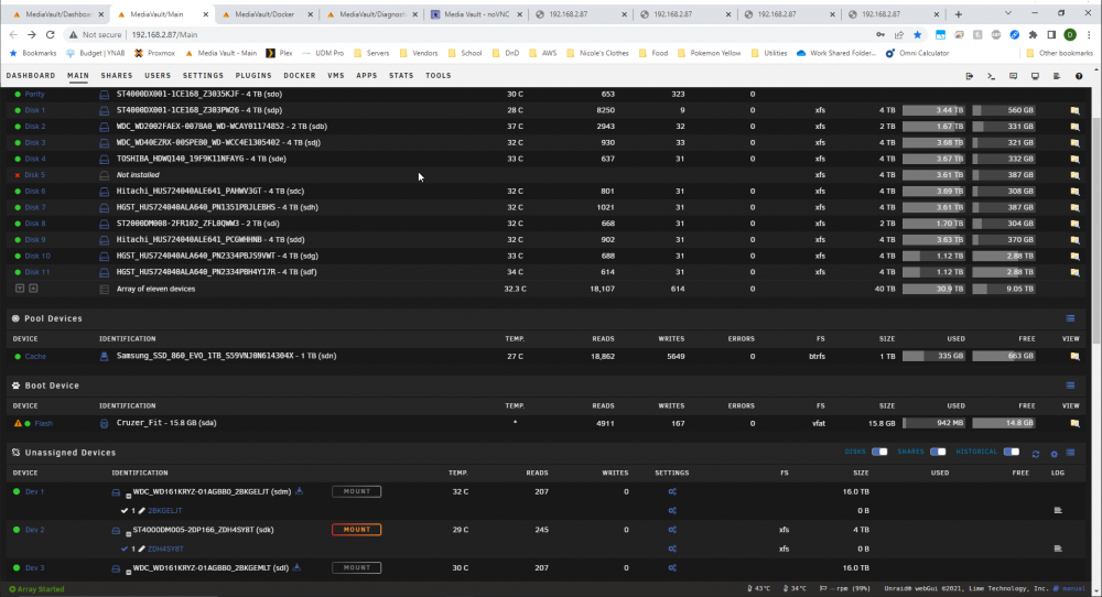

Start the array with disk5 unassigned and post new diagnostics so we can see if emulated disk5 is mountable.
SY8T (sdi) isn't giving SMART report. Looks like it has disconnected.
Got it. Array is started, new diags attached that were ran while the array was started.
mediavault-diagnostics-20220504-1116.zip
So this is interesting as I believe it was connected and working since I pulled out the other drive. Only after stopping the array and assigning the new disk to the array, then starting it up again did it start throwing a bunch of errors.
I can shut everything down and confirm that all the cables are connected properly if you think that may be an issue?
So far no CRC errors yet, but I don't think anything is really hitting the disks so I'm not sure.
Emulated disk5 is mounted and seems to have a lot of data, but syslog also indicates filesystem corruption.

Ok, all connections have been checked. SY8T was connected to an HBA card SATA connection, so I swapped that for a direct SATA cable that went to the motherboard SATA ports. Now SY8T is in a SATA connection to the mobo, QWW3 (currently disk #8 ) is connected with the HBA card SATA connection.
When I logged in, SY8T showed 1 CRC error on startup, but have not seen another one yet. Unassigned Devices shows it as mountable (see attached).

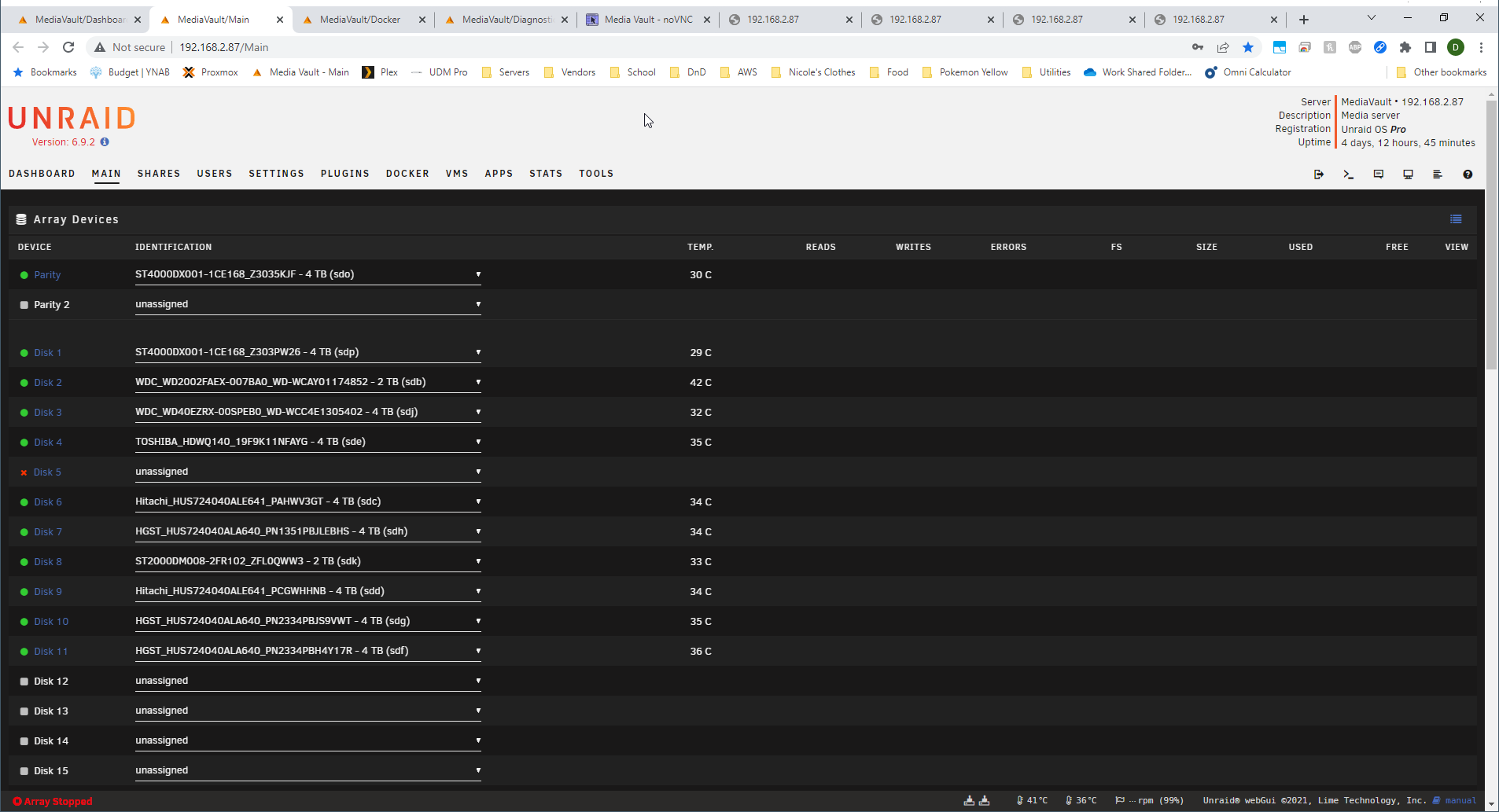

And to do that I'm assuming that I need to stop the array and restart it normally so the disks mount, correct?
Yes.
2 minutes ago, Arcaeus said:
restart it normally
yes and make sure you leave disk5 unassigned
