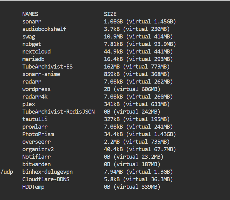

I found this command ``docker ps -a`` (IMG1) and see that the sizes might be OK.

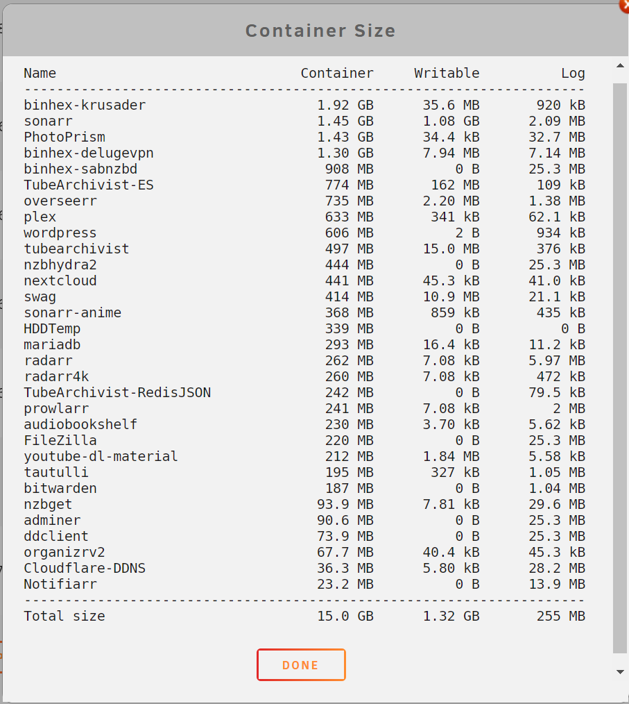

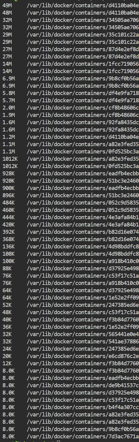

I got help at the Data Hoarding discord, but was told to ask here as he was just not sure what the issues was. He helped me gather some more information though. I used ``docker system df`` and it shows not a lot of space being used (IMG4). We also looked at the logs to see if that was causing the large space usage, used this command ``du -ah /var/lib/docker/containers/ | grep -v "/$" | sort -rh | head -60``, but I don't think so as most logs were under 50MB  (IMG5) . I also found that I can check the container size right in the docker tab and it seems to look fine. There was a high number in Writable from Sonarr, I assume that is not good, but its still not 100GB (IMG6), maybe someone can tell me how to lower that if I really have to?

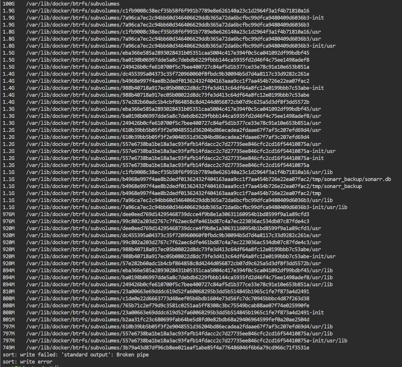

I also found that this directory, ``lib/docker/btrfs/subvolumes`` has a bunch of large folders, 340 folders to be exact. I do not know what this directory is used for nor do I know what is in it and if I need it or not. I was able to find some large folders/files (not sure what output this is but IMG7 shows it) with command ``du -ah /lib/docker/btrfs/subvolumes | sort -n -r | head -n 50``.
