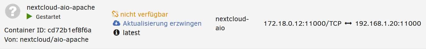

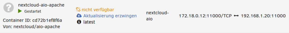

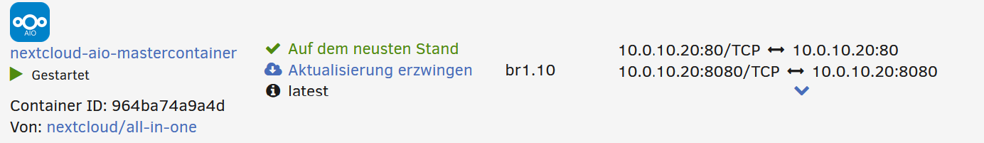

December 23, 20232 yr Hi, as allready explained in the German Forum, i wanted to have acces to nextcloud via my DMZ-vlan. I activated the subnet inside docker settings to a second nic wich is vlan tagged. So the AIO Master Container (and NPM) got an IP from the DMZ subnet: But after starting the Subcontainers, apache and talk do listen at the same IP like the host, who is on the management subnet, blocked from public by firewall: As you can imagine, theres is no conection possible with this configuration. Does anyone have a solution to bring the subcontainers (apache and talk) to the same subnet like the mastercontainer? Happy hollidays Sparky Edited December 23, 20232 yr by Sparky_Ol
