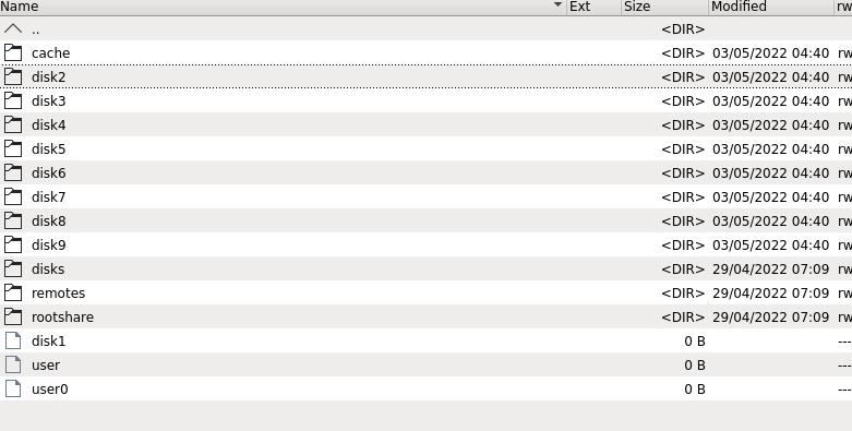

Today I started Plex to watch a show, and it couldn't find any of the shows I chose.  Looking at the share in Windows, it only showed 2 TV show folders in that share.  Perusing the drives using Krusader, I can see the TV folder in several drives, and see many series in them.
However, when I look at the DISKS folder, disk1 is not showing as a folder, it is showing as an unknown file type with 0 bytes.
How should I proceed?

Looks like a connection problem with disk1, check/replace cables and post new diags.

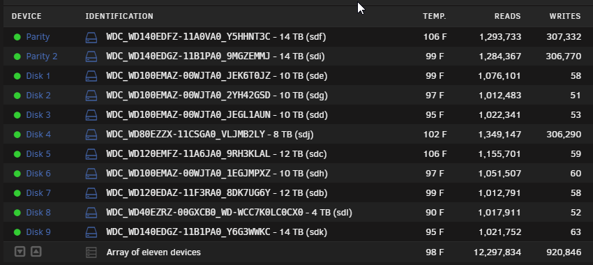

Interesting thing: during the parity check, 3 drives are doing an awful lot of writing:  the 2 parity drives, and for some reason, disc 4 (now sdj).
Something is writing to disk4
Well, that I figured.  I find it interesting that the byte count is almost identical to the Parity drives, as if it's completely re-writing the disc.
That would be expected as every sector written to an array data can be expected to generate corresponding sector writes to each parity drive.
Duh.  Of course.  My brain is thinking there has been something wrong with the parity, and that it's creating a new parity.  Thanks for pointing out the obvious that I didn't see... :D
