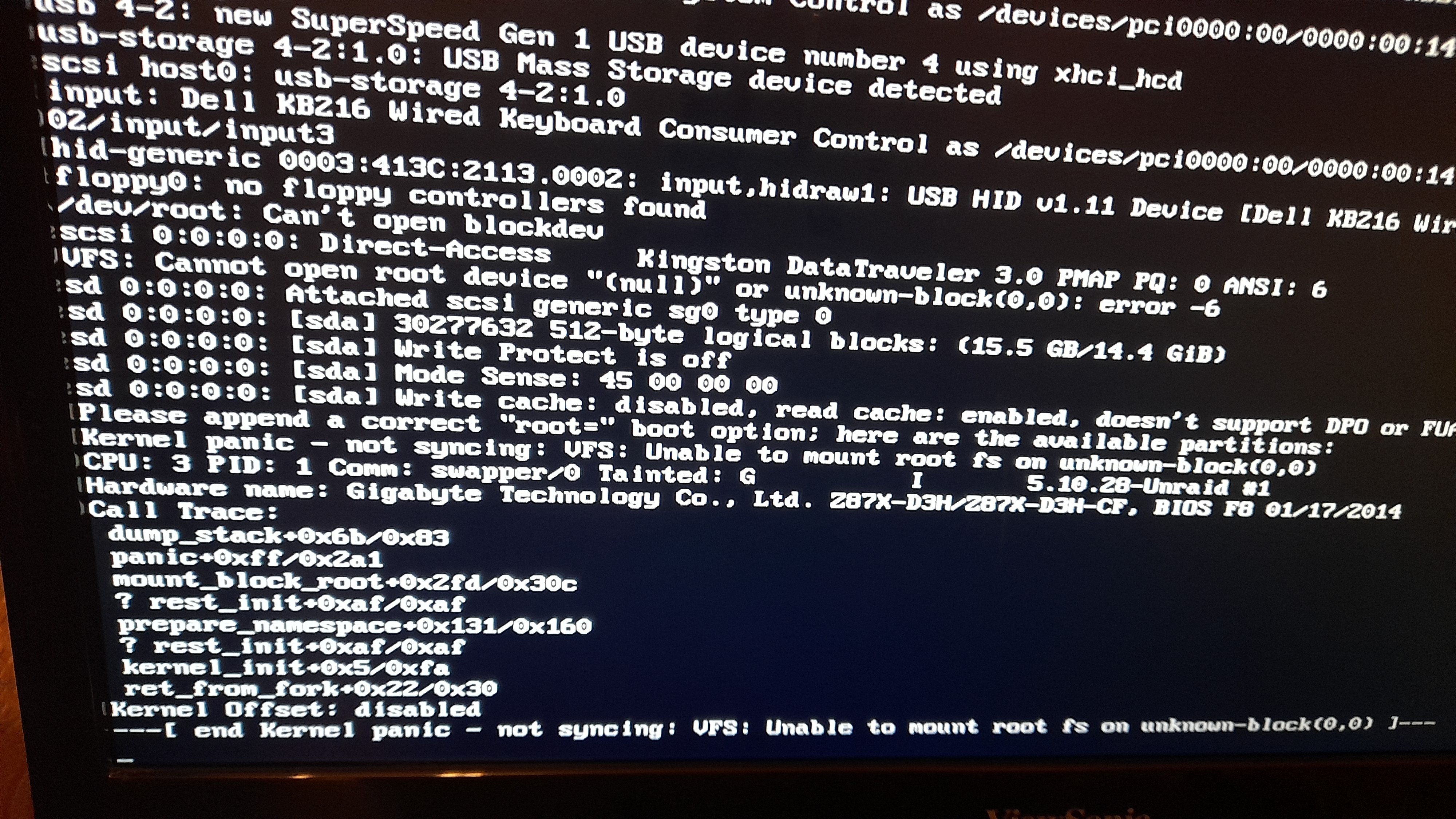

After power loss my unraid server no longer boots up. Stays stuck on this screen:
Any sugestions?
Power down, remove the USB and check the filesystem on another PC.
While you have it connected to another box, make a copy of the config folder, you may need to redo the USB stick and copy the config folder back to it.
Apparently it was the usb stick. I just redid it and copied the config folder over it as I needed it up by morning... This is my 3rd usb stick.... -_- In less then 5 months...
