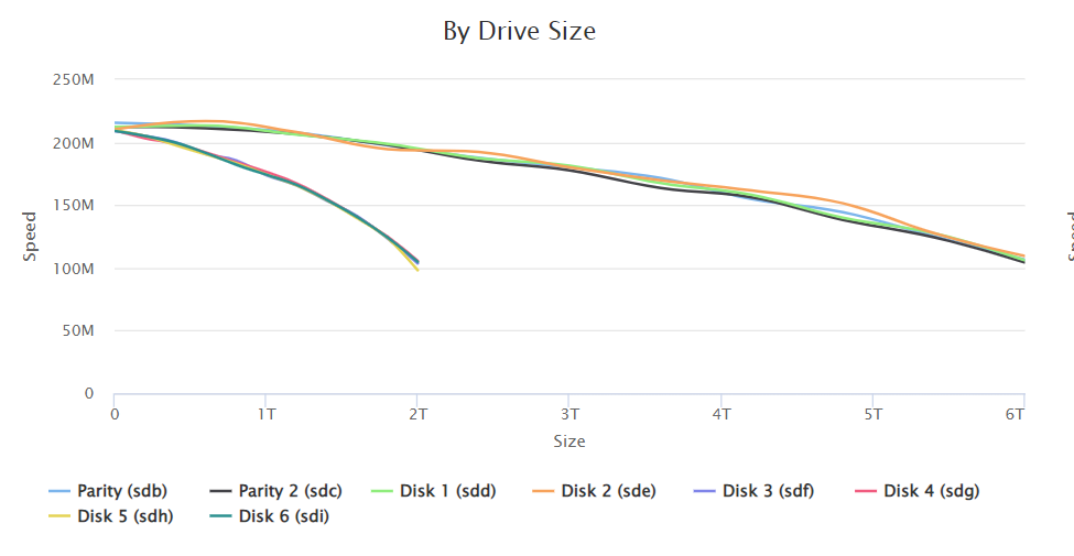

Try testing with the diskspeed docker, it might help identify the issue if it's just one disk/model, unless they are all the same.
All perfect, did it yesterday...

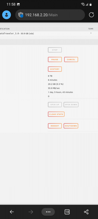

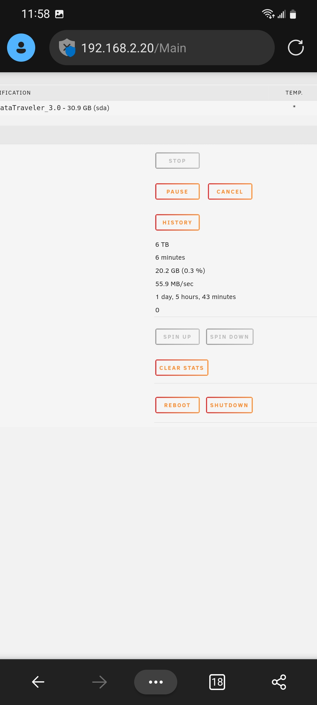

Why did you give us a screenshot showing it has run less than a minute? Demonstrate it is still happening after things settle.

I understand your description just fine. The (tiny) screenshot in an earlier post seemed to show it being slow after 6 minutes, but the description in that screenshot also talks about pausing. Can you give a screenshot that shows it being slow after it has run continuously for several minutes?
