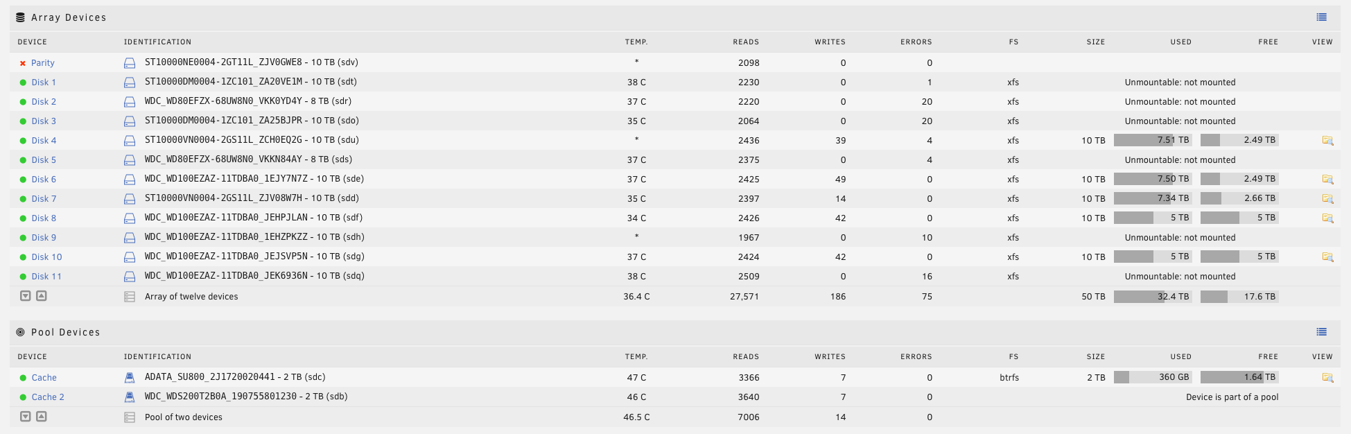

I upgraded to 6.9.2 yesterday but when I start my array 6 of the drives are now unmountable, but are detected, no other settings were changed, upgrade went fine, what is causing this and how do I fix it?
The parity drive is now also not working

Constant errors with the HBA, post new diags after rebooting since can't see the boot sequence on the previous logs.
