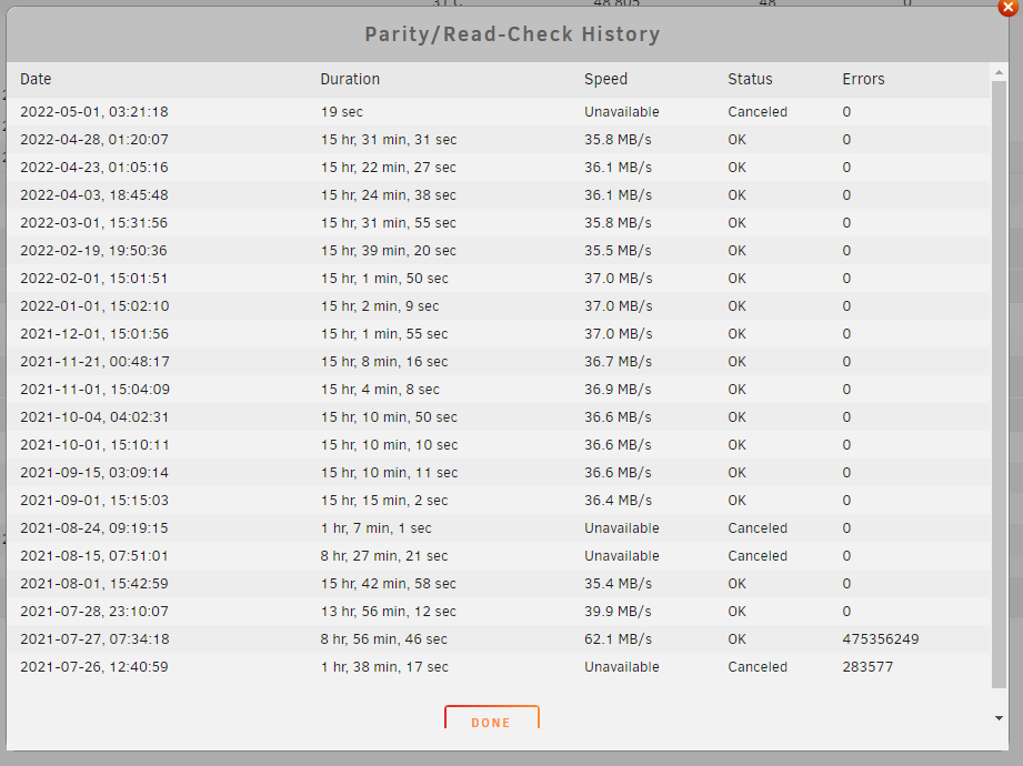

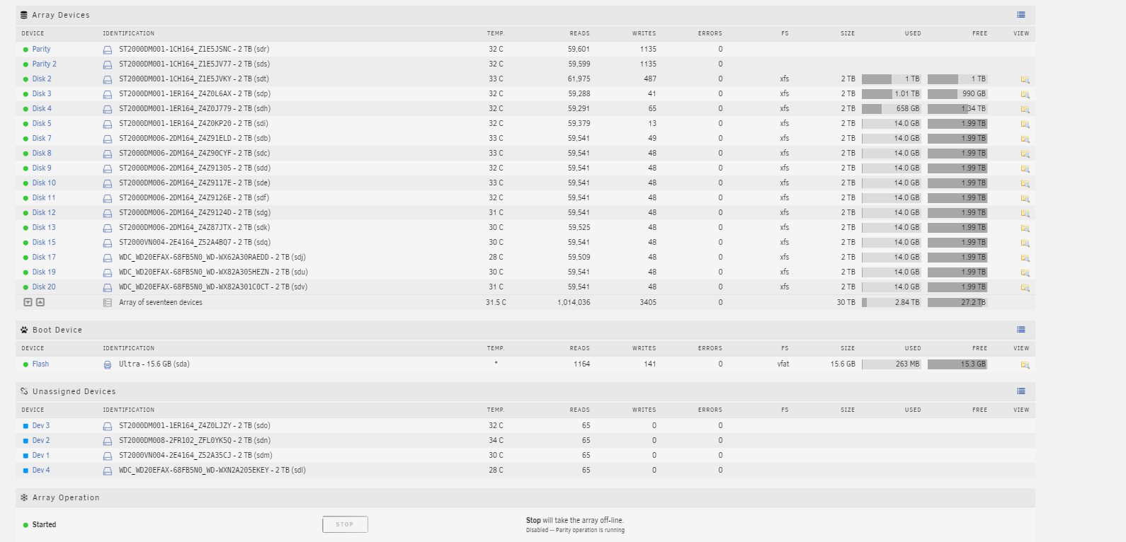

I started a parity check now, but it seams like turning out OK.
Strange, if it was a power/HBA issue I would also expect issues during a parity check.
