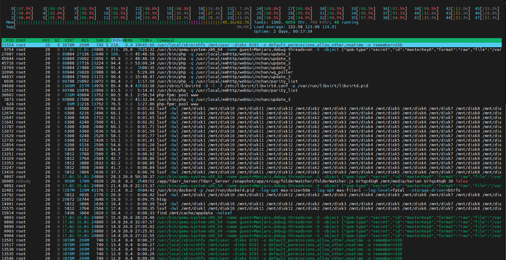

Here a few more stats and infos, all the lsof tasks seems a bit of to me

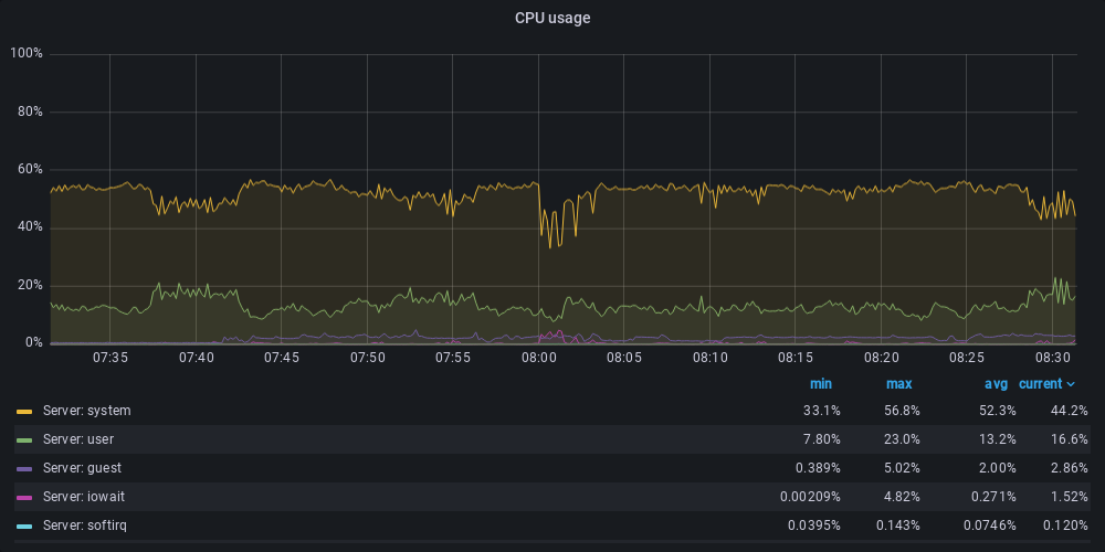

after stopping the docker service webui gets responsive again, but have a high CPU usage, every core about 10-30%, i pinned my cores so when i stop docker service unraid have 16/32 Cores/Threats alone
