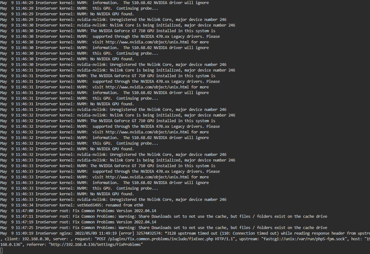

my Unraid server is shutting down (or crashing?) on its own, and it is not rebooting just a shutdown.
i was tailing the log file but there was nothing. it happend a week ago, i turned it on then it happend later some time (within a day), and then i turned it on again and it was still on until yesterday, it shutdown on its own.
i turned it on again today it stayed for like an hour then again it shutdown, it turned it on and it shutdown after like 15min.
any help? i am on the latest stable version. i tried stopping dockers, no difference.
Thank you guys!1523152933_Screenshot2022-05-09115637.thumb.png.7805d373886f05fcbef0dba76251bb8d.png
