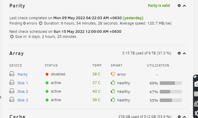

Hello, when i log into my unraid one day, I realized that my parity drive is disabled as following
may i know what is wrong with my system? I have attached the diagnosis report as well.

Disk was already disabled at boot so we can't see what happened, but SMART looks OK, suggest replacing/swapping cables to rule those out if it happens again to the same disk and then re-sync parity.
Make sure you enable system notifications so you're notified at once when there's a problem, or it might be too late.
When you replace those cables, double the connections on all of the other SATA cables-- both power data and power.  SATA connectors are notorious at working themselves  loose when moved.
i did rotate my server from horizonal position to vertical position when i try to remove the fan filter for washing. Maybe it cause the cable to become loose. I try to open up the server casing and check the cable again. 😀
Hello, I have replace the sata cable that is connected to disabled drive. And click on the little cross beside the word parity  to spin up the disk, but it is still showing parity device is disabled.
Power supply is shared with other disk, so i dont think there is any issue with power supply.
May i know what else should i be checking?
