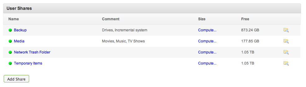

Also, how do I prevent these damn User Shares from re-appearing (see attached)
I'm pretty sure they're generated from Finder.  I've emptied then, and deleted them before, but now they've re-appeared.  Very frustrating.
Don't share the top level of the disk. Make a directory and share that.
I don't, I share Media and Backup, which are at the top levels of disks.  Hmm...

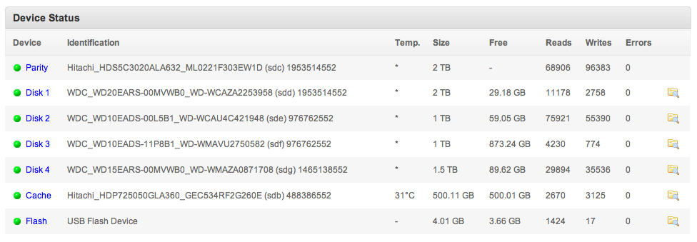

Check the disk setting in the Device column of the Main tab.
Which "disk setting"? Sorry, at work now so can't view my webGui now.
Look at the entries in the Device column on the Main tab.
Everything's normal:
