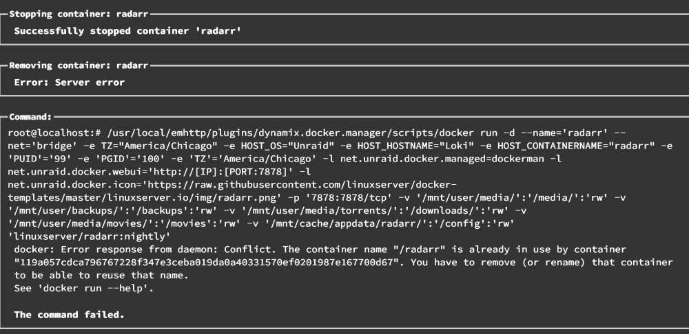

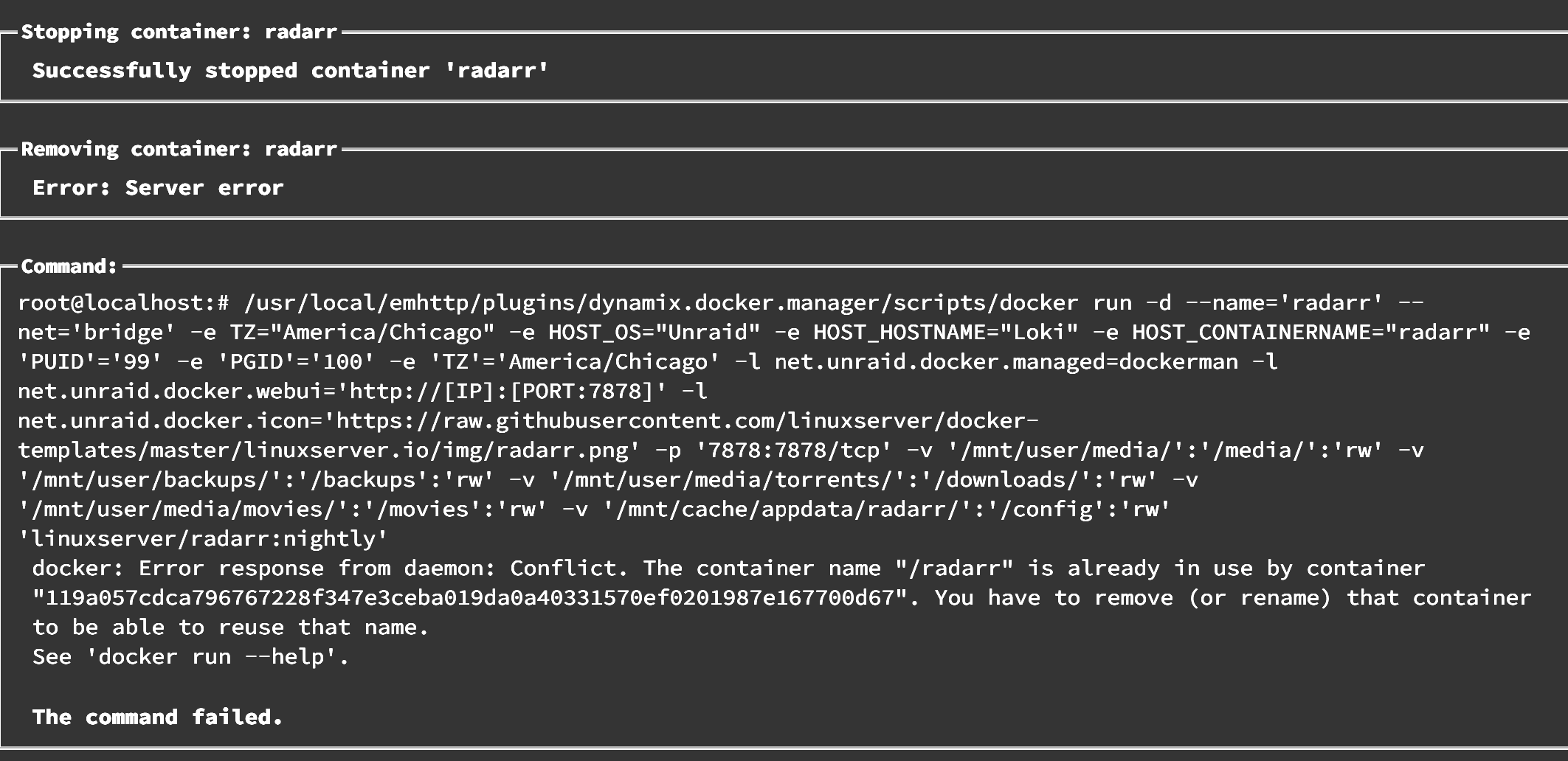

Update All Docker Button breaks containers.

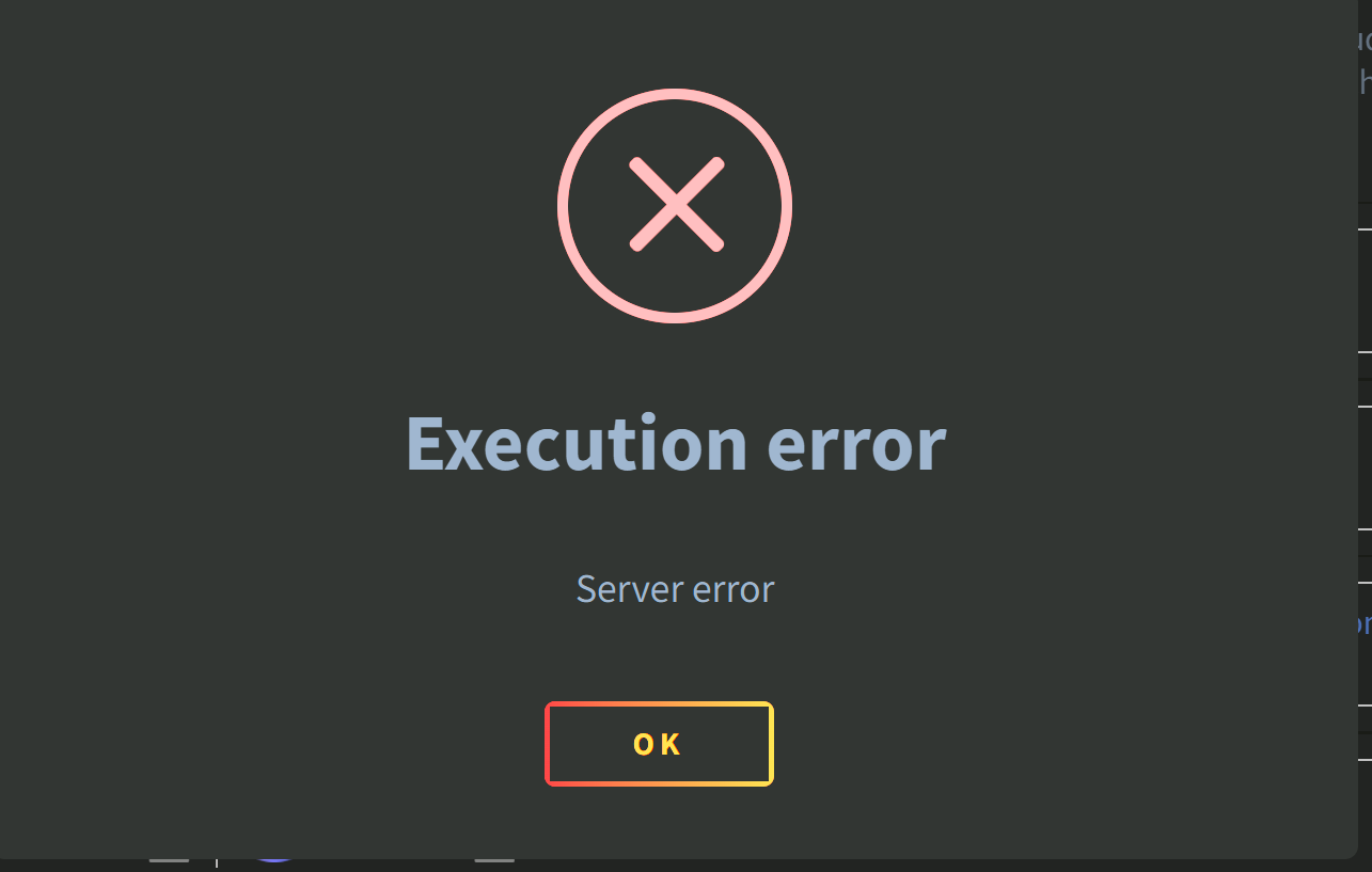

Each time I use the Update All docker button, it fails to remove the container stating that the container is already in use.
 giving a server error. Then I have a ghost container that refuses to be removed.
error.pngserver error.png                                            I have tried deleting the docker.img and rebuilding but the problem keeps re-occuring. The only way of removing the containers is by doing a full restart on the server. The shutdown then hangs when it's trying to unmount the drives. Eventually this leads to a dirty shutdown. Once the server is back up, then the command "docker rm --force "container" " works.
