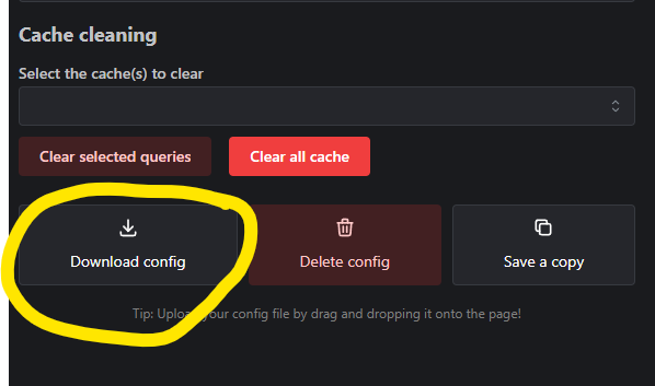

ClamAV detecting a trojan when downloading the config file- anyone else?
