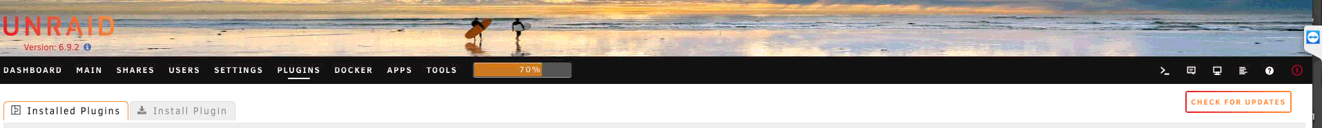

I'm supposed to see some logo on the upper right corner, correct?image.thumb.png.ce0367431ff08b50a23cb8d95bd79a70.png
Odd. Please upload your diagnostics.zip file (from Tools -> Diagnostics).
Also, in your browser press CTRL-SHIFT-i to bring up DevTools, and switch to the Console tab. Do you see any errors?
Thanks for the diagnostics. I don't see anything there that will explain why the UPC isn't displaying, but I do see some troubling messages about disk5. Messages like this are repeated multiple times:

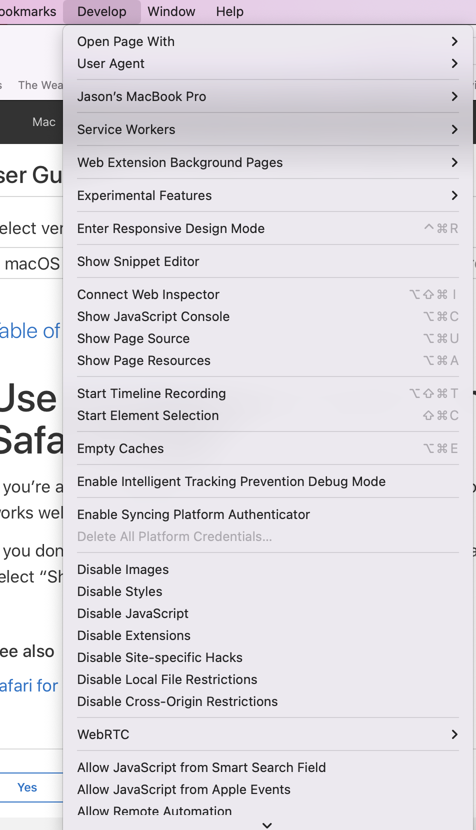

I showed the "Develop" tab on the Menu in Safari.  It shows me a list of drop down choices.  What am I looking for?
ok, it's all clean there :D. No errors.  Don't know what to do next.
