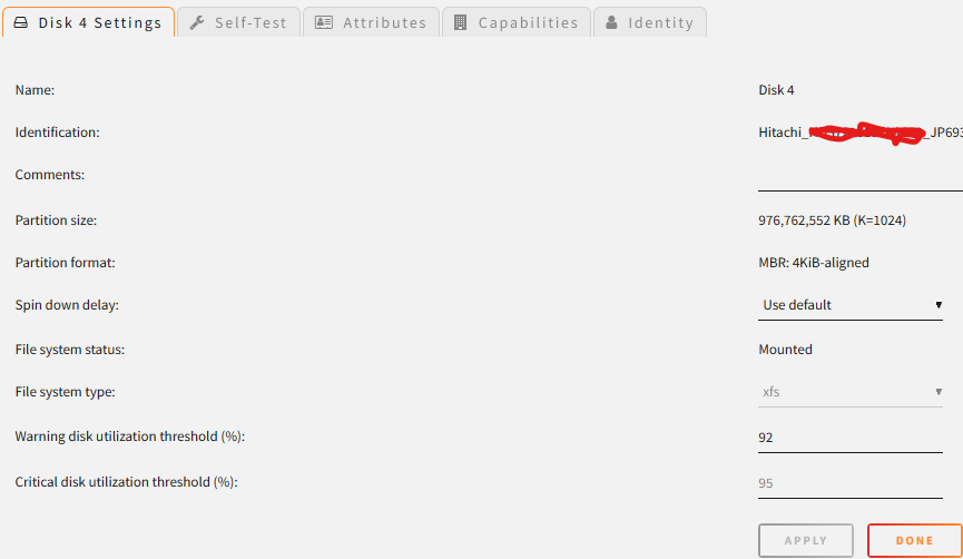

First, look at these two settings under    Settings  >>>  Disk Settings   >>  Disk Settings
Make sure that these percentage settings make sense based on the capacity of the actual disks that you are using.   (5% of a 16TB drive is a lot more Megabytes than 5% of a 1TB drive!)  Also observe that this is the default setting  and that you can change the percentage for each disk under properties.  See here for example:
