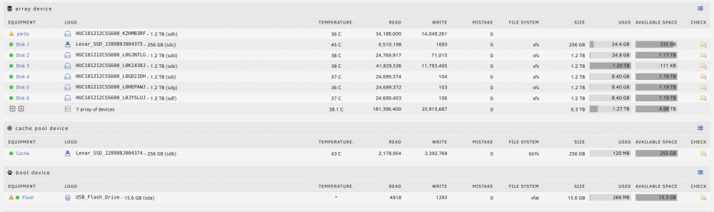

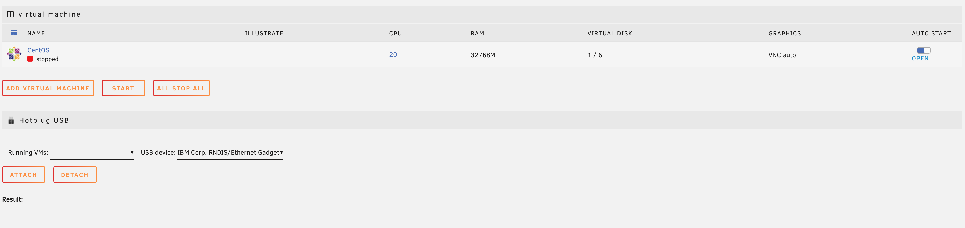

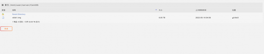

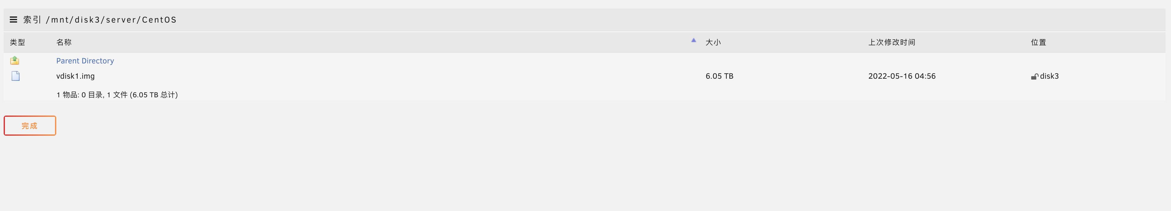

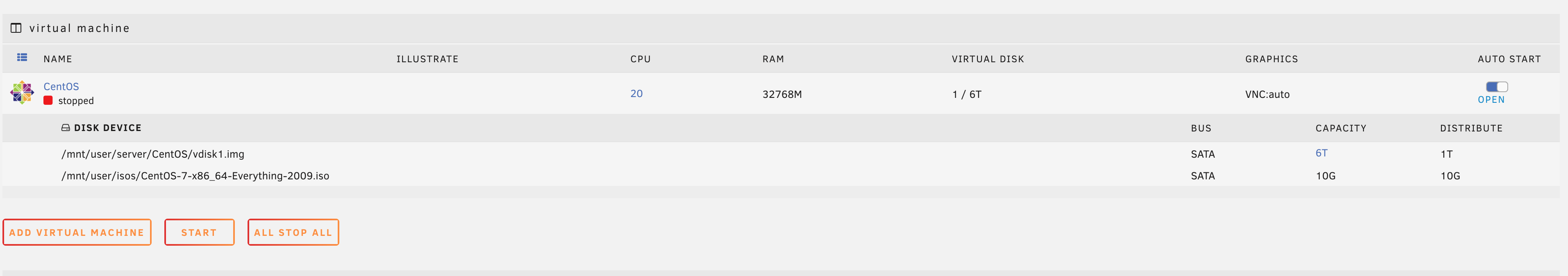

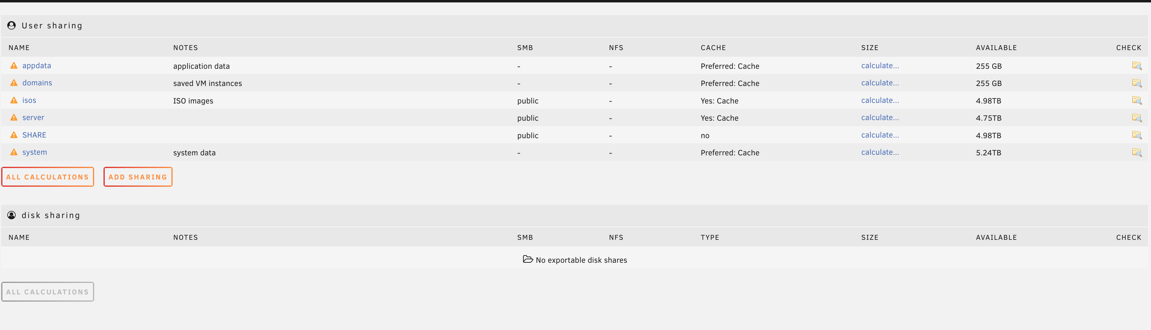

Have a Centos Vm in my Unraid Server, and give the Centos VM 5TB of share folder, and this share folder have DISK3,4,5,6(1.2TB each)
Now, the DISK3 is full with a single file, and the VM doesnot boot because not enough space.
What can i do

Unraid doesn't stripe data, so no file can be larger than a single disk, not sure how to fix the VM problem, likely you'll need to use some OS specific recovery tools.

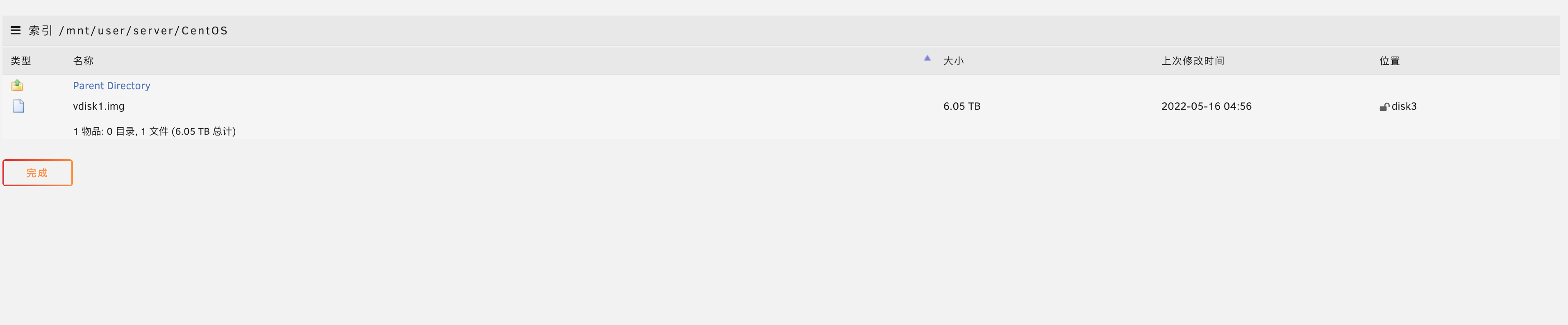

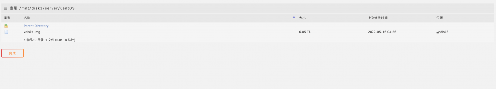

I can still copy the .img file, but it is just toooooo big, 6TB.
I need to buy a new disk that is larger than 6TB, so i want to find a way to fix it without spend any extra
You could temporarily get it running by removing disk5 and disk6 from the parity array, assign them to a new pool and rebalance to RAID0, when that is done you will have a pool with ~2.4TB of space. Copy the vdisk file to it with sparse always, then change the VM XML to point to the new location.
vdisk image files are sparse when created, so they only actually take up the room on disk that is used, but they appear to the VM as the full capacity. If you put more data in the vdisk than is available on the single array disk or pool, the VM will crash. Pools can be created with multiple volumes using BTRFS RAID levels, so you can create a larger contiguous space.
What I am describing is not easy to do, and if done incorrectly will result in the loss of your VM data. If it's important, I recommend making a backup first, which will require some space larger than 1.2TB, which is the current real size of the VM data. To copy it will require the use of tools that understand sparse files, and how to copy only the occupied parts of the file.
