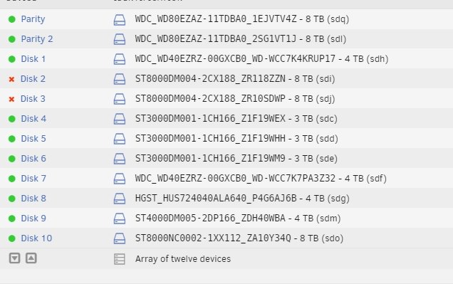

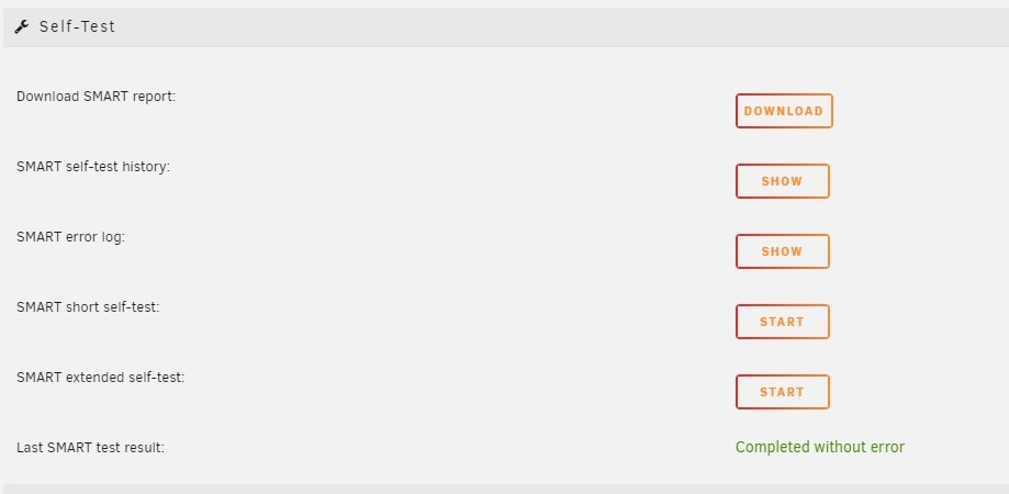

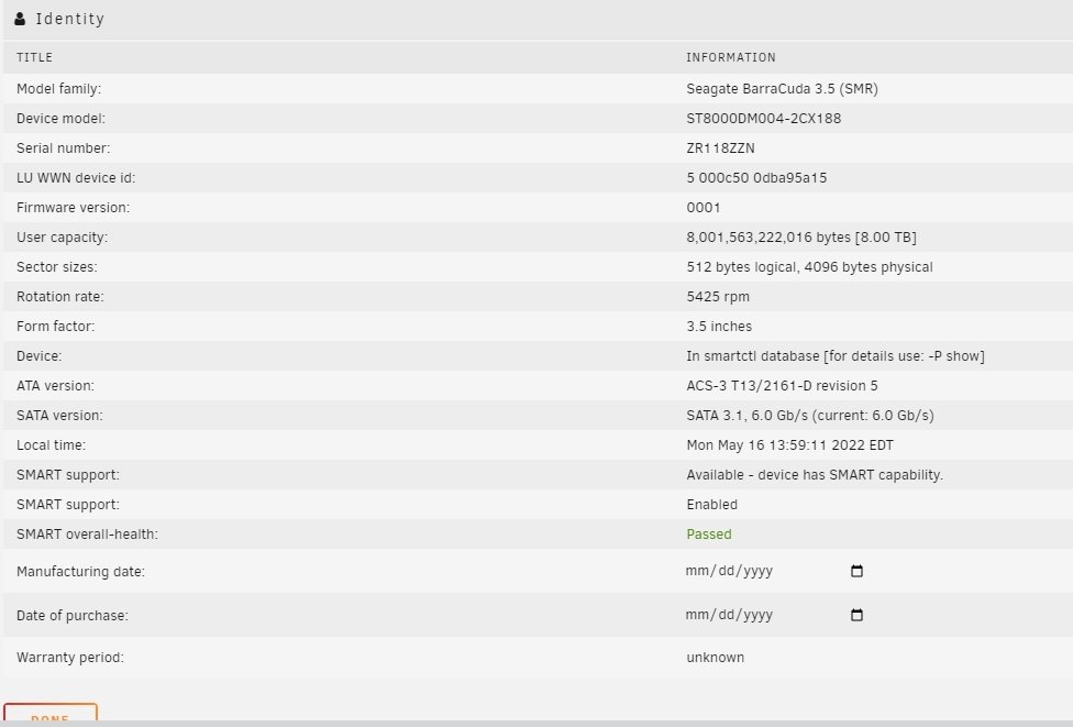

I added another drive to my machine. When I went to the UI to stop the array and to add the device, I saw that 2 of my devices are now showing as offline and contents being emulated. I restarted the server, no change. I checked all the cables and I don't see an issue with any of them. I started the array in maintenance mode, and ran a quick smartctl scan and an filesystem check on both the drives. they both passed and came back clear. But Unraid is still showing the drives as missing.

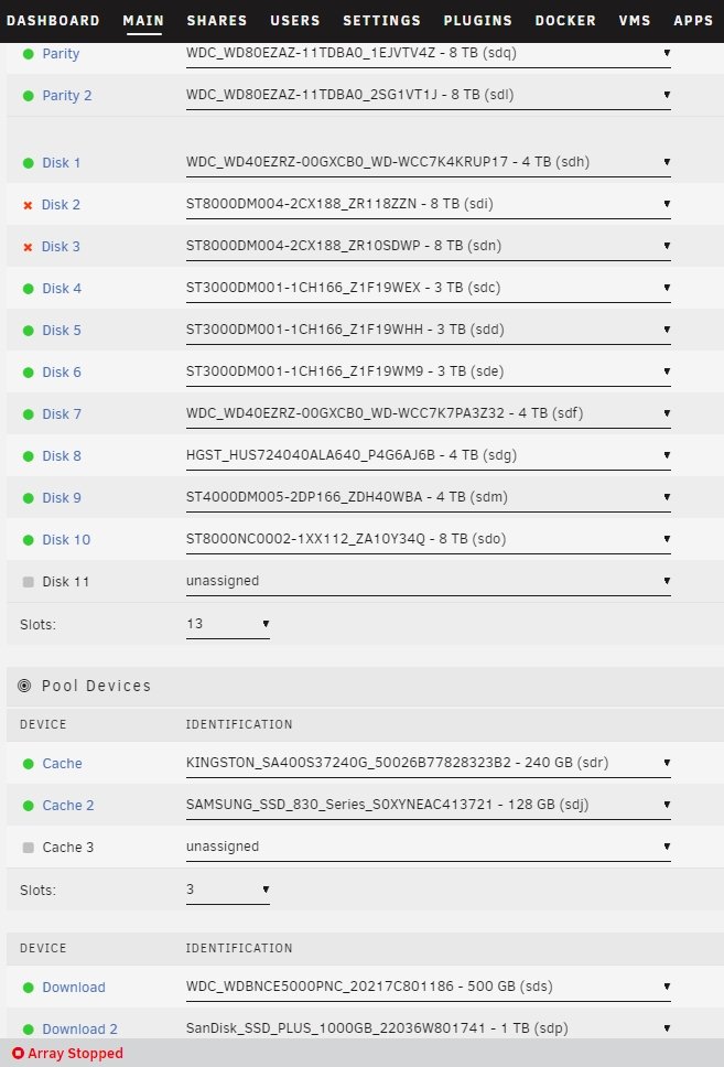

overview of all drives.
