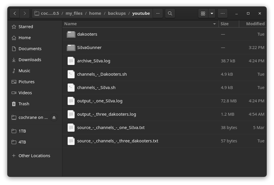

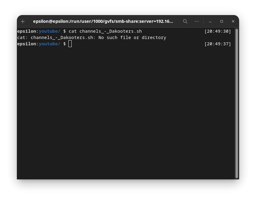

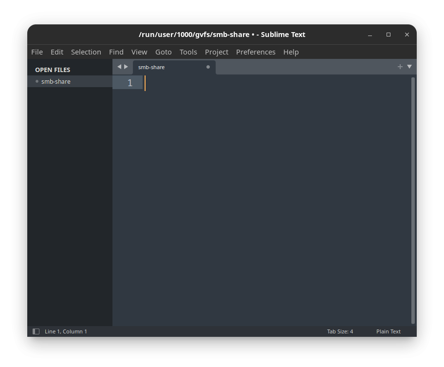

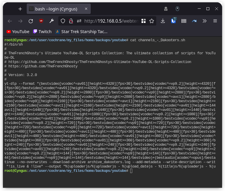

I have attached screenshots of one of the files effected [channels_-_Dakooters.sh] however its effects other as well  but not all of them. The first one is from my web browser on the unraid's web ui terminal. It shows that the file is there and has content. The next two are from my desktop (Manjaro) however these files have the exact same issue on my windows 11 machine. The terminal shows that the file cant be found even though in the forth screen shot the file is clearly there. The third one shows what happens when you open the file in a text editor. The second and third screen shot should show the information that the first one does since they are all the same file.
